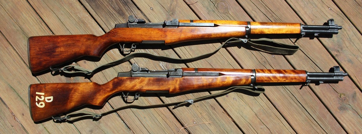

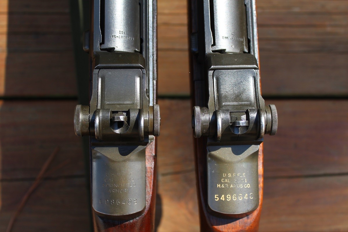

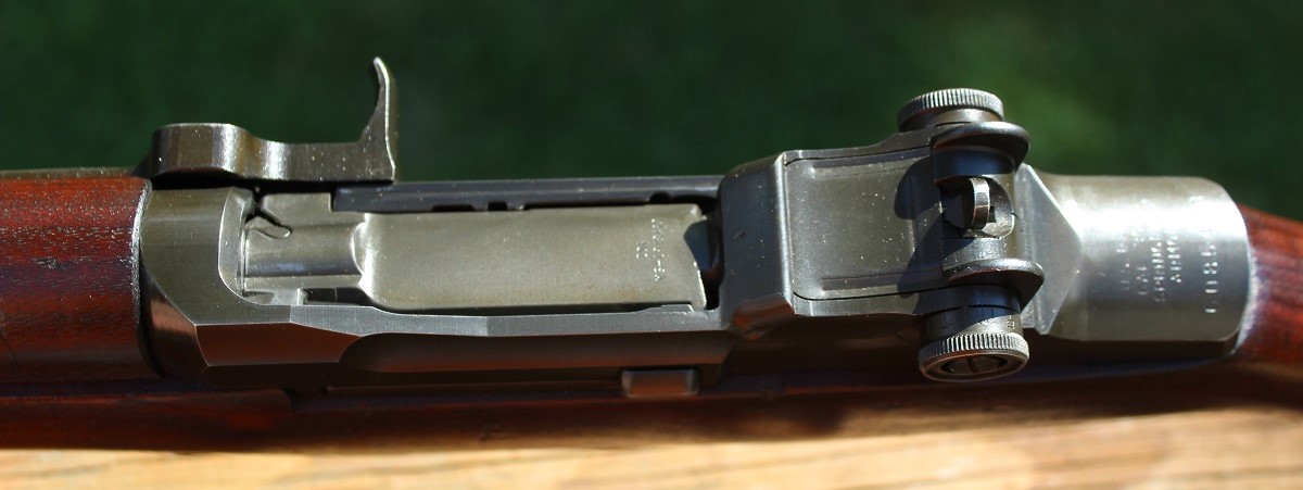

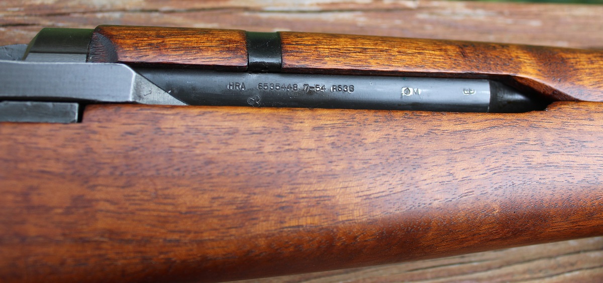

from my stash of Weapons of War! One is a Springfield in the 6 million range. The barrel is dated 4- 1956. All the parts are correct and appear to be the ones it left the factory with. The other M1 is a Harrington and Richardson with a 7-1954 barrel. It appears to be also correct, but I have misplaced my data sheets so I'm not 100% sure. Here a good resource to check out the parts on a M1: http://usriflecal30m1.com/Parts/PartsList.aspx

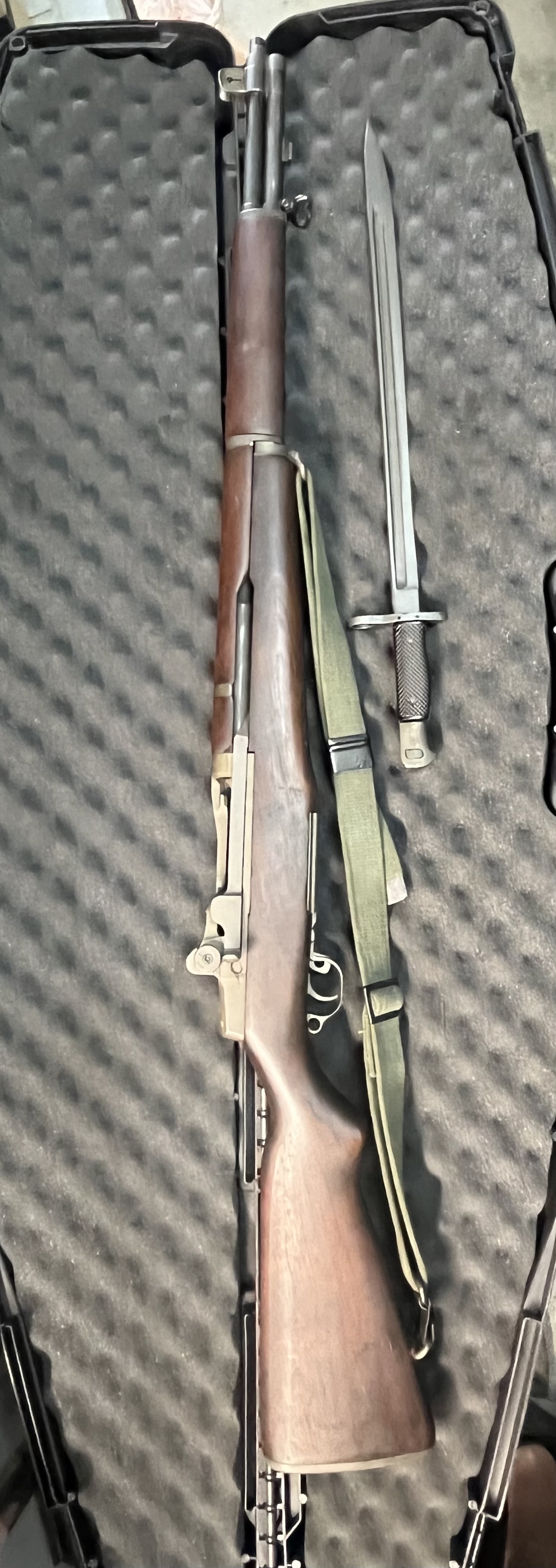

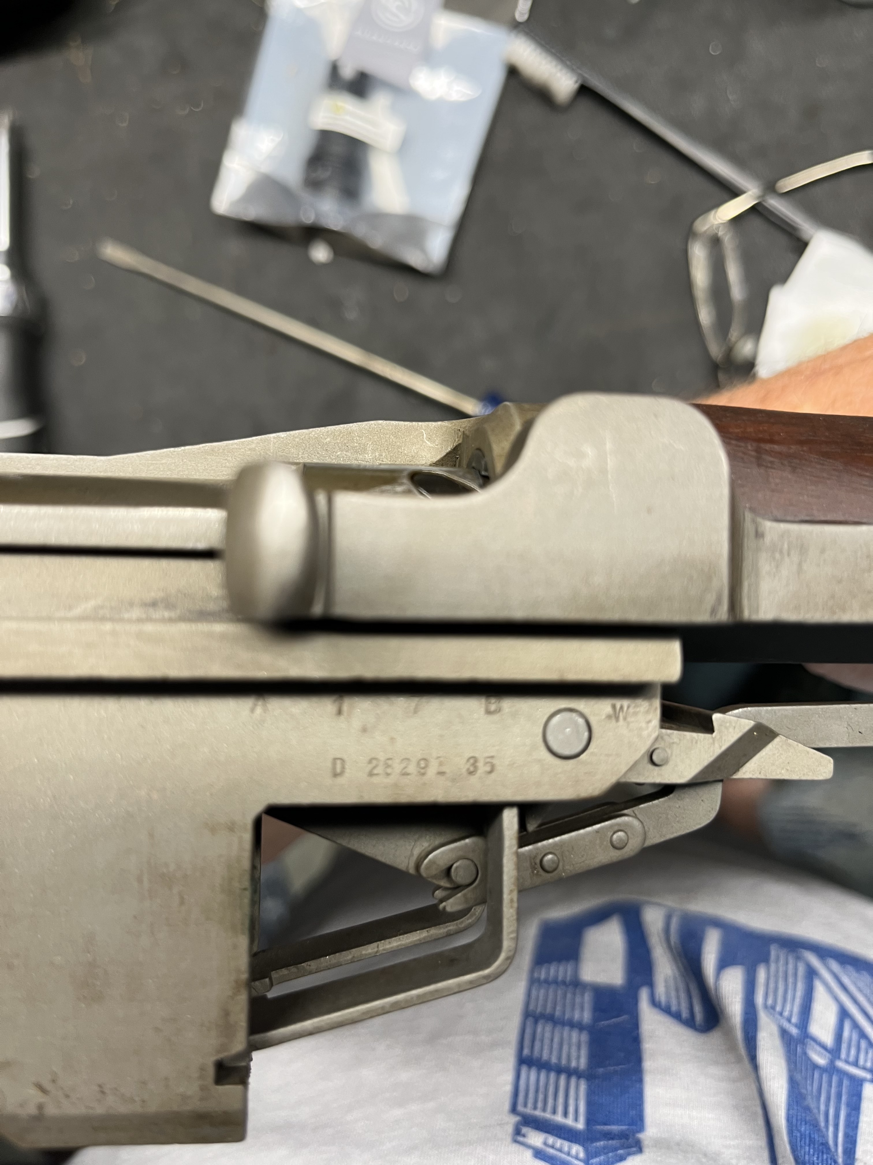

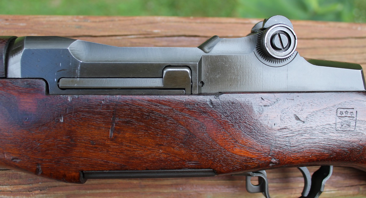

My M1 is a Springfield Nov 1944. 3,273,XXX serial#.
Thought it was Oct 44, but its serial is in the early range for Nov 1944

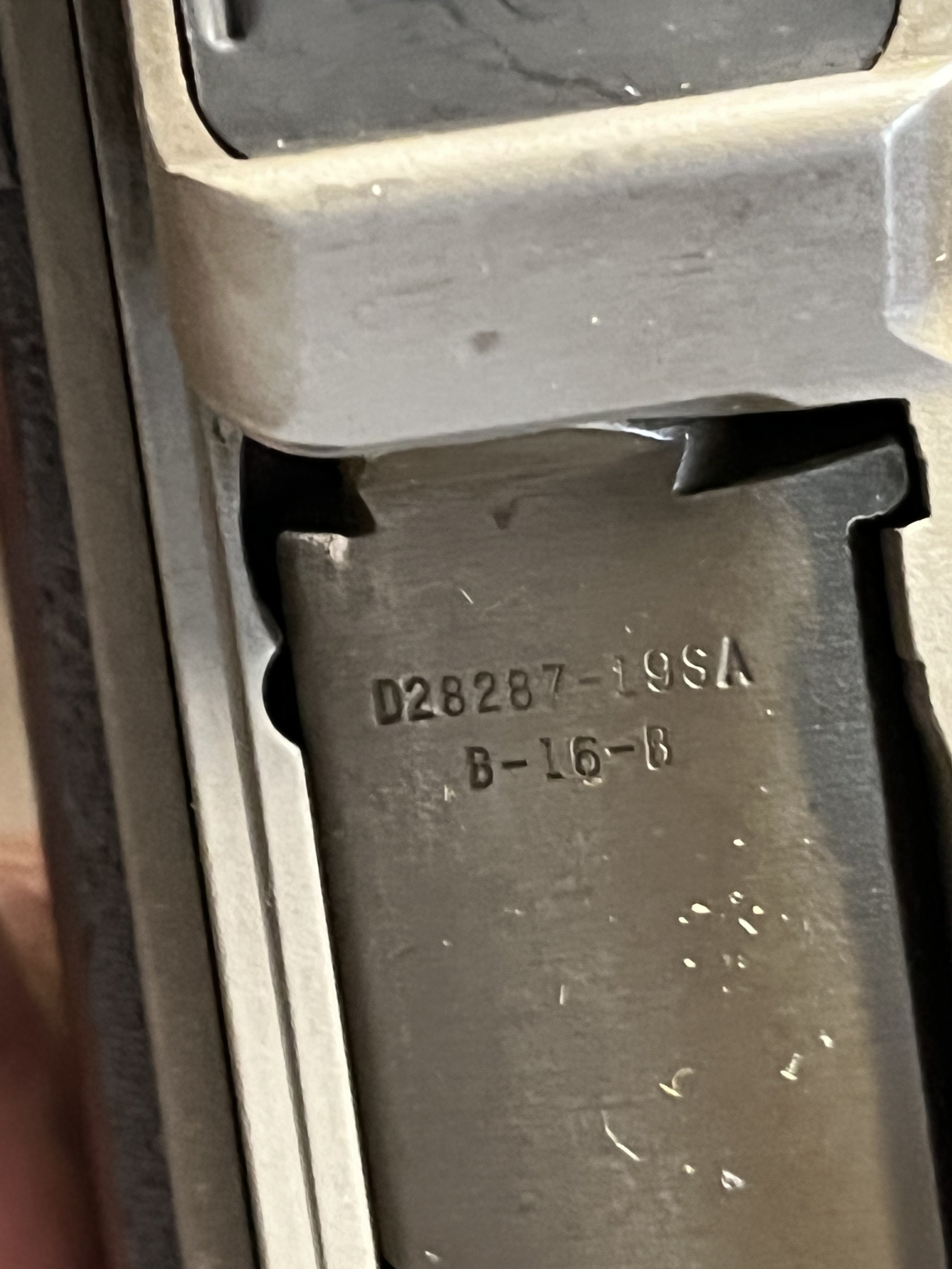

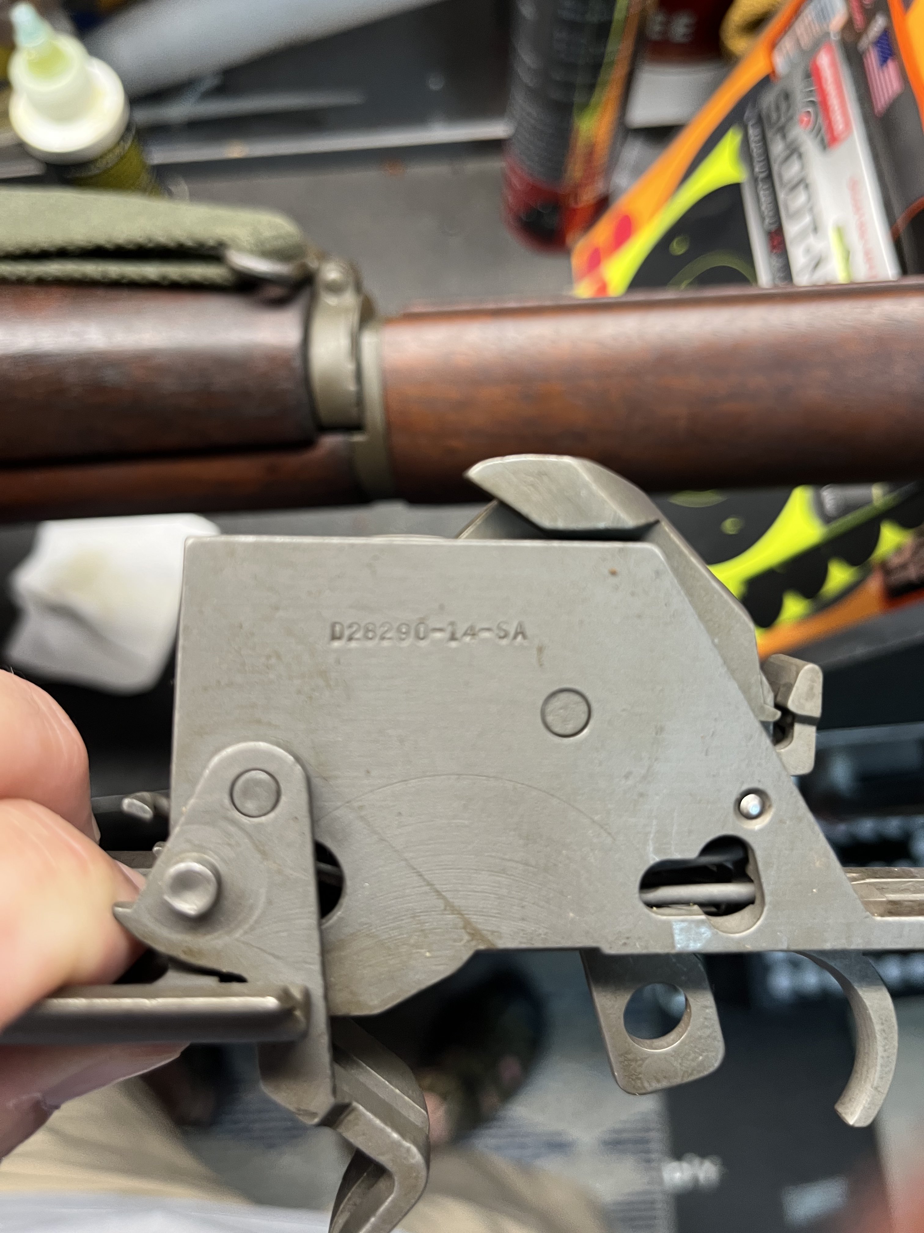

All matching serial numbers in the bolt, receiver and hammer match code dates for July ‘44 thru Jan ‘45 production codes from Springfield.
My link I posted is a reference for all codes on every part of an M1 garand regardless of maker.
All my codes are for the batch series of Nov 1944 rifles, down to the hammer.

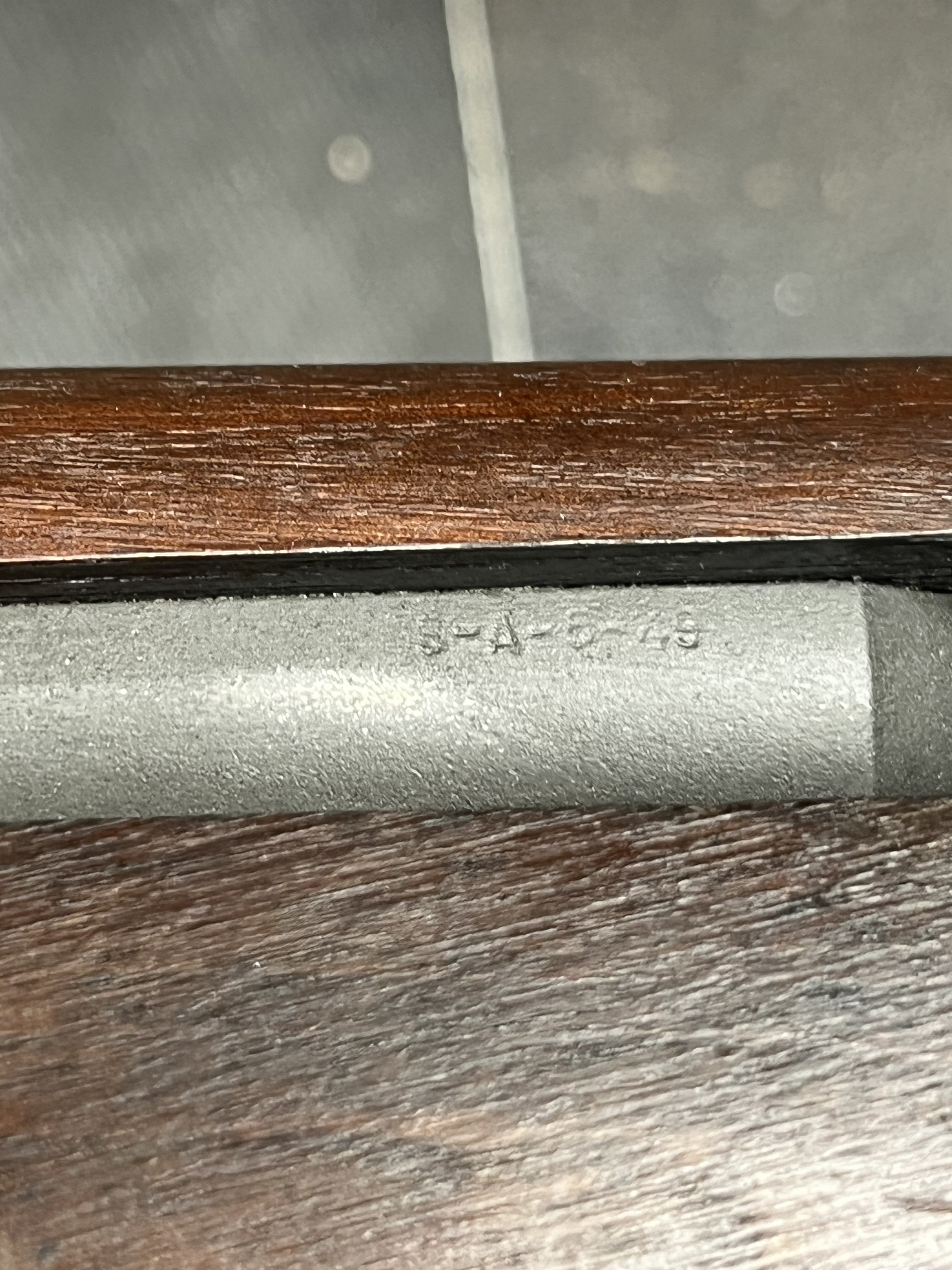

Barrel is dated May 1949 on a Depot level maintenance from Anniston Depot.
Appears only the barrel was changed , as all other codes match on all parts from 1944
As I just acquired mine, it has not had a oil rubbing or cleaning by me yet.
Soon to come.

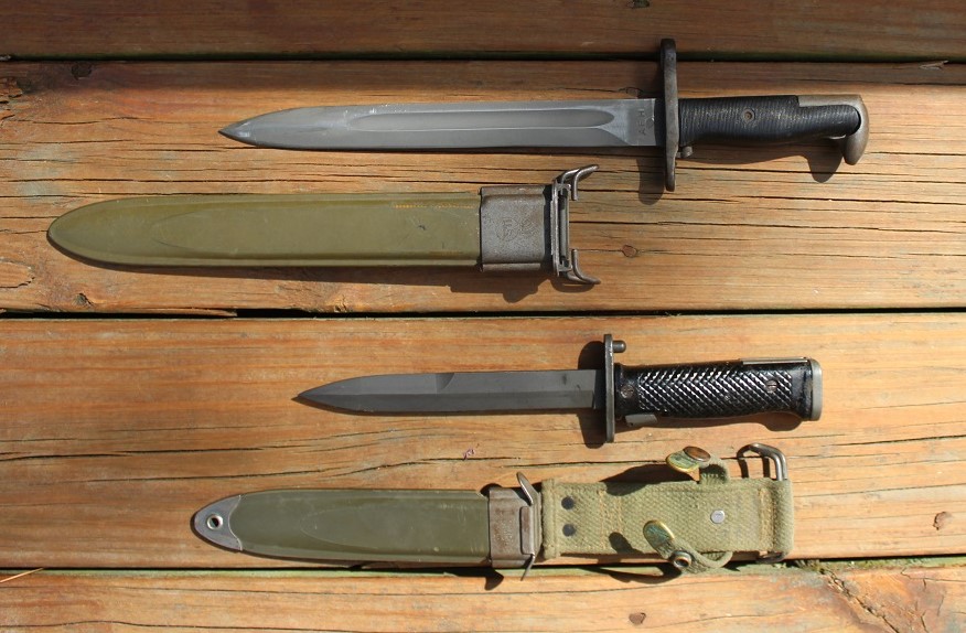

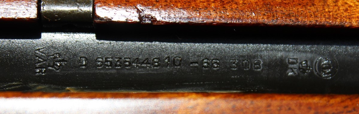

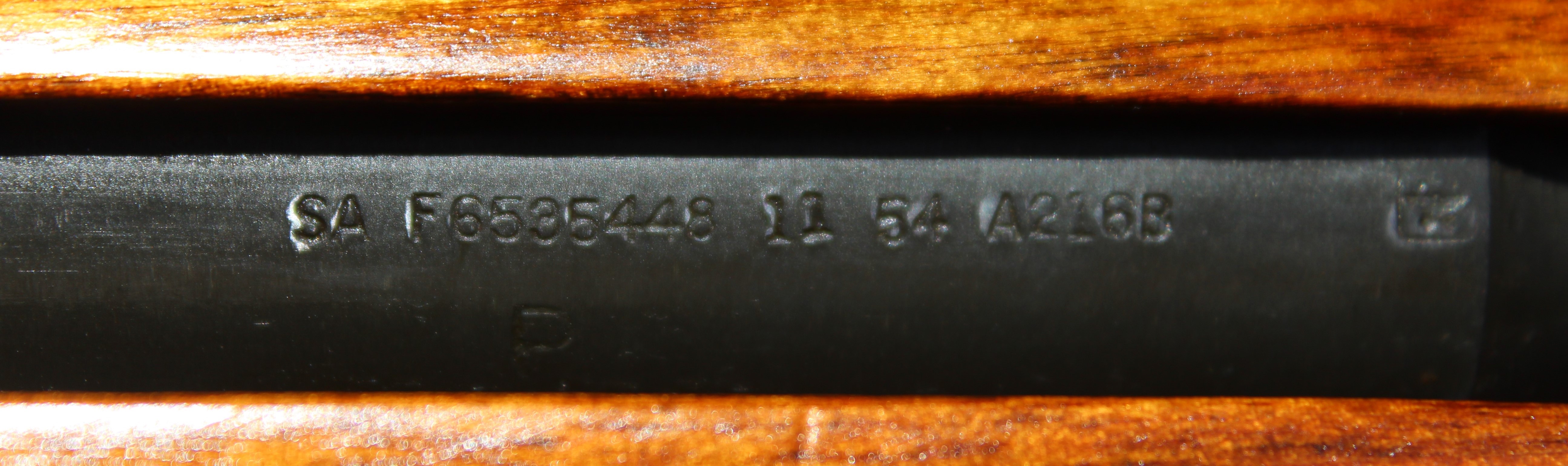

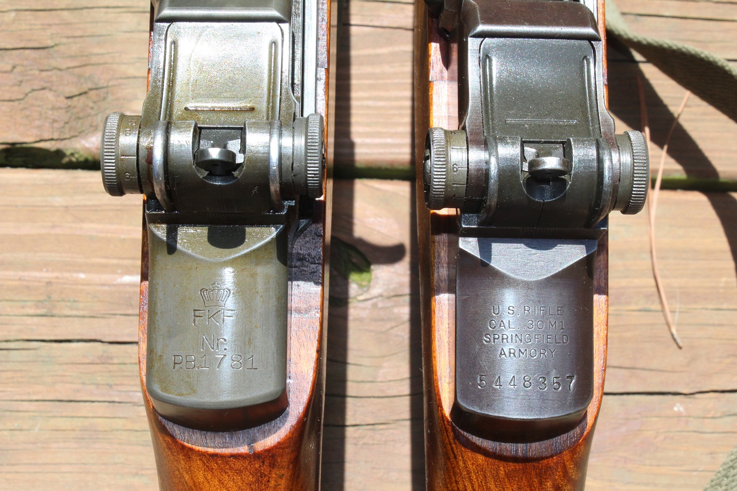

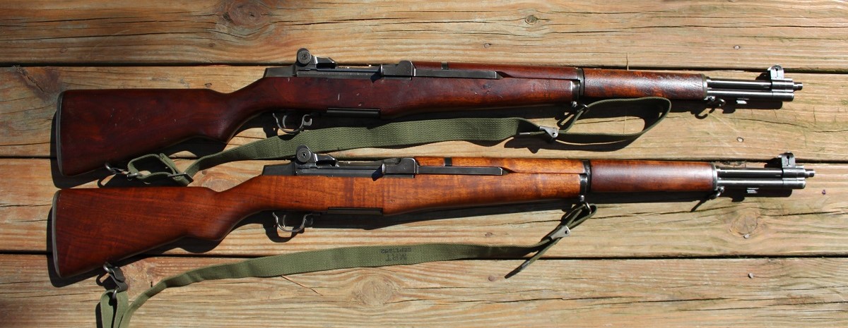

Please allow me to indulge some more. These are two babies that I didn't birth but I did build. I'm proud to say as a forum member that the 11-54 barrel in the Springfield I bought from Mr. Reese many years ago along with about a dozen others that all gauged new. I searched far and wide and found a stripped receiver in the correct serial number range that was right for a 11-54 barrel. It took me a while to find parts that matched in color and were not worn or refinished. The Beretta was a contract M1 for Denmark. Beretta was given Winchester's equipment to rearm NATO countries in about 1950. This M1 also started out as a receiver and was a project that took about 3 years to complete. It has a GI birch stock and a 10-66 Danish made (VAR) barrel. I could never find a decent PB made barrel and the VAR was the best choice. The other issue to overcome is that the Danes electric penciled serial numbers on bolt carriers. I didn't think this bolt carrier had a number on it when I ordered it off of ebay, but it did. However, it appears that the number on it is close to the number on the receiver. There are a few out there that are 100% correct, but they cost a small fortune. Both stocks were refinished and oiled many times. These are the ones that I shoot.

Functional, deadly and damn purty
