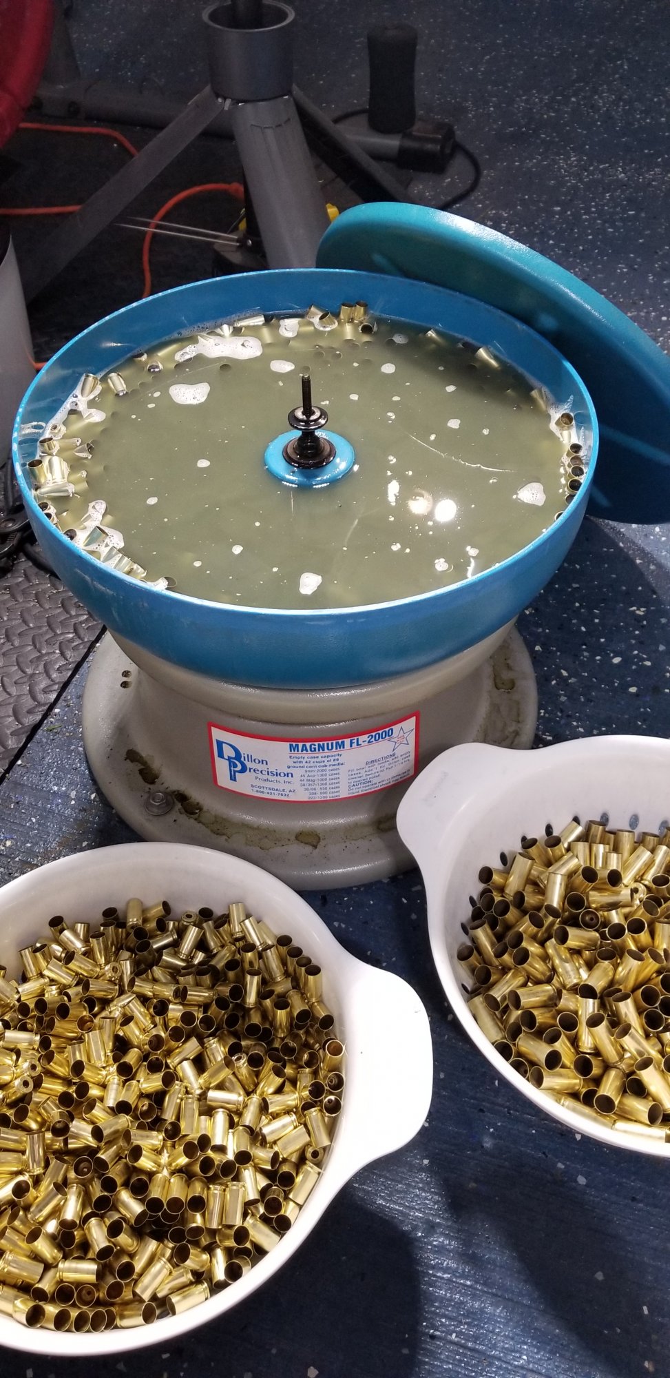

What did you use for media? Is this just brass, water, and dawn/lemishine? Or do you have pins or ceramic chips in as well?
Soups on......what.....TEXAS.....no bbq?........lol....I never used a wet system like this to clean my brass, I just used corn cob media, your results look good.
I used hot water and RCBS ultrasonic/rotary case cleaning solution, 40:1 mixture. I didn't want too pay for another cleaner, so I thought what the heck I'll try it another way! BBQ sauce was off the ingredients list. Sorry Annihilator maybe next time for you! Don't rinse was what sealed the deal for me on this decision. It works with room temp water also, but it takes longer. I had about 1,500 9mm cases in 1 batch and the 50ae was about 500. 160oz of water and 4oz of solution and no baking!
