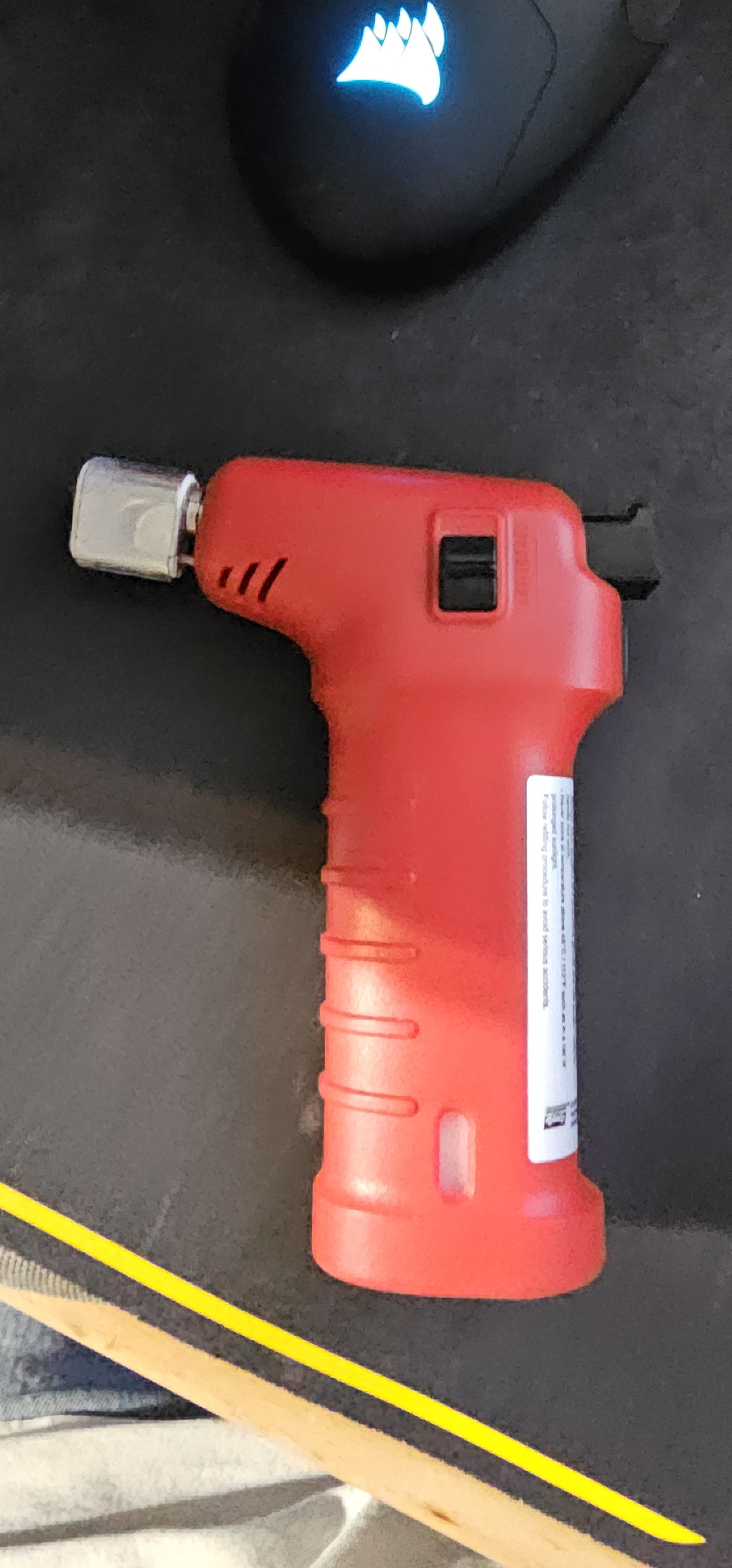

It's going to take a flame unless the heat gun is way hot (way more than 1,500 watts). This works very well (pic).
