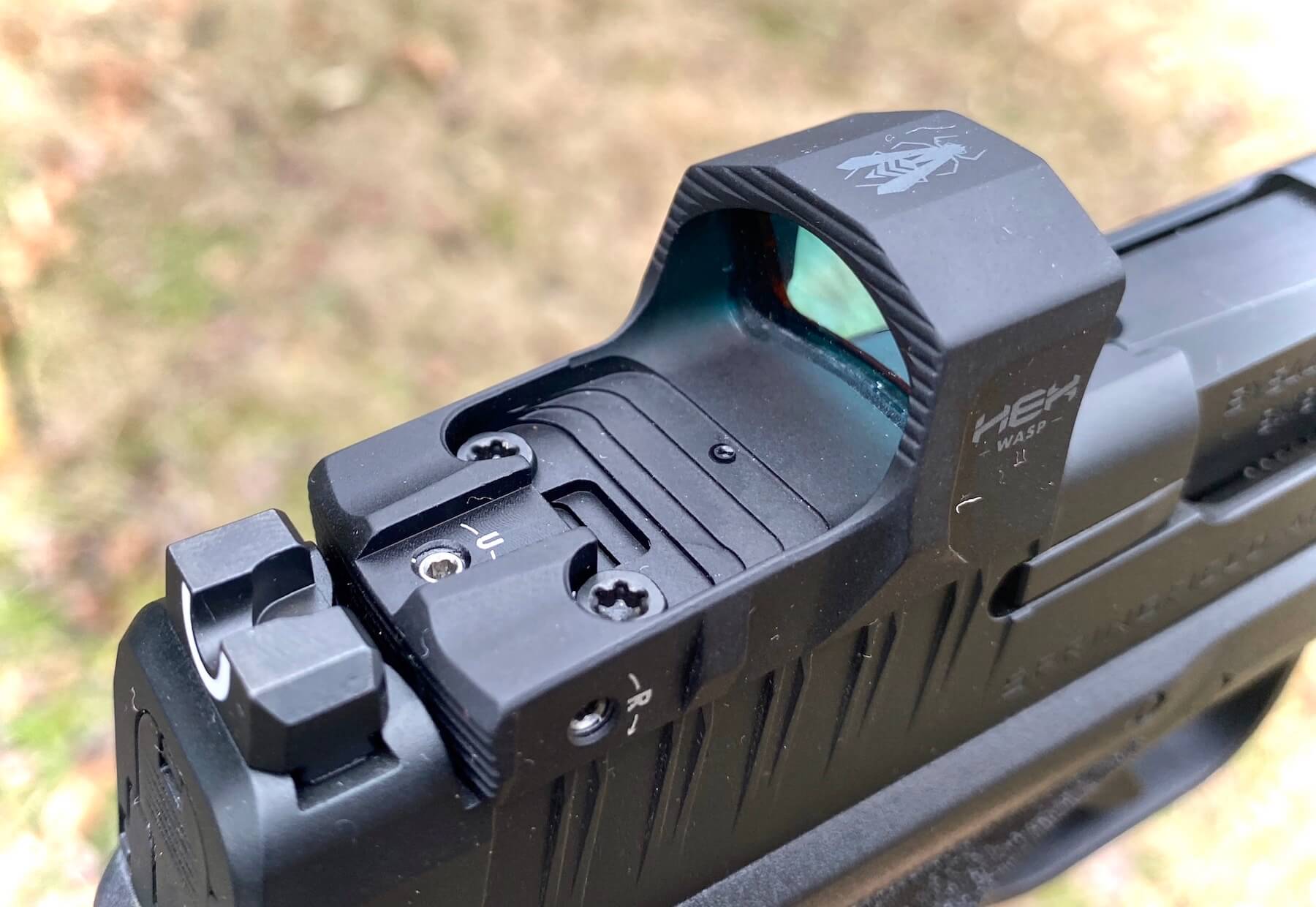

Chose the HEX Wasp for the construction differences. It's never had any issues on this end with daily use. Has glass lens verses plastic. Plastic in time can oxidize or fog over, is a common ailment inherent in some plastics. Imagine possibly polishing that dinky lens out in the future like headlight lenses? - Not me. Look at some older vehicle headlight lenses for example? Glass doesn't normally have that issue.
Same with housing. HEX Wasp uses aircraft grade aluminum verses Romeo Zero's polymer or plastic housing. Both can be very durable and less maintenance if and when possibly needed. Some is a balancing act on variables. Some isn't, battery placement sounds to be about the same.
With plastics, sometimes is anyone's guess down the road possibly effecting durability or care? More natural products like aluminum and glass tend to be more stable and likely more biodegradable or recyclable too.
Regardless, am thinking both are likely very good choices for the here and now though. HEX Wasp was a personal choice in this direction by what known. It hasn't let me down. There are some other differences noted in reviews listed below. Good luck with either you may choose.

Just that it sits higher and you can’t use the regular sights as back up if need be. The wasp sits lower with notches in the back for lining up sights.

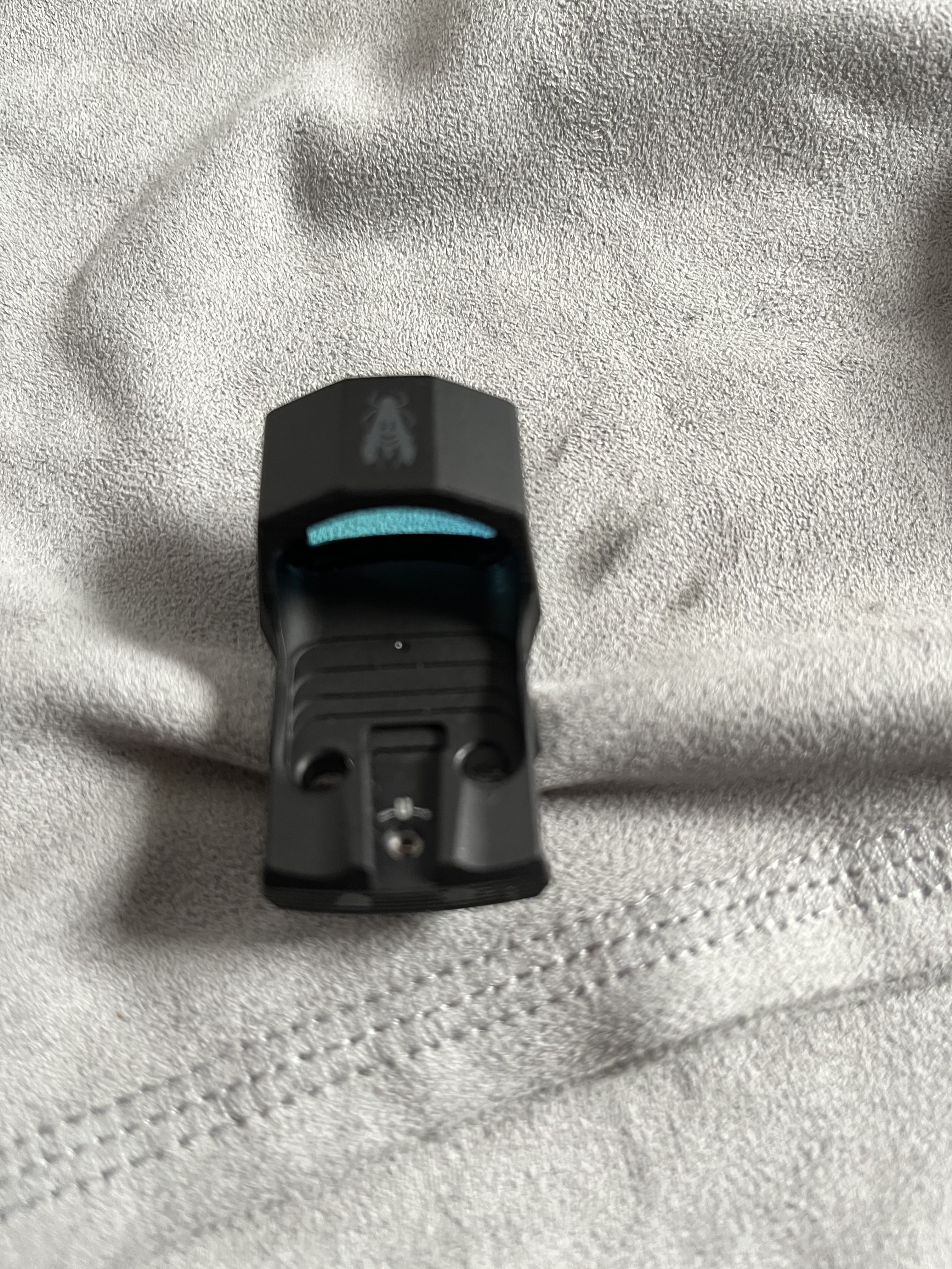

I dont have an XDM Elite, but you would think you would get some co witness with out suppress height sights. Wasp picture attached With rear sight notches.
Read HEX Wasp and Dragonfly are different footprints. To cowitness you likely should get all MFG's footprint and thickness specs before ordering to help ensure cowitness and proper fit. Foot pound specs for adapter may be different than optics too. Also remember to check for proper screw length with and w/o adapter to avoid possible malfunctions. Too long or short of screws could lead to issues.
Good advice. But I already own both plates for the dragonfly and wasp. So that’s no issue there. But yes maybe I should look up the MFG specs and gauge the plate thickness and gauge my sight heights as well.
