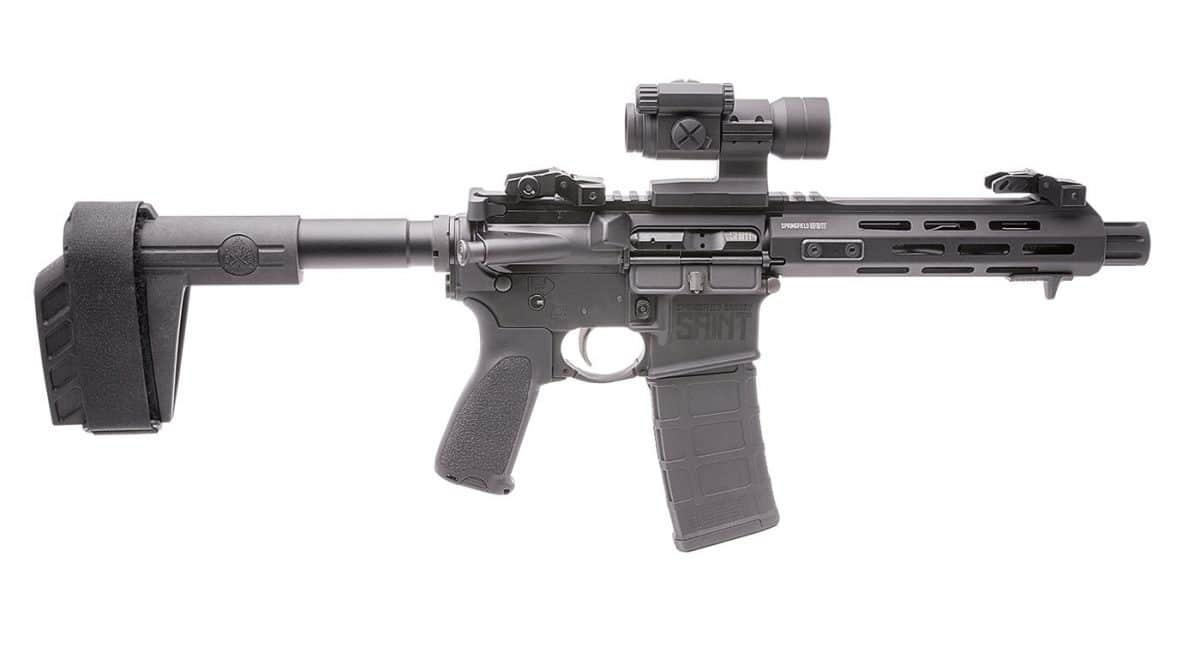

Available in 5.56x45mm or .300 BLK—with 7.5 an 9-inch barrel-length’s respectively—our 5.56mm test gun measured a handy 26.5-inches in overall length and 5.5-lbs. in weight. Springfield ships the Saint Pistol with a very nice and size-appropriate padded cordura soft case.
While the SBR has a consistent following, the AR pistol has taken that market by storm. Initially a bit of a novelty, adding a stabilizing brace made them moderately useful. Improved brace designs have helped, each year they get better and more user friendly, almost practical. Given the ATF’s latest “open letter” removing the threat of becoming a felon for shouldering them has proven to be a game changer. Increased demand has produced better made, more reliable and shorter versions, 7 to 8 inches being the norm. Pretty much everyone is getting into this market, including Springfield Armory. Their Saint AR-15 is available chambered in 5.56mm or 300 BLK, and it is a great pistol.
Springfield Armory Saint AR-15 Pistol 5.56mm
Springfield Armory starts with forged 7075-T6 aluminum receivers using their Accutite tensioning system. A patented M-LOK hand guard using locking tabs and a hand stop covers a 7.5 inch, 419R stainless steel barrel coated in Melonite. Using a 1:7 twist it is capped with a blast diverter that sends blast and flash forward. Its direct impingement gas system uses a pistol-length gas tube and pinned low profile gas block. The bolt carrier group is an enhanced M16 design with an magnetic particle tested bolt and coated in Melonite. The lower receiver houses a Springfield Armory Nickel Boron coated Mil-Spec trigger with a single sided safety. Bravo Company’s Mod 3 pistol grip is used along with their extended trigger guard. AN SB Tactical SBX-K stabilizing brace is installed along with a QD equipped buffer tube ring. All is shipped in a Springfield Armory embroidered Soft AR-15 pistol case with one magazine.
Saint Pistols are fitted with SB Tactical’s SBK-K forearm brace, allowing this short-barreled AR to be classified as a pistol. Riding within the buffer tube is a carbine H heavy tungsten buffer.
Aimpoint’s RDS Carbine Optic was used. It remains one of the best top-tier red dot sights for the money. Designed specifically for use on modern sporting rifles, it includes a simple mount and a 2 MOA dot. Ten brightness settings allow for use in most any lighting conditions, and it includes a bright setting for daylight. Battery life extends to over a year using one DL1/3N or 2L76 battery. Water, shock and vibration resistant, it is designed for use in most any conditions. Springfield Armory’s flip-up BUIS (back-up iron sights) co-witness in the bottom third of the Aimpoint.

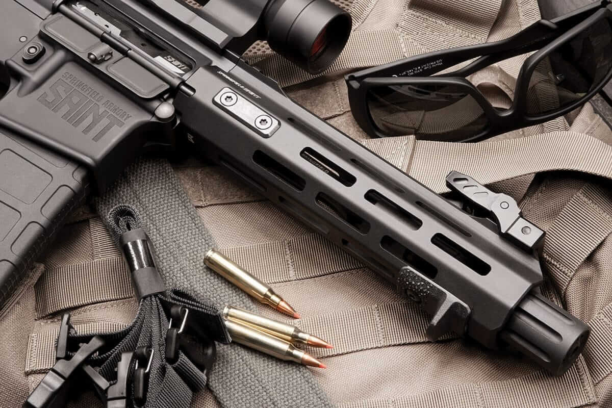

The Saint’s aluminum, free-floating M-LOK-equipped handguard measures 8-inches in length and ships with a pre-installed hand stop. Back-up iron sights are not included. Underneath the handguard is a 7.5-inch, Melonite-coated 416R stainless-steel barrel, and attached to its muzzle, a blast diffuser to help direct noise and concussion forward and away from the shooter.

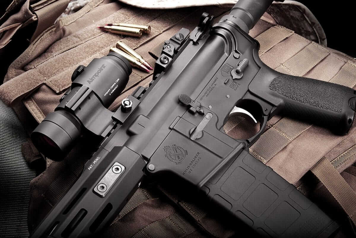

A standard Mil-Spec bolt catch and safety selector can be found in their normal locations. Bravo Company Gunfighter pistol grip and trigger guard and Nickel Boron coated trigger group are factory equipment. Aimpoint’s Carbine Optic—specifically designed with the AR platform in mind—was used throughout testing.

An Accutite tension system eliminates the play between the Saint’s forged, Type III hard-coat-anodized upper and lower receivers. Fire/safe icons on the right side of the lower offer a quick visual of the rifle’s condition. The pistol ships with one Magpul 30-round magazine.

Specifications
Caliber: 5.56mm NATO
Receiver: Forged 7075-T6
Barrel: 7.5 inches
Overall Length: 26.5 inches
Weight: 5.5 pounds
Sights: Top Rail
Brace/Grip: SB Tactical Brace / Bravo Company Grip
Action: Semi-Automatic, direct gas impingement
Finish: Black
Capacity: Accepts AR-15 based magazines
