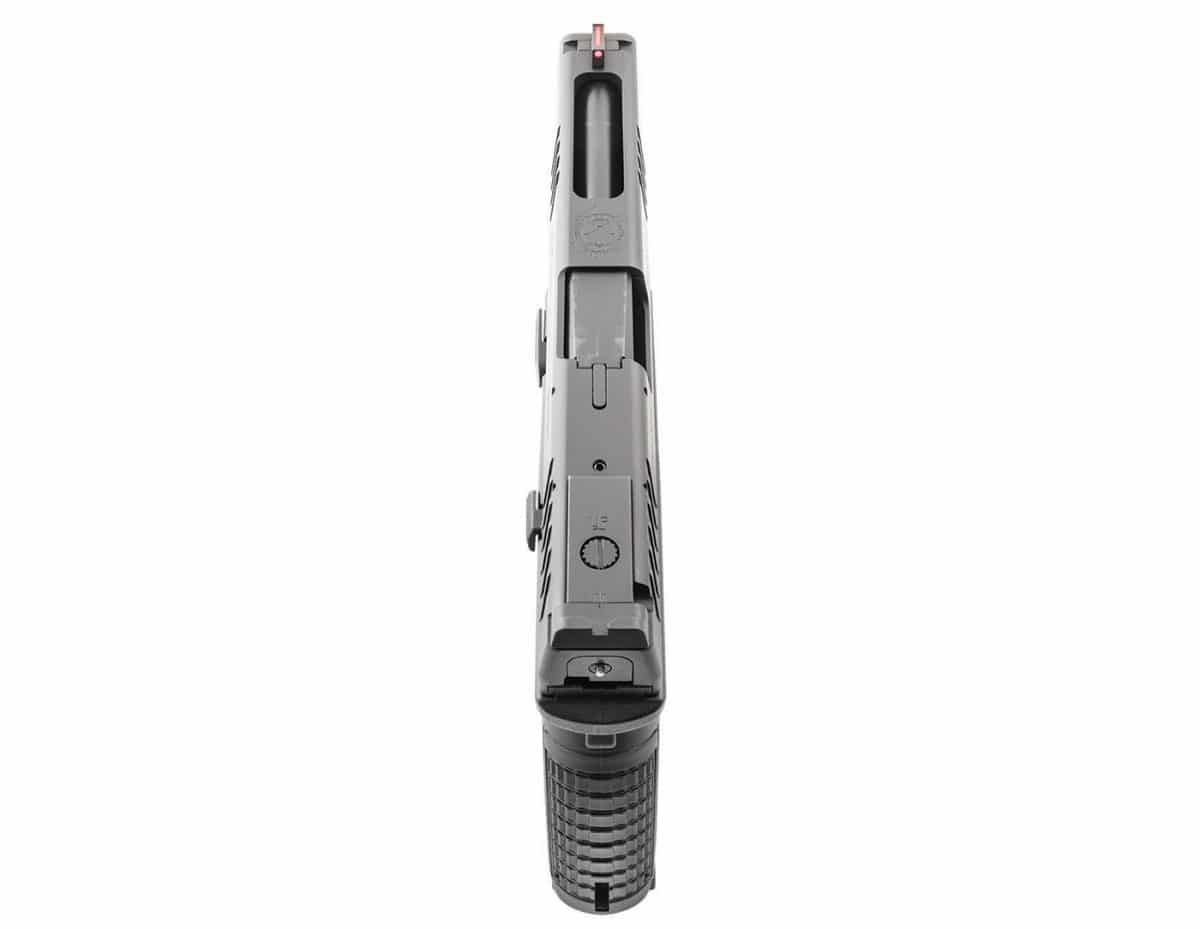

With its 5.25-inch barreled, long-slide configuration, the XD-M 10mm affords a 7.5″ sight radius, and the pistol comes with an adjustable rear sight and fiber optic front. The longer barrel enhances the velocity and power that are the 10mm cartridge’s real raison d’etre, and the adjustable sight allows the shooter to dial in point of aim/point of impact for the very broad power range which today’s array of available 10mm loads affords. A 15-round magazine and one in the chamber gives you 16 chances instead of a revolver’s six if you have to defend against a wild animal attack.

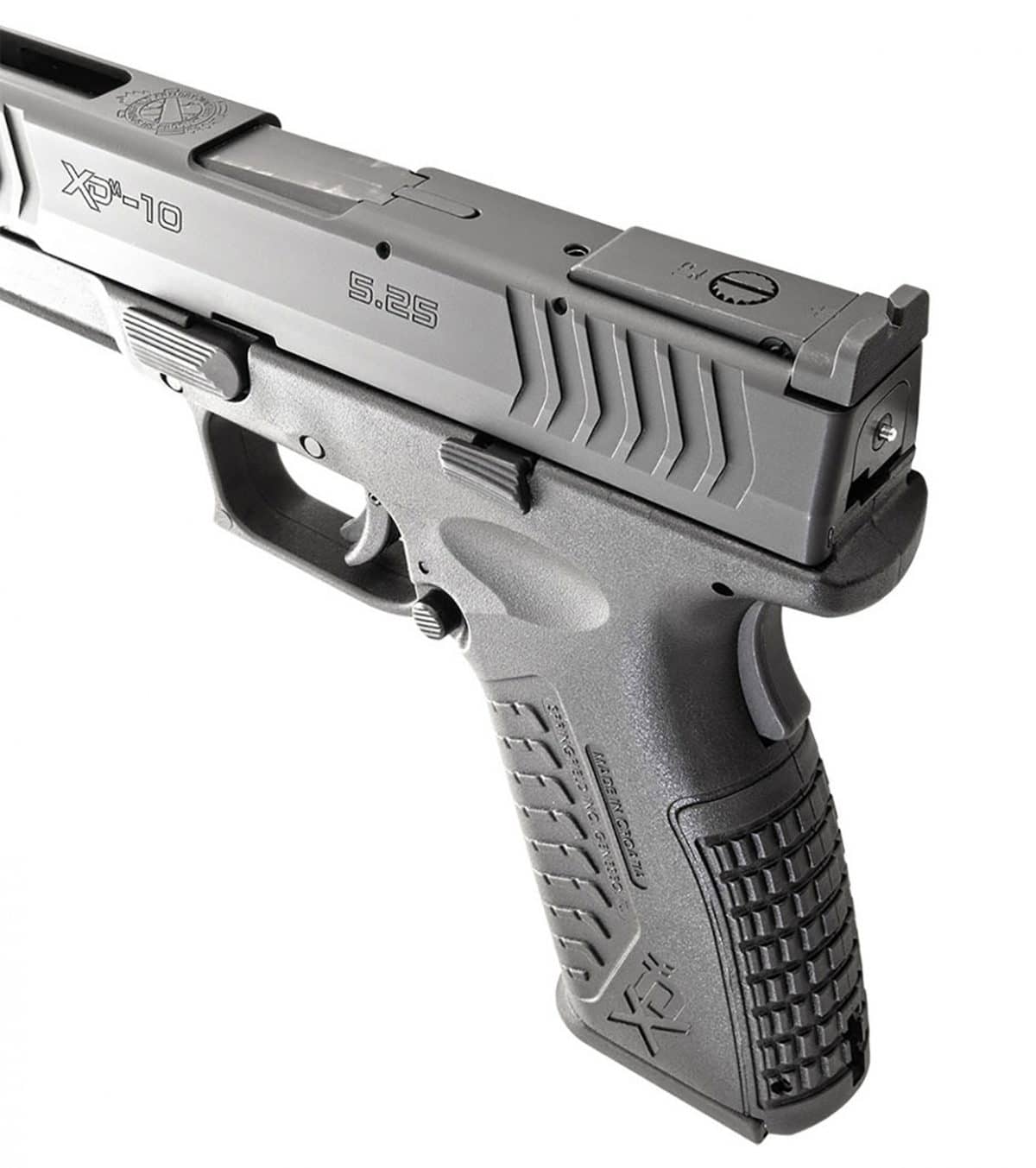

Manipulating the XD-M’s large, serrated magazine release, slide stop and takedown lever has always been exceedingly intuitive, and that hasn’t changed on the new 10mm version. The pistol’s tactile cocking indicator can be seen here protruding out of the striker plate at the rear of the slide.

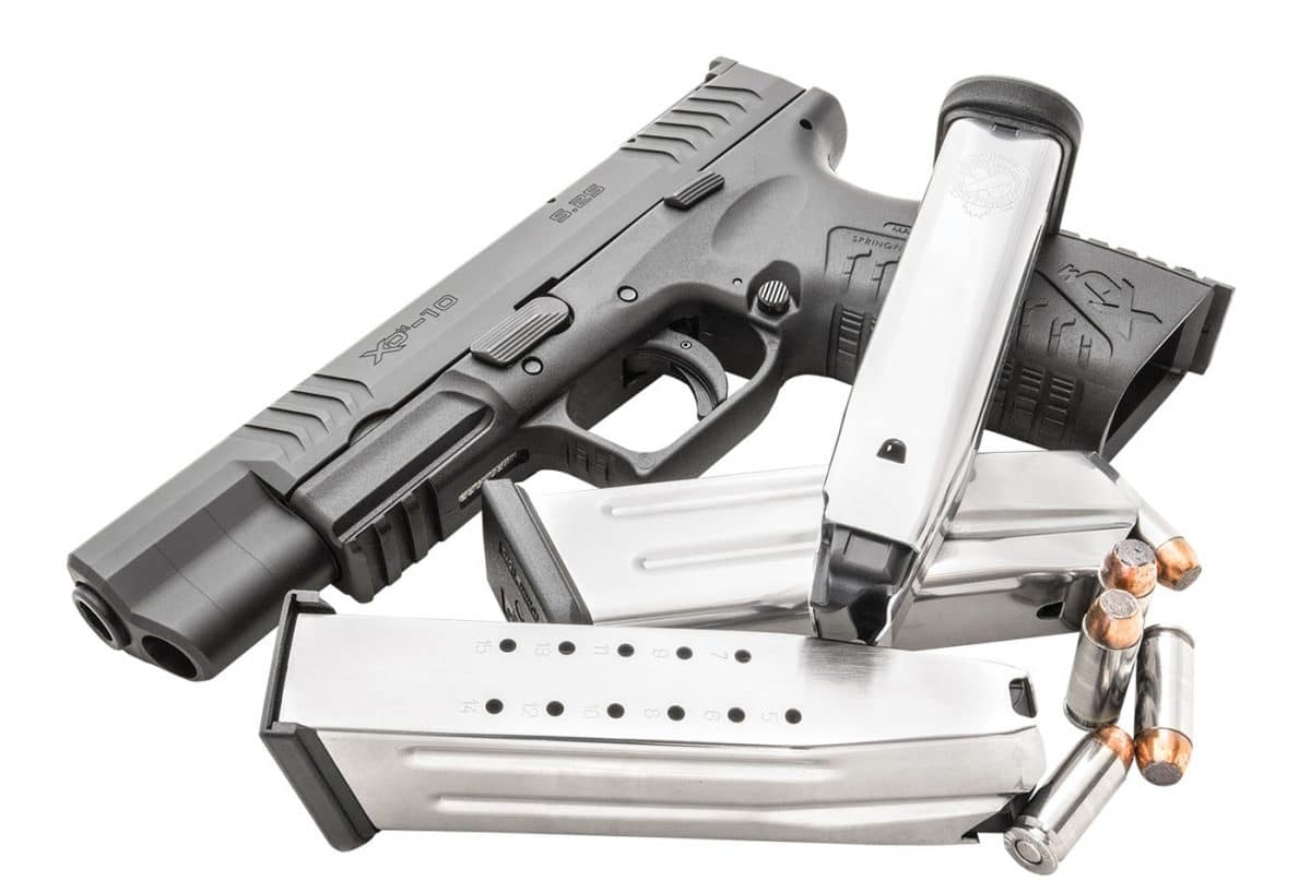

The XD-M 10mm ships with three easy-loading and reliable stainless-steel 15-round magazines. The magazine well is moderately beveled to help facilitate expedient reloads.

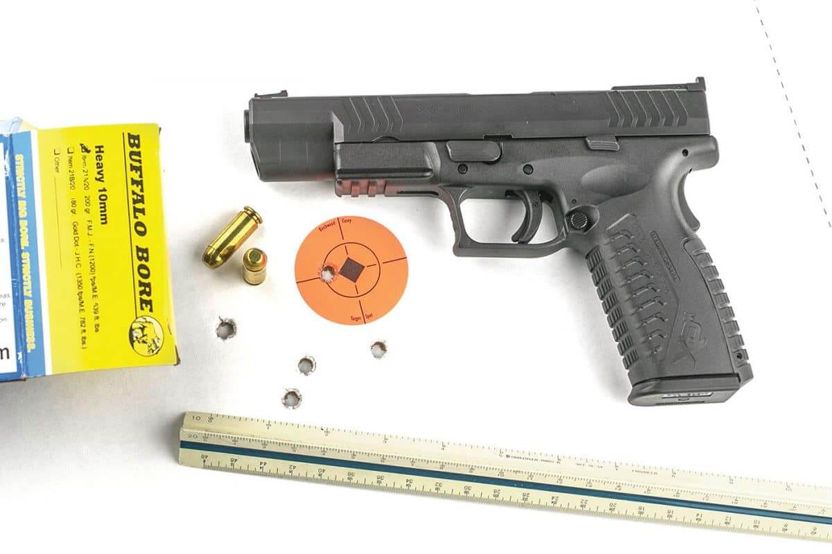

On Target’s test gun preferred the hot, 200-grain Buffalo Bore Heavy load during testing, printing the 2.65-inch, five-shot group at 25-yards.
Bear Protection: Buffalo Bore “Heavy” 200-grain Full Metal Jacket. There are heavier bullets of hard cast lead with wide noses available for 10mm, but there have been reports of some of them failing to feed in polymer 10mms, so erring on the side of caution I went with this reliably-feeding FMJ load for those who might need to ruin a bruin. The five-shot group was a best of test at 2.65″, and the best three formed a group in 1.70″: ample for the brain area of a charging brown bear, with fifteen make-up shots on tap (if you have time).
