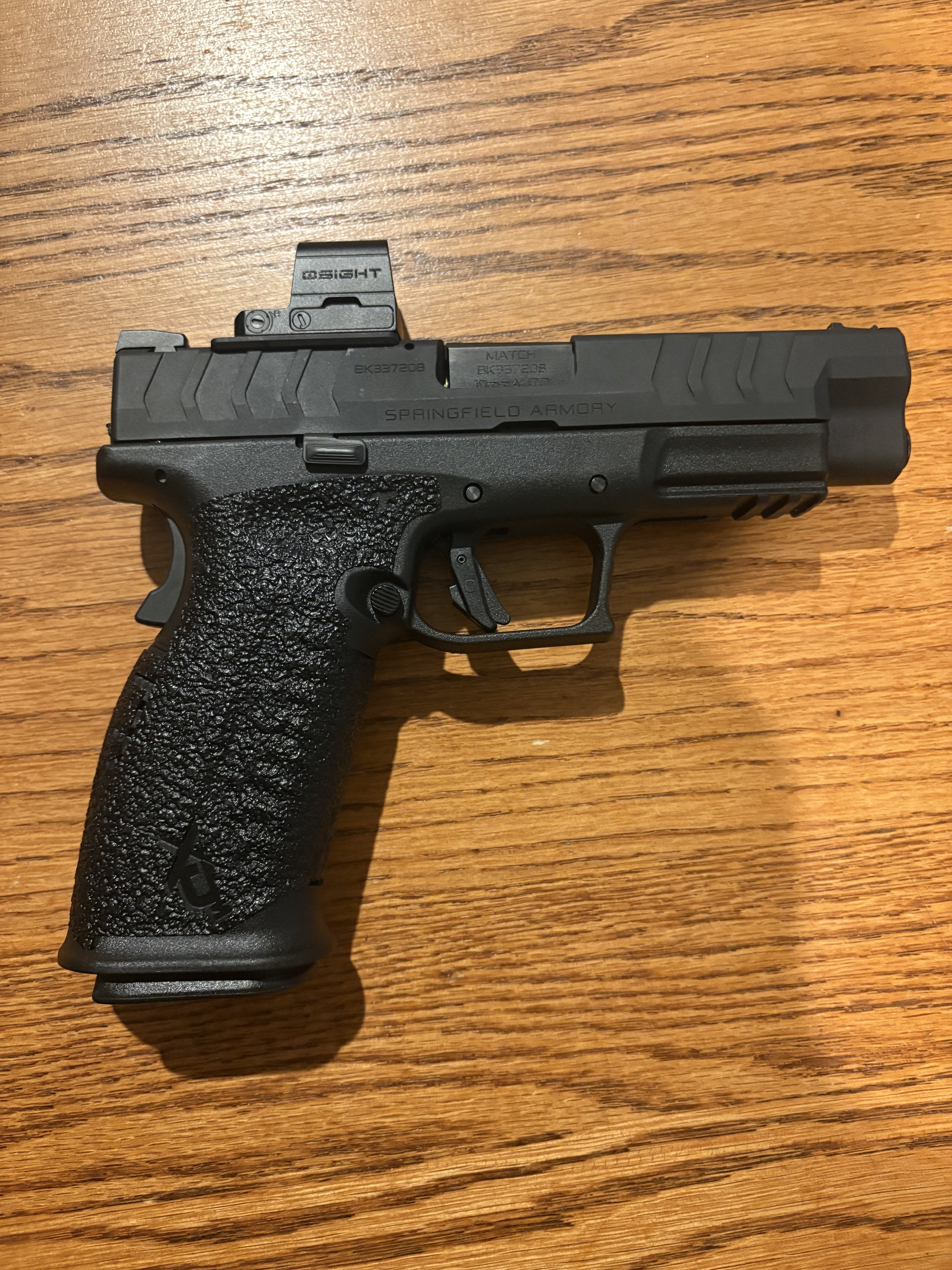

Well, they didn’t do what I bought them for but I still love them😁. Here is the official XDM Elite bear backup pistol with Osight SE and Talon grip
