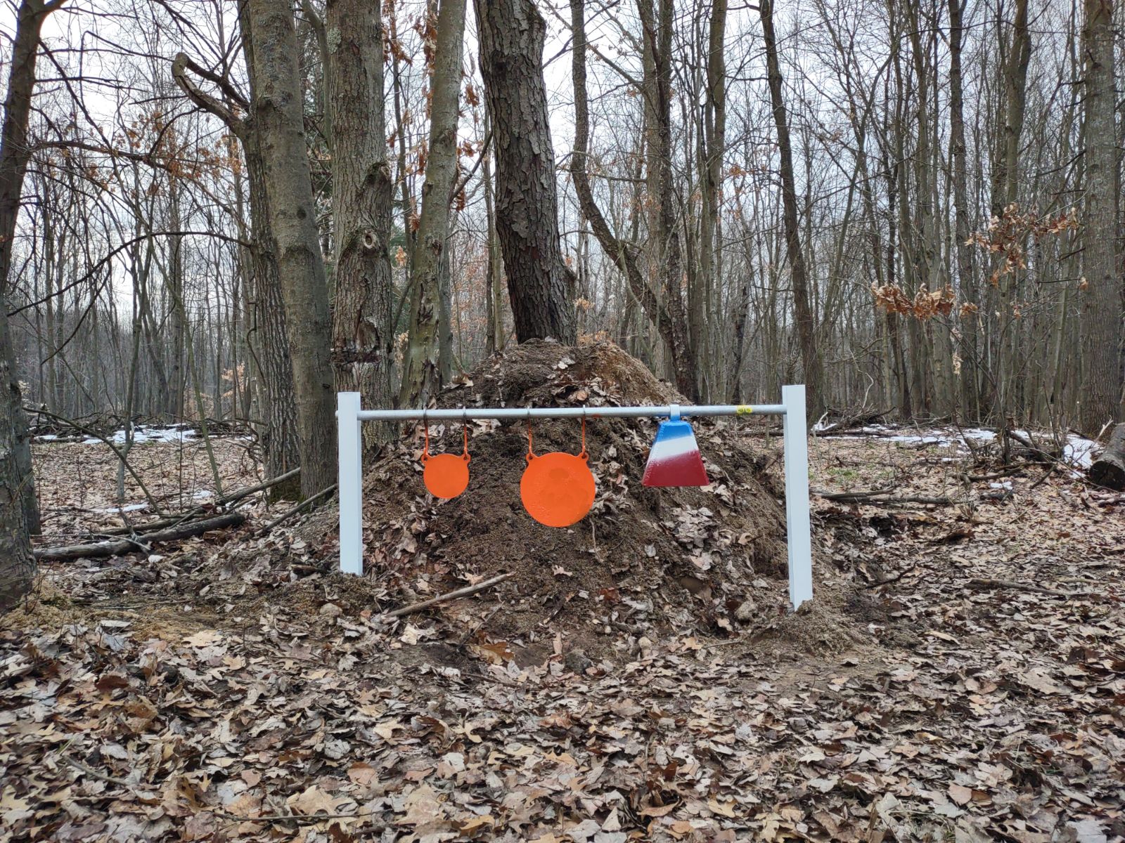

After shooting the cowbell gong at 250 yards, I decided to revamp it so I could have multiple gongs hung instead of just one. I took advantage of the warm weather and the fact that we didn't have frozen ground here in February.
I cut a 3" I Beam at 60" for the uprights and drilled a 1.375" hole in them to accommodate the 1" x 60" pipe that would be the cross member. Both end were threaded to receive end caps.
Used a post hole digger to get down 25-26" to plant the I Beams. Squared up everything and back filled the holes with dirt. Hung 6", 10" and the Liberty cowbell gongs. I think it turned out ok.

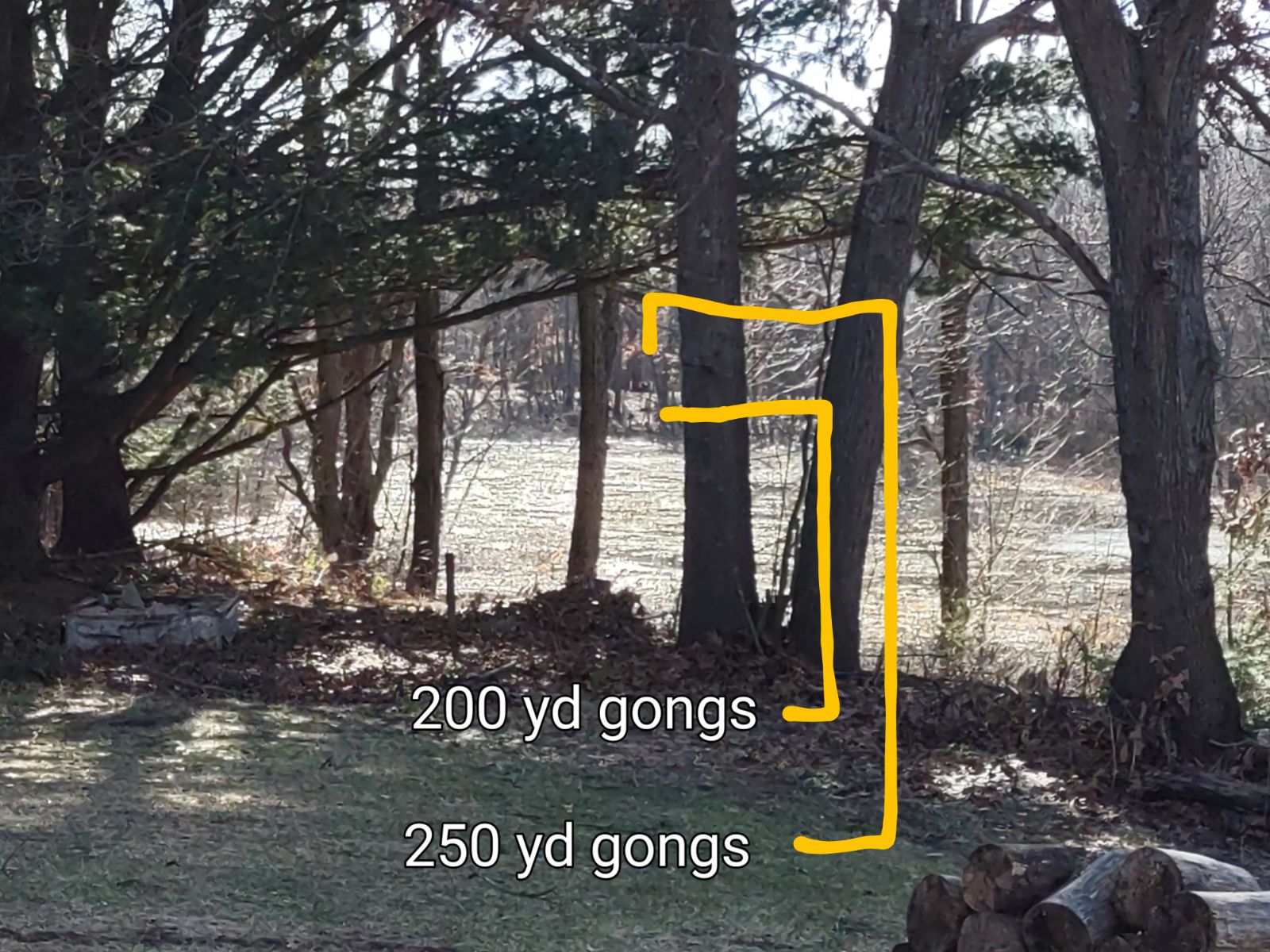

i can't see the gongs thru the trees
or is it, i can't see the forest thru the trees?
either way, i too am jealous of you having a great set up.

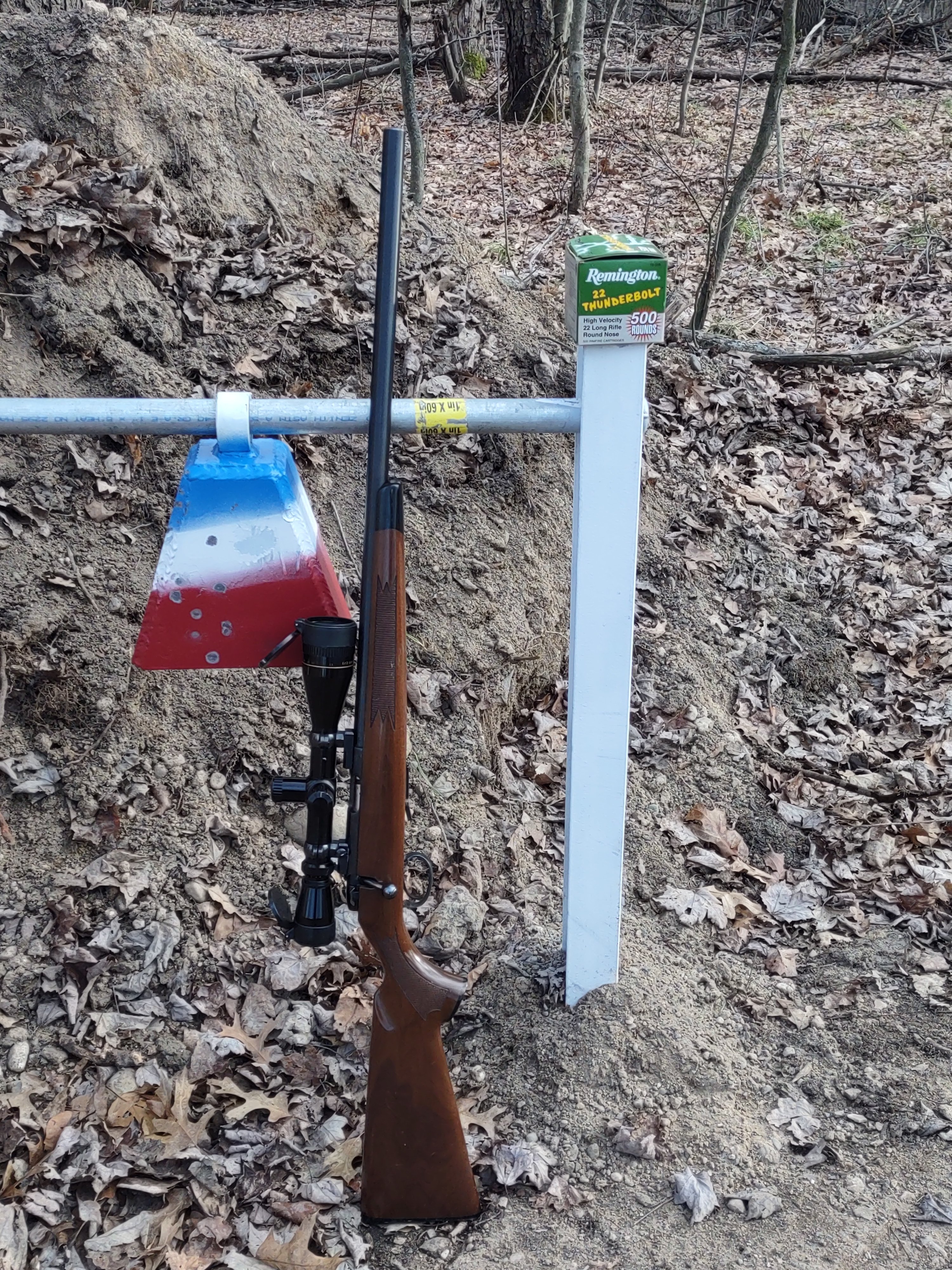

I tested the cowbell with the 22 at 250 yards to check out the ring tone. It was clear as a bell at this distance. You could even hear it resonate.
Rifle is a Remington M541HB-T with a Leupold Vari X II 4-12x40mm with turrets.
Shooting Remington Thunderbolt 22 LR ammo. It's a lot of fun!
