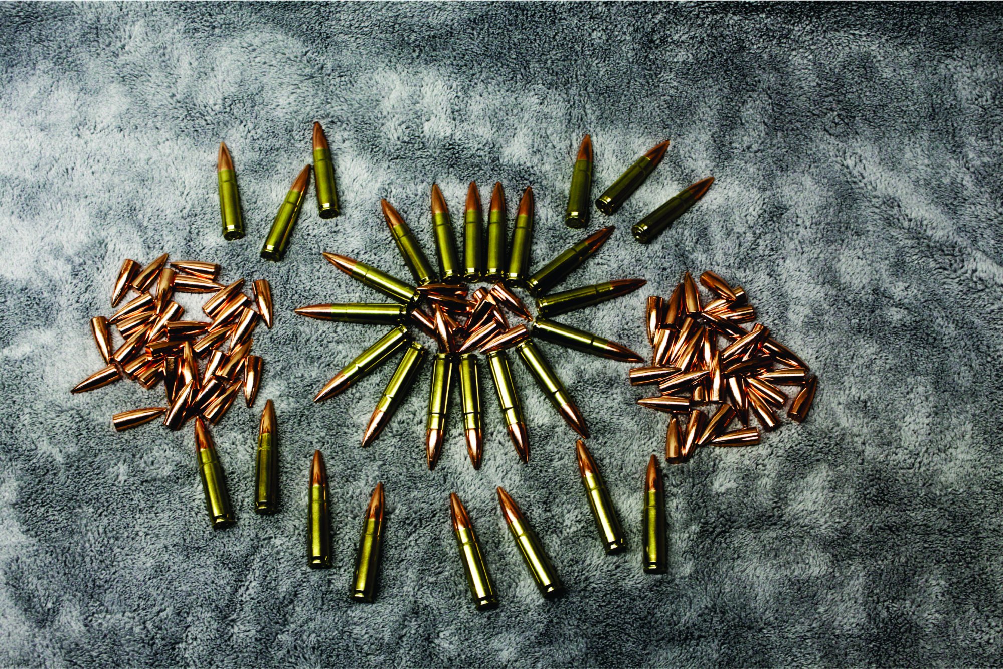

If these fly as good as they look we'll have a good old time Tuesday at the range. Would go Monday but got to get our taxes done before the rest of the family start dragging theirs over.....
125gr Speer TNT, 15gr Enforcer, COAL 2.063, Approx 2000fps
As it's my first rodeo with the cartridge it's on the weaker side for the powder.
The flat base Speer were not a problem to seat. A Lee Universal expander die came
with the Sabot set up (I ordered everything) and it didn't take but only slight expansion
and the Speer seated just fine.
