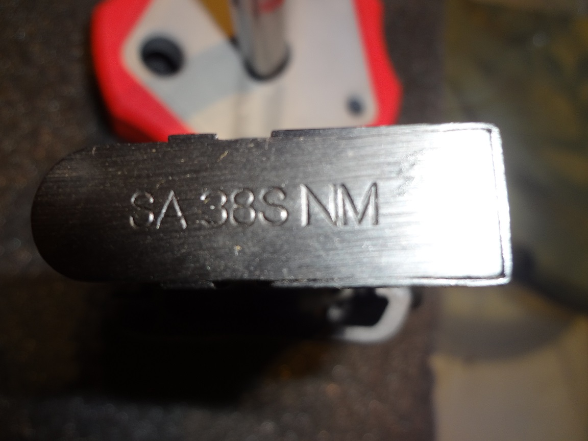

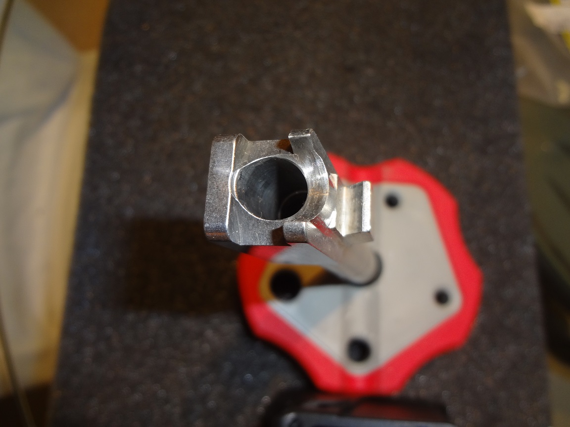

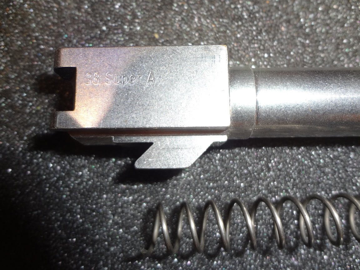

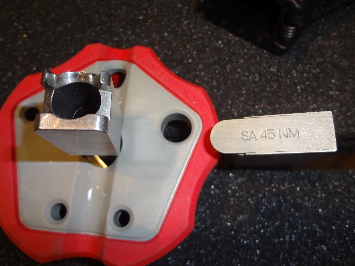

Post a few pictures , that will help identify the barrels
i got a few pics. i do have to make a correction on one of my previous statements. there WAS a spring in the 38 super bag.

thats pretty cool. usually my dad keeps all the stuff for a gun together. these barrels and mags were in a tupperware type container. so it appear hans was right that you need to change recoil spring if swapping out to 38 super. now i need to find out when swapping to 45 if anything else needs to be changed
