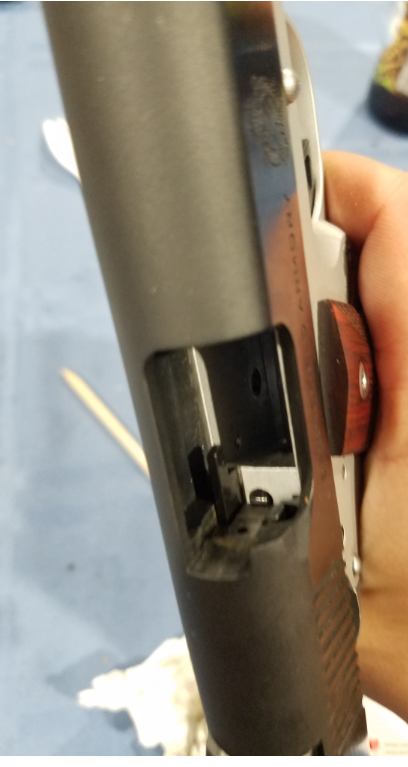

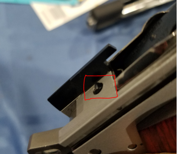

Hello peeps, this is my first 1911 and already I don't think this is normal operation.
Every time I rack the slide it would hang up on this part.
Can someone tell me what this is and purpose?
The slide would go forward if I force it past that point.
What would be the remedy for this?
Ok, when the slide is off, can you push the disconnector down with your finger? If so, put a little oil, I mean just a drop, gun needs broke in more then likely, also, is the magazine in when this happens, if so, that’s normal because of the magazine is empty and it locks the slide open after last shot. That is the disconnector, that’s what resets your trigger for the next shot.
Lube the gun also, just don’t over do it, little goes a long way, put oil in the slide rails, and in the lug area inside of slide and a drop on the lugs on the barrel itself, and a drop around the outside of the muzzle area of the barrel.
I’m the opposite when breaking in a new 1911...I run it wet, much wetter than I will after break in...grease and oil on the rails, a little grease on the muzzle, oil everywhere else (rule of thumb—if it slides, grease it, if it rotates, oil it). Will usually do this for 300-500 rounds before I detail strip & clean, and then go to normal lube regimen (similar to what you describe, but using grease in aforementioned areas).
For 1911’s I’d use oil and not grease, in case your using grease. WC even recommends oil over grease on 1911’s. Push down on the disconnector and see if you can feel it “hanging” up on the leaf spring that the disconnector contacts. If so you could polish that or give it a sight bevel. If you don’t feel it hanging up, running a couple hundred rounds and breaking it in could smooth or help things out.
