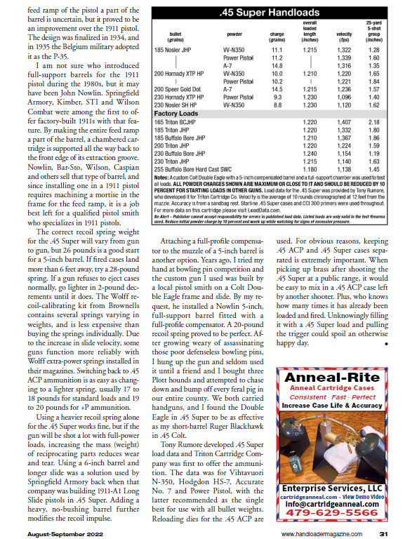

@papa
Wildcat Cartridges: .45 Super
Handloader magazine
Handloader 339. August-September 2022
Pages 28, 30-31.
45acp +p max psi 23k
45super 28k
460r 40k
from what i can find 45super is basically the same as 45acp +p+ (28,500). so for debate if 45super can shoot safely in +p rated, answer is no unless it's at or less than 28k. i have standard and +p headstamped brass for 9 and 45 for just in case of mixup. now on deciding if i want a 460r or 45super for my next 45cal?
