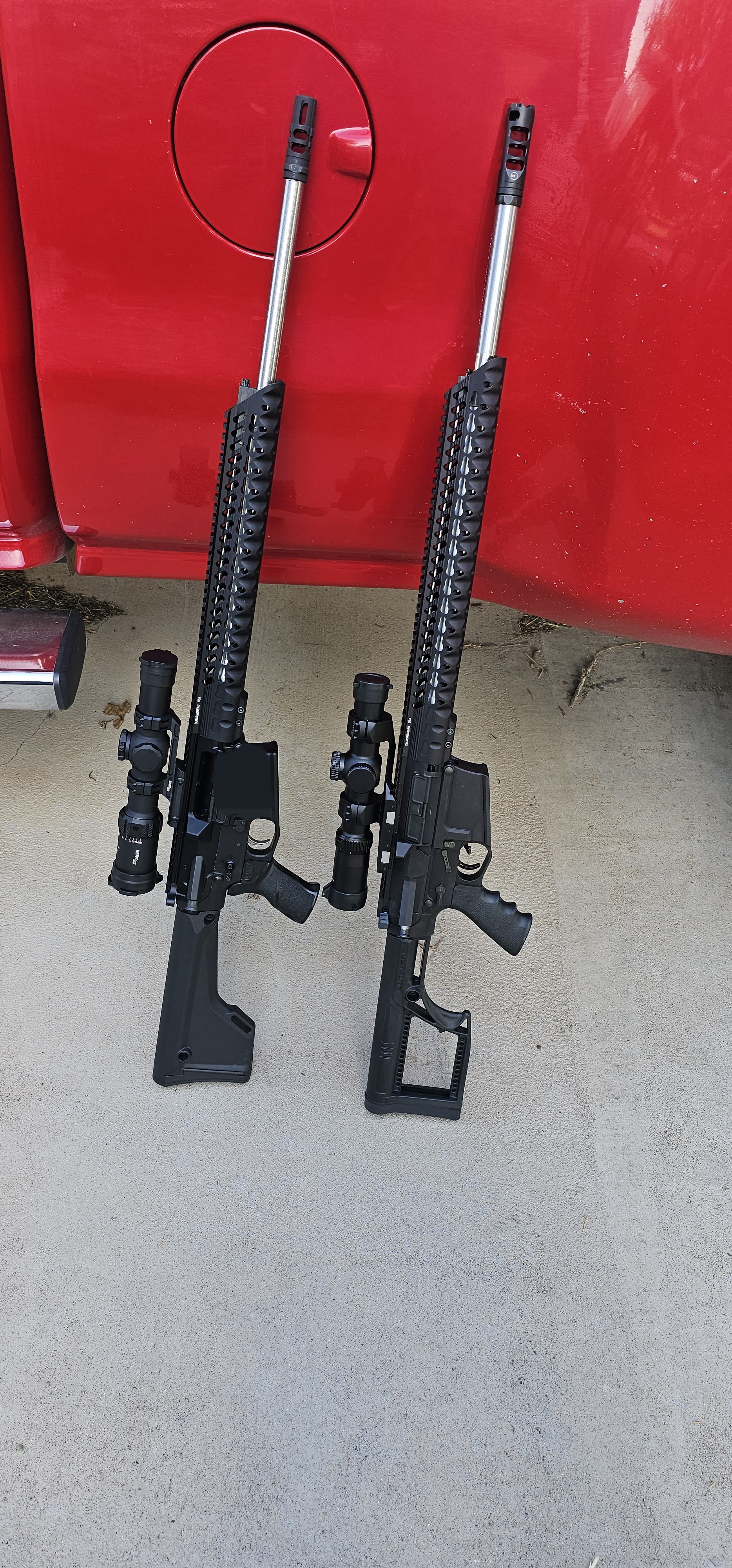

Had some time this morning to test fire for function with factory Norma 143 golden target. 1st shot ejected and picked up next round. Ejection issue asit was in the 1 to 2 o'clock position. So, undergassed it wad and still loaded next round. Strange? Opened the block up 5 clicks and didn't change direction in the to 2 o'clock. Setup 50 yards from torso sized AR500 1/2" plate and rounds fired struck the plate, so it was somewhat zero'd. After 7 test fired rounds I decided to check the buffer.......yup, it had the 9.5oz rifle buffer in it. I forgot I installed it for safety reasons incase it op'd. I'll change it out for a H1 weight, so about 5ozs or less weighted buffer. "Felt " recoil was near to nada. Probably going to be my 15yo favorite AR as he shot it also. Progress is slow, but it's a start!
L) 7-08rem
R) 6.5PRC
L) 7-08rem
R) 6.5PRC
