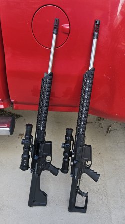

L) 7saum AR barrel
Right pic
L-R) 7-08rem, 6.5prc

Is that your 65 PRC on the right? If so, how is it shooting? Give us some info.
the pic with 2 ar's has the 6.5prc (R) and 7-08rem (L), but i found some larue mags that can give 2.865-2.870 coal lengths. also asc mags can give longer than usual 2.800-2.830" lengths with ar10 and ar15 mags (2.305-2.315"). haven't had time to shoot or do load development yet? hopefully soon!
Very nice. I definitely want to hear how it shoots.
