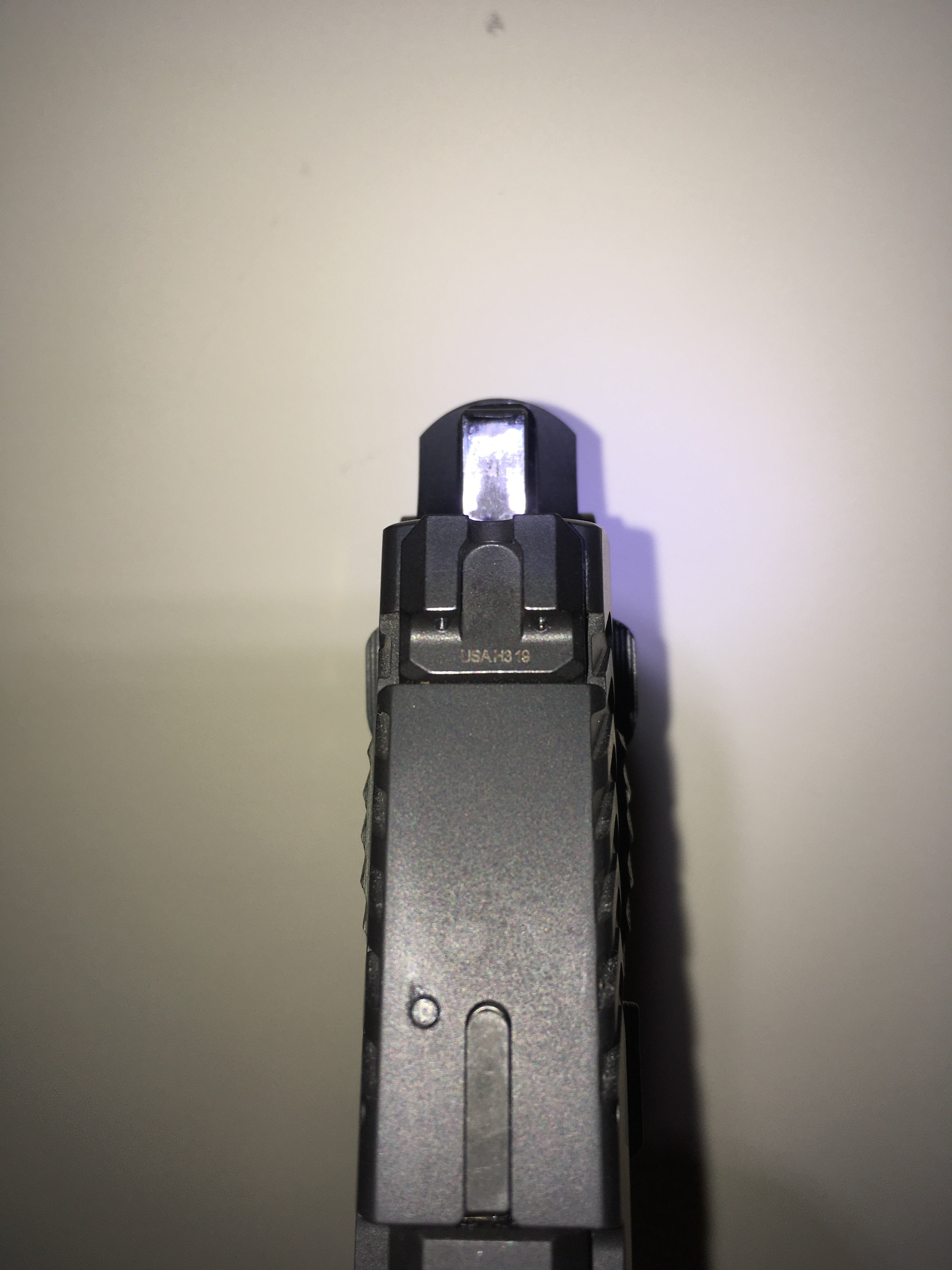

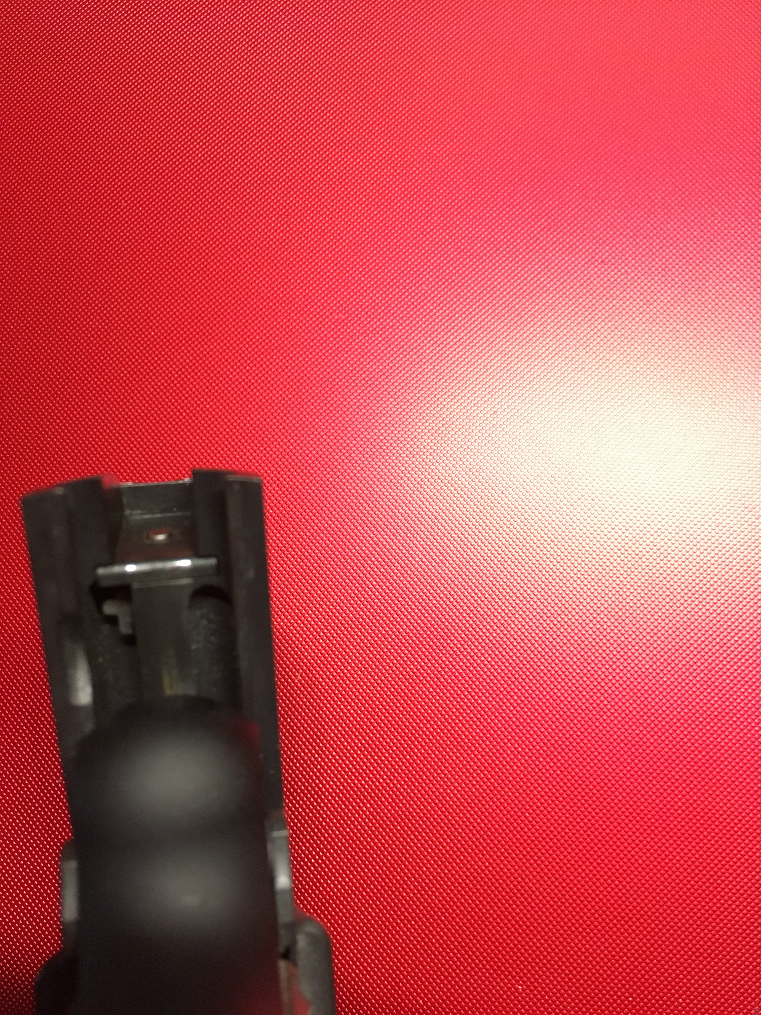

I have one, completely love it now after I figured out what What’s causing the malfunction issue.
It was same issue as seen on a lot of YouTube videos where you fire a round and slide is coming back into Battery but stops short of completely chambering the round and you have to finish by pushing on the back of the slide to make it go on a battery so you can fire again.
if you look at the Face of the hammer you’ll notice on where the slide rides the hammer forcing it back to cycle it. you’ll notice that one of either the right or left side the pakerization finish is being worn off more than the other, and a closer look you’ll notice that it was a bad grind at the factory(not a flat face but angled) so that side is putting way too much friction on the slide and causing The slide to slow down too much and loses too much inertia to do a complete cycle(also completely messed up accuracies of where Bullet was hitting the target).
how I fixed it was;
taking a Lansky extra fine sharpening stone(same exact type of stones that armors use on trigger jobs )slowly and methodically wearing down that high side of the face of the hammer, from time to time cycling the slide and you’ll keep feeling where it keeps getting a better function as cycle the slide and rework if needed.
First picture is as you can see where the hammer was really wearing on the underside of the slide, second picture is after I had used the stone(I Did not completely polish the face of it as you can still see part of the black on the hammer, so as not to wear way too much metal).Now has 100% reliability, and it is very accurate now as the firearm is functioning as it should.
