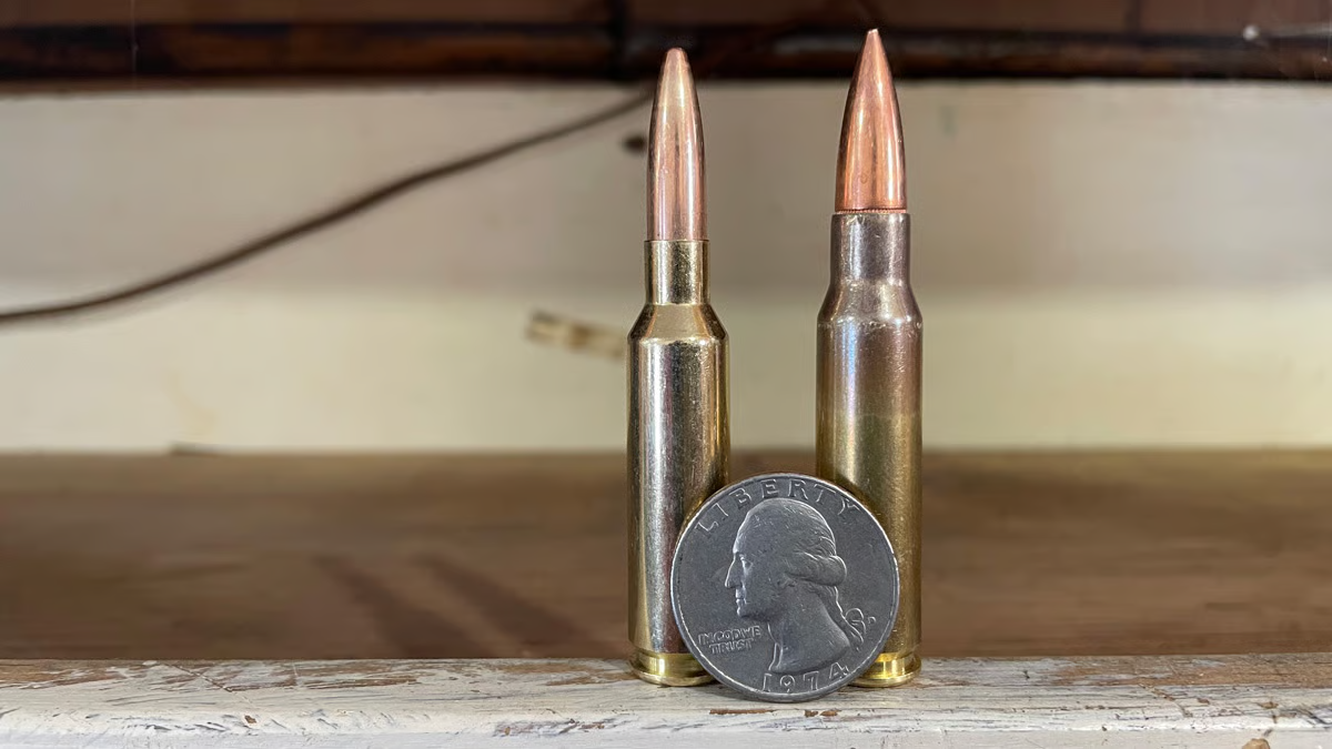

The 6.5 Creedmoor (left) is compatible with magazine systems designed for the .308 Winchester.
(Photo: Alexander Reville/Guns.com)

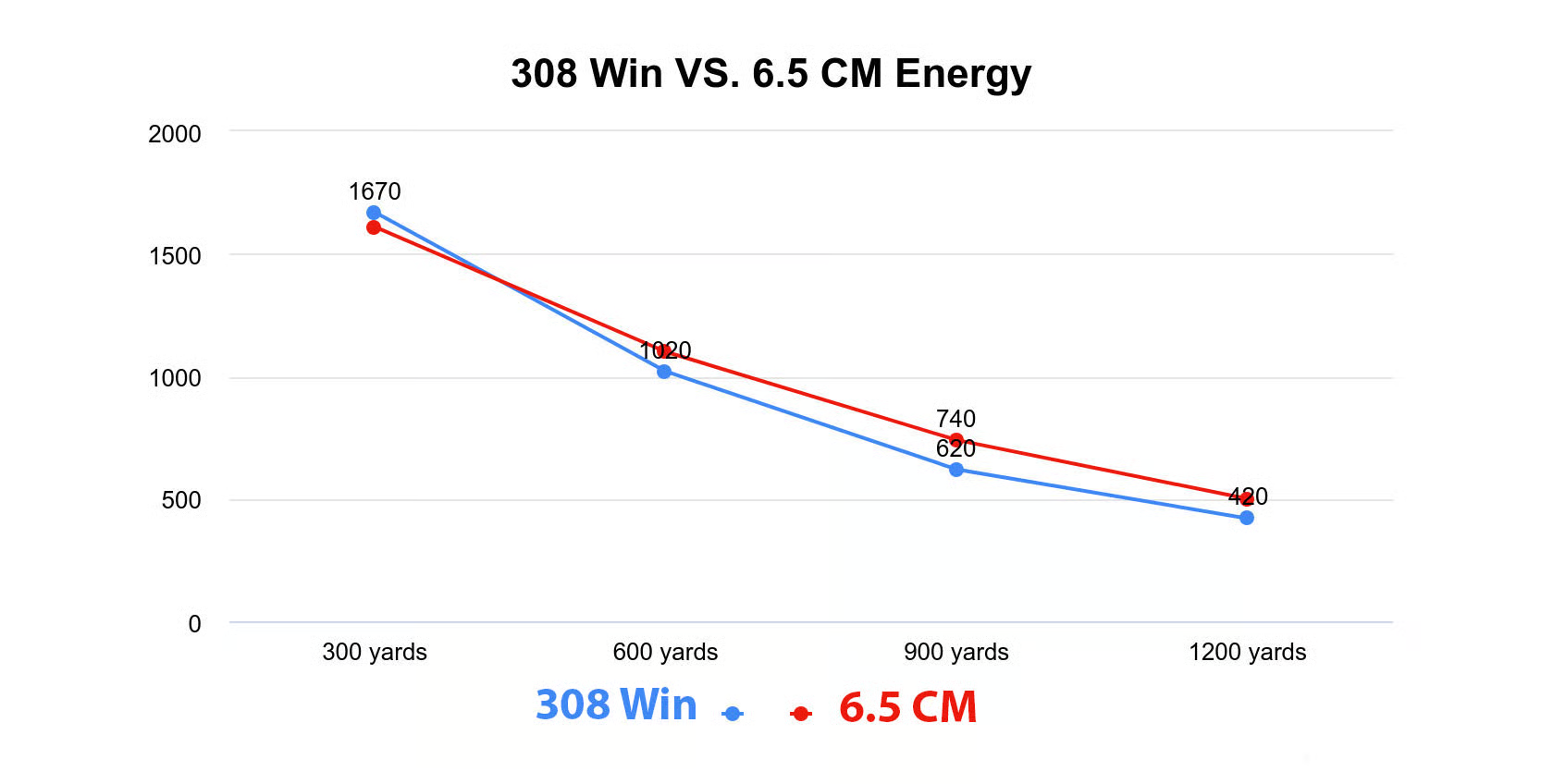

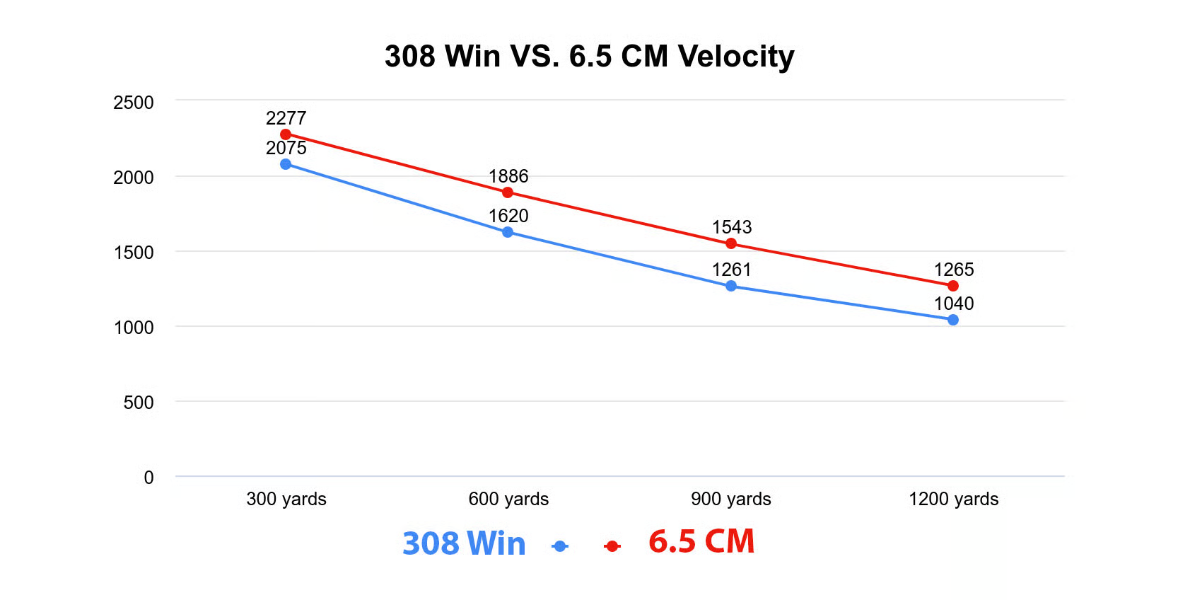

Using a real-world application as an example, let’s look at two of the most popular precision loads for the 6.5 and .308. The Federal Gold Medal Match 175-grain load has long been the literal gold standard for .308 sharpshooting, and the Hornady Match 140 ELDM is pretty much the equivalent for the Creedmoor.
The .308 has a 35-grain weight advantage, but it comes with a lower muzzle velocity of 2,600 fps. The Creedmoor, while lighter, starts out a bit faster, with a muzzle velocity of 2,710 fps. The .308 has an energy advantage in the first 300 yards, but after that it quickly loses ground to the Creedmoor.
