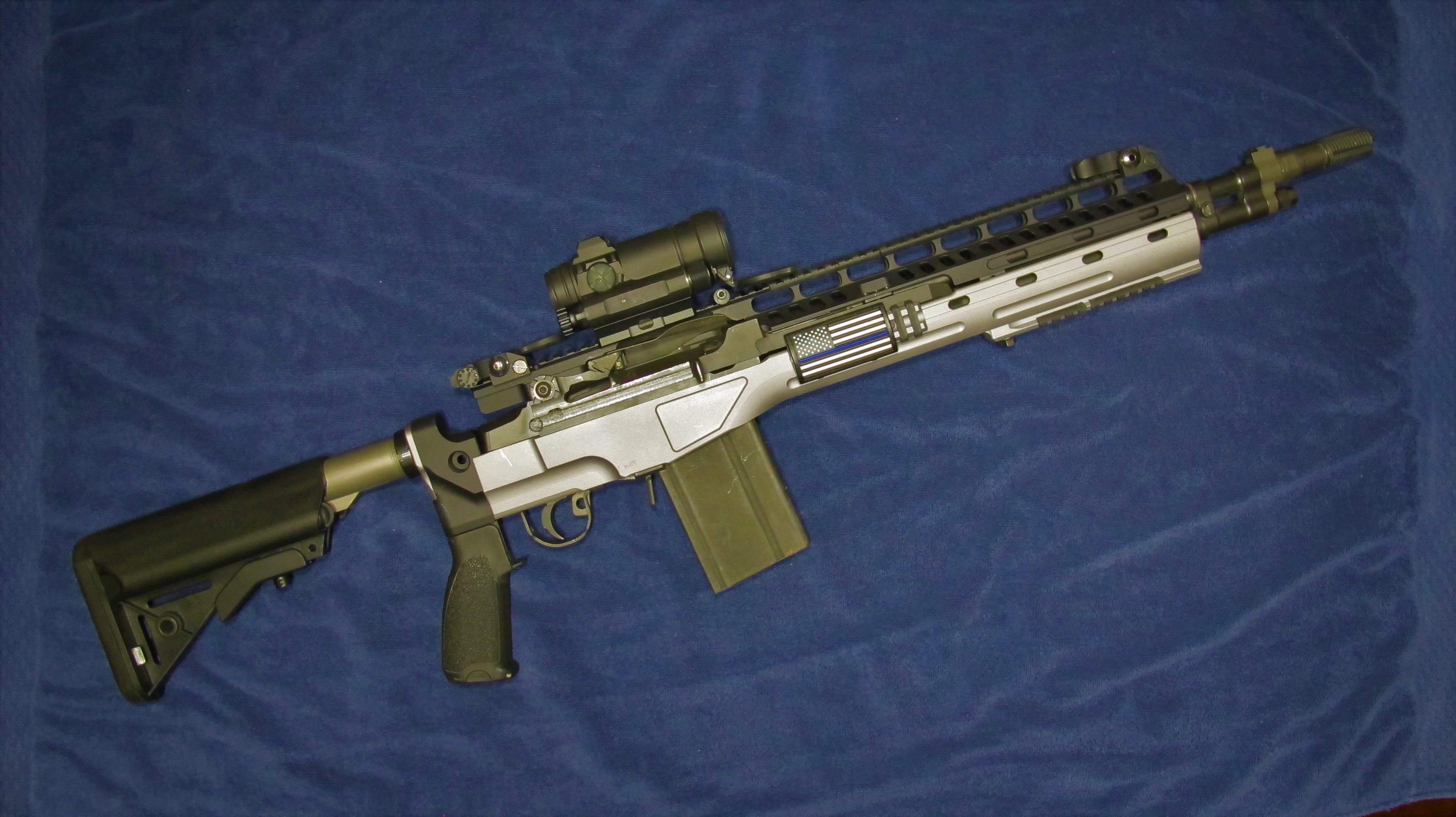

I have found the M14/M1A is easier to live with, it's accurate, reliable, easy to clean, and you have much more flexibility when it comes to configuring the rifle... even the muzzle blast from the Socom can be tamed by changing a few parts.
