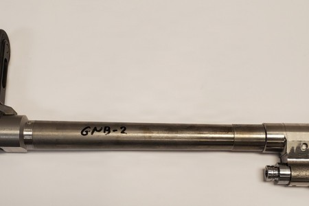

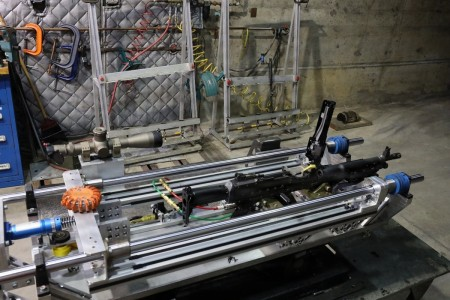

Geissele handled the manufacturing side. The company cold-hammer forged the barrels, directed coating alternatives and specifications, conducted performance testing, and developed manufacturability parameters. Carpenter Technology developed the GNB 200 alloy formulation and provided material samples for testing.
GNB 200 Alloy and the F41A21/18 Profile
GNB 200 is described as a "premium remelted alloy steel specially formulated for high temperature wear resistance" that offers higher tensile strength and improved wear resistance compared to legacy barrel materials. The alloy operates near the upper limit of what can be reliably cold-hammer forged, which is where Geissele's expertise comes in.
The F41A21/18 rifle profile, developed collaboratively with Geissele, reduces wear and improves dispersion. The profile received a patent in October 2025.
