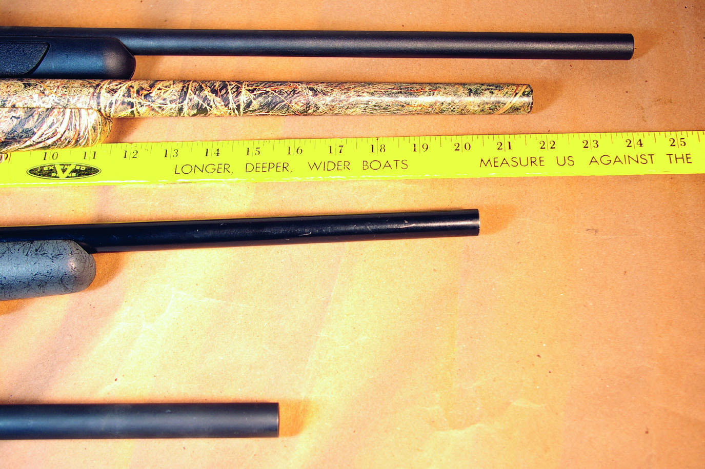

Four .223 Remington rifles with different barrel lengths were shot extensively to
determine what powders with different burn rates had on velocity and ballistic uniformity.
