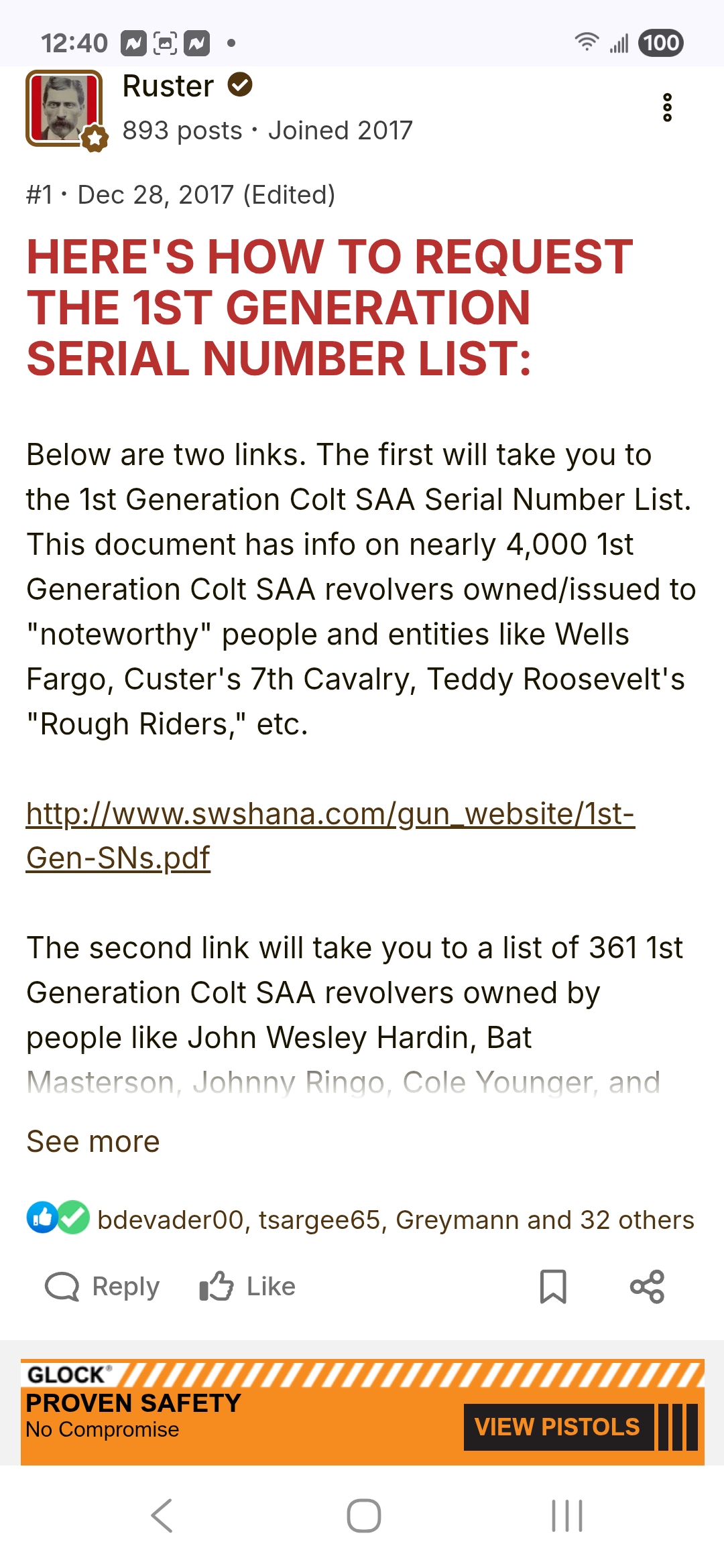

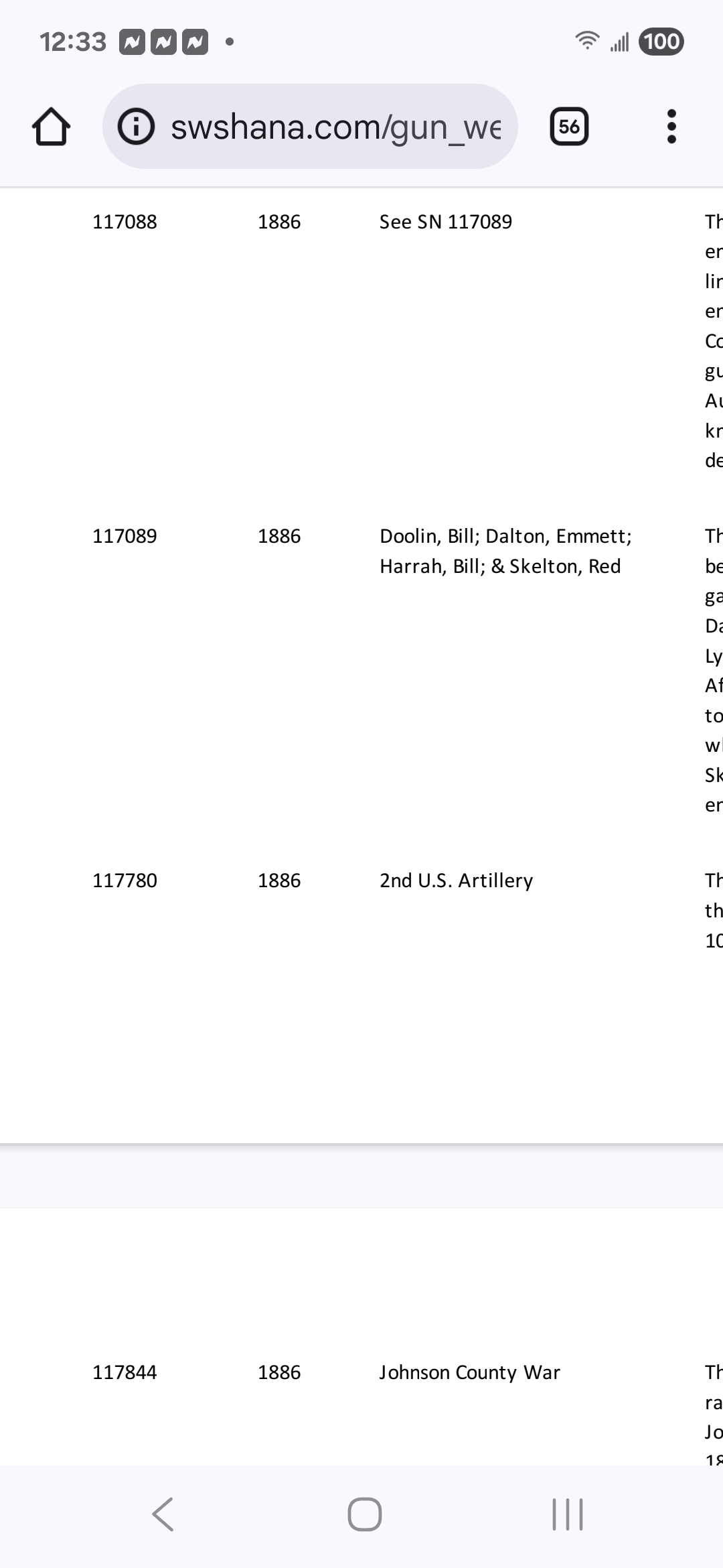

I did some medium searching , found a 370 page pdf of verified individual 1st Gen s/n .
117,xxx is 1886 . Bellow is a screenshot of some 117xxx guns with factory letters and other documentation . I'll post where to get the pdf in following post .
