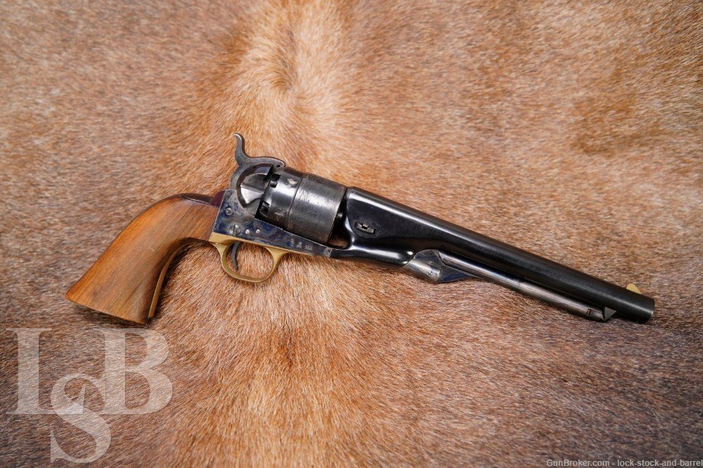

Hi guys,
I don't want to take up much of your time, just looking for a few resoures.
The recent thread about "which gun would you get rid of if you had to" got me thinking about my 1860 Army pistol again.
I just need supplies for it, powder (Pyrodex P?), lead balls, percussion caps (#10), sealant for the cylinders (wax), a few accessories (tools, powder measure/dispenser, etc).
I was wondering where you black powder guys get your goods. Any place other than Midway and Muzzler-loaders.com?
Do you know a good website that explains all the ins and outs of shooting this piece? I'm familiar with the basics but always looking to expand my grey matter. I appreciate your help!
