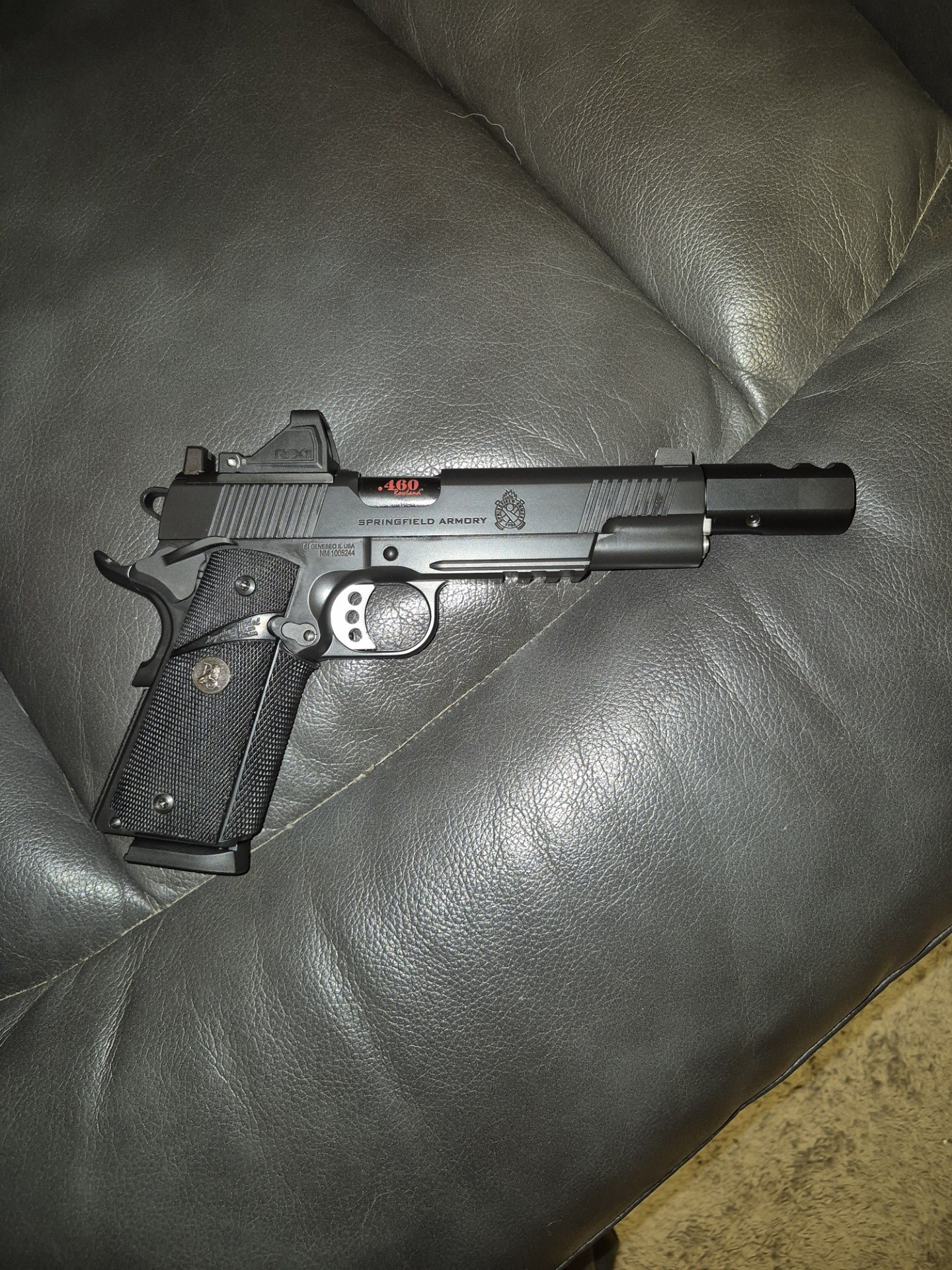

Here is my 460 Rowland. Shooting .45 acp in this thing is so much fun. The gun has no recoil and is smooth as butter
