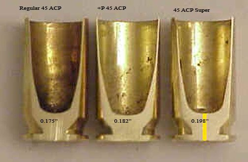

The .45 Super is a powerful handgun cartridge that is externally/dimensionally identical to 45 ACP or 45 ACP +P. Developed in 1988 by Dean Grennell, a well-known writer in the firearms field. It has a thicker case wall and is loaded to higher pressures, which offers an average 300 feet per second (91 m/s) improvement in muzzle velocity over the .45 ACP. The cartridge was co-developed with Tom Fergerson and Ace Hindman.
In 1988, a Gun World article detailed Grennell's efforts to update the .45 ACP for the 21st century, a difficult endeavor due to the inherent design limitations of the veteran round. Introduced in the early 20th century, the .45 ACP has a relatively large case capacity which was dictated by the relatively low-pressure powders in use at the time of its development; as a result, it operates in the modest range of 19,900 – 22,000 copper units of pressure (CUP). In contrast, current day cartridges using modern nitrocellulose powders generating higher pressure can produce CUP in the 28,000 – 39,000 range. As it was originally designed for lower pressures, the .45 ACP case has relatively thin walls and weak case head and web specifications; it cannot reliably contain increased pressures. The layout of most M1911 pistols' chambers presents yet another challenge in that the case head is not fully supported in the cartridge feed ramp area; pushing the envelope in this critical area with too much pressure risks a catastrophic failure, resulting in a case bursting in the chamber. To rule out such a dangerous possibility, Grennell chose to use brass formed from the stronger and more modern .451 Detonics, shortened to the overall length of the .45 ACP design. Support for the case head was also addressed by adopting a new chamber and barrel design which supports the base area of the case. Other areas of the model 1911 pistol design were also strengthened, including the addition of a heavier recoil spring and a strengthened firing pin redesigned to prevent primer material from flowing into the firing pin channel under high chamber pressures.
