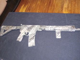

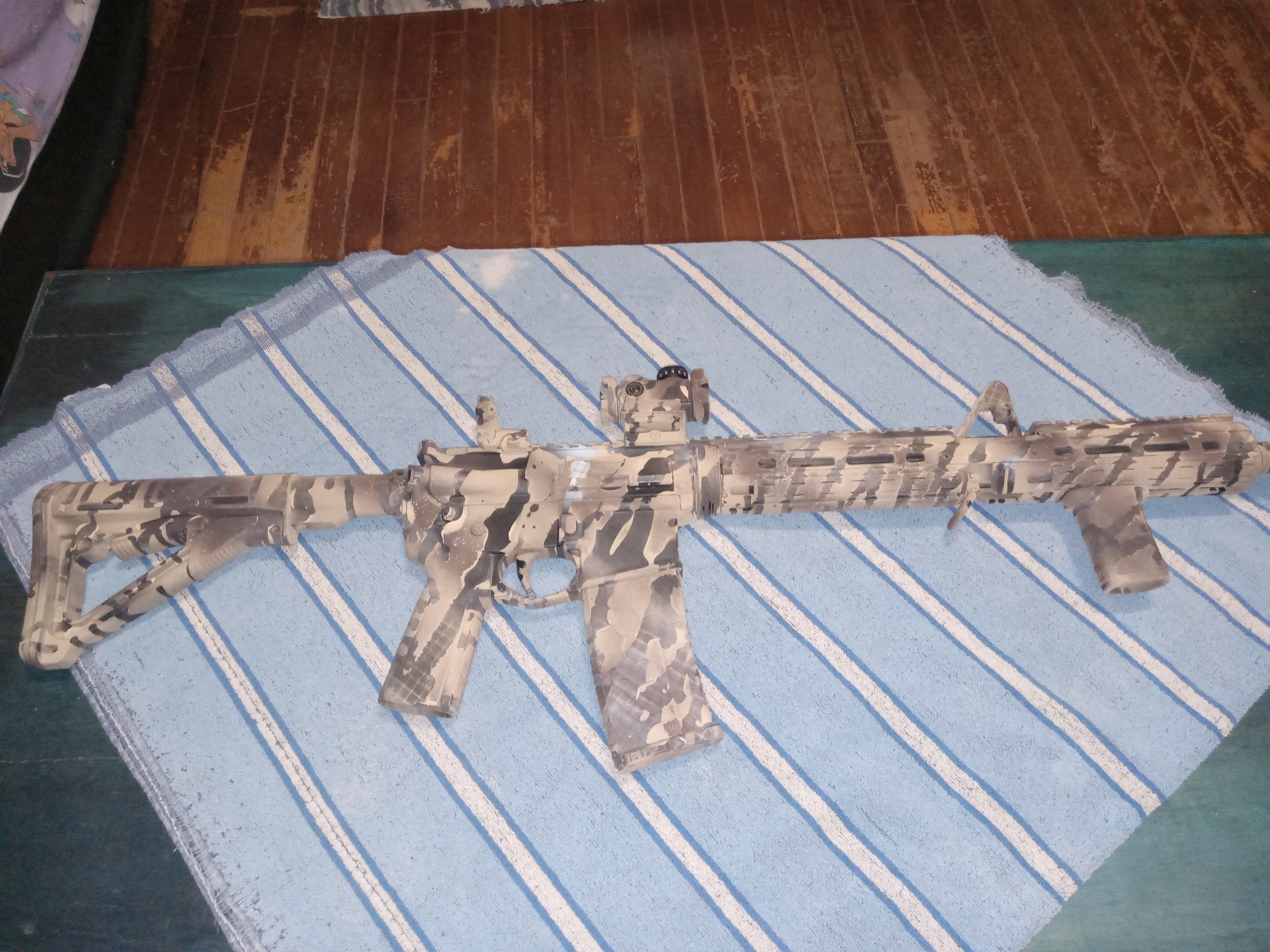

I've actually painted a couple rifles using this method.
