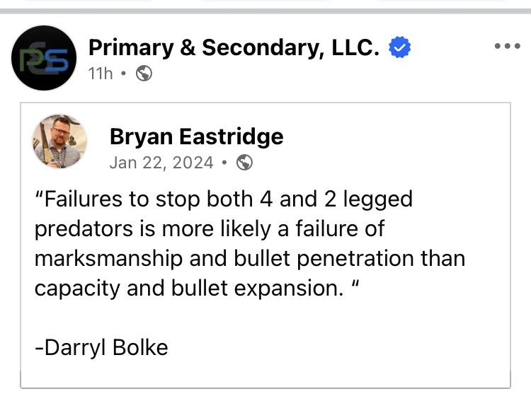

All the common service rounds perform within what the fbi firearms Training Unit (tops in research and real world stuff)
For 9mm the best performers are 124-147. Most agencies issue either 124 plus p or 147 Gold Dot 124-147 Federal HST 124 or 147 Plus P or not Hornady Critical Duty. Not quit the numbers but still popular is the Winchester Ranger and Remington Golden Sabre
Pick any of those and you will be fine as well as your gun shoots them well (which they should) and make your thoracic aortic box hits (3x5 cards or B8’s are great to practice on)
Some will bring up Buffalo bore here or double tap but they are boutique rounds not available to everyone off the shelf and I don’t like to depend on delivery systems all the time.
You can find then 3-5 main
Duty loads I mention at any box store or gun shop (I also recommend picking up more than you need (500-1,000 to keep back) in case anothwr pandemic event happens and hih can’t get new.
I’d you to have to use a 115 the Gold Dot is fine and the classic Federal 115 9BPLE plus p Plus is an old schol round that Illinois state police used and does 1,300 FPS and will go around 13” but comes apart and comolete devastates the target. The issue why it’s but favored js everyone wants bonded or locked (like critical duty) to retain weight and penetrate farther.
Also don’t get wrapped up in amature YouTube gel tests. If it gets 12-18 (FBI really prefers 14-16) your good somesont expand as large as others and it’s ok.
Some channels are down on Critical duty or Gold Dot G2 but IS Marshals Texas DPS KansasTroopers run Critical Duty, NuPD and Several Others Gold Dot 124, Indianapolis PD 224 HST, and LAPD Border patrol and Dev group (Seal team 6) run 147 G2.
All if the are dirt napping bad guys all over the country and world but the amateur gel tests dudes on YouTube some with a funny hats had that one failure (to him)
And from a coulle buddies of mine I train with all the time
