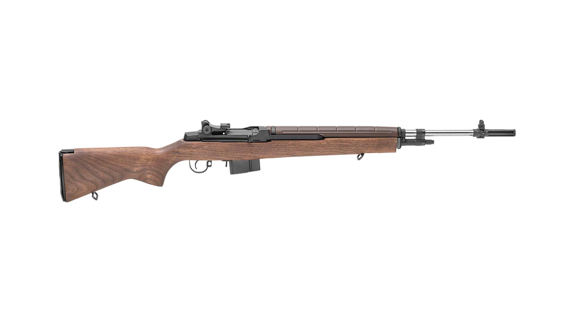

Here is one for the M1A fans out there, exploded view of it. Good information and nice pics with this article.
Yup, that was a goodie, thanks Annie!
