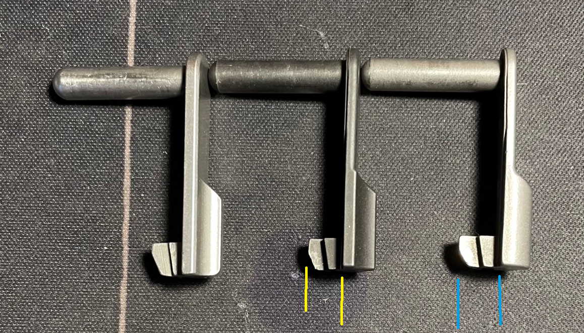

.45 slide stop pin lengths come any where from .197-.203, but 9mm/38 Super are longer. The length difference is how far the “shelf” that extends into the mag well and contacts the magazine follower protrudes inwards. That varies as well between manufacturers.
slide-stop-png.861750
The one on the right is a 9mm, .45 in the middle, with the left one is a 9mm with just a different profile than the one on the right.
Wilson sells separate slide releases for the .45 & the 9mm/38 Super.
