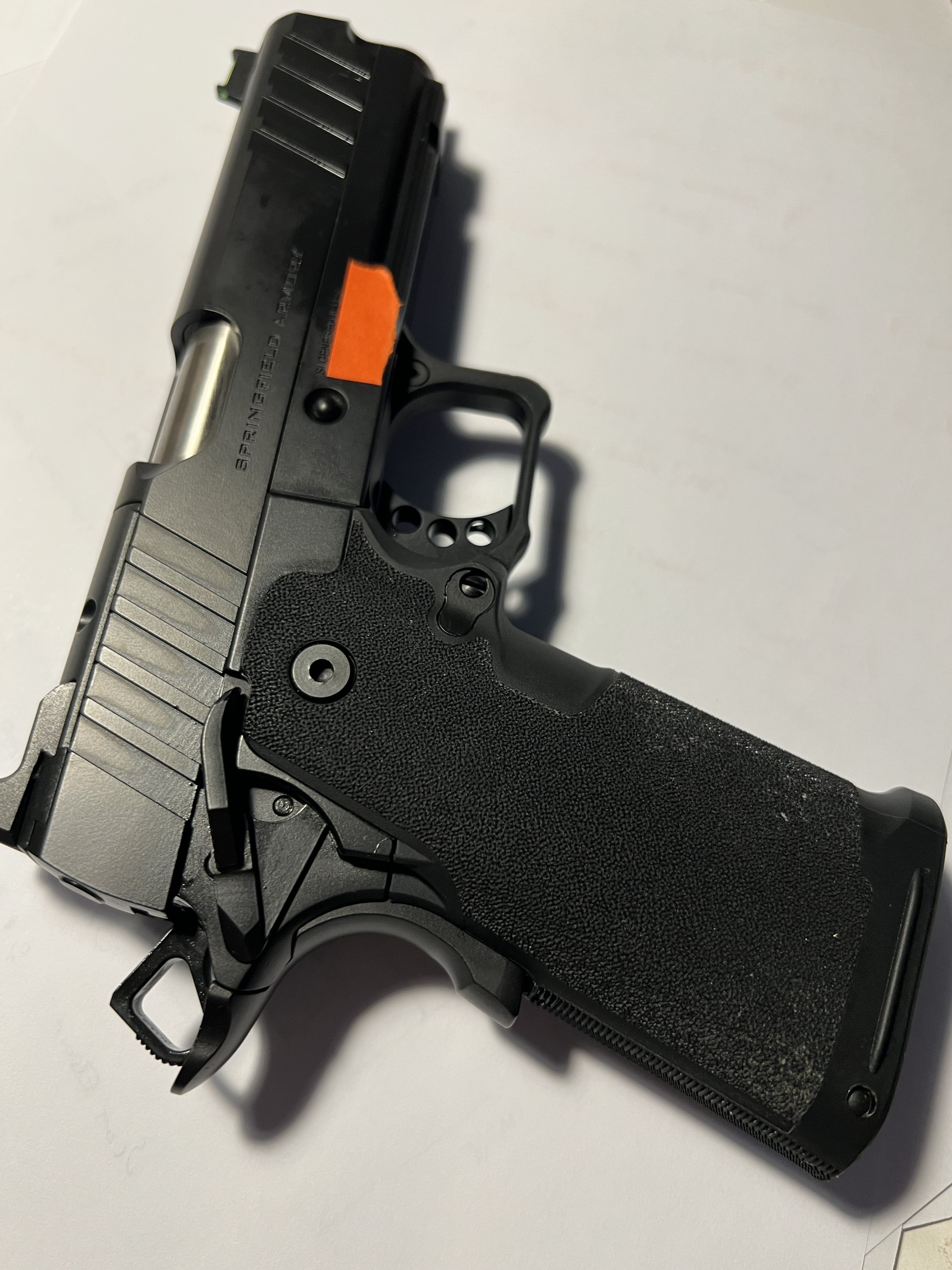

I took my Springfield 1911 DS Prodigy (4.25") on the range today for the second time. Both times it jammed before I could get 60 rounds. Today's jam requires a gunsmith. For $1500 I expect reliability and performance - not a gun that can't run through three clips before jamming.
What kind of jam do you have? Why a gunsmith? Can you post a picture?
Live round in chamber, slide will not move and hammer stuck.
Have you tried holding the slide in one hand firmly while you slam the web of your other hand against the grip safety. This is an acceptable way to unjam a 1911. Obviously make sure you keep your finger away from the trigger and the pistol is pointed in a safe direction. This is almost certainly what your gunsmith will do. I had my Prodigy jam twice while I was at the range while trying Sig V Crown hollow points. That is exactly the technique I used to unjam it both times.

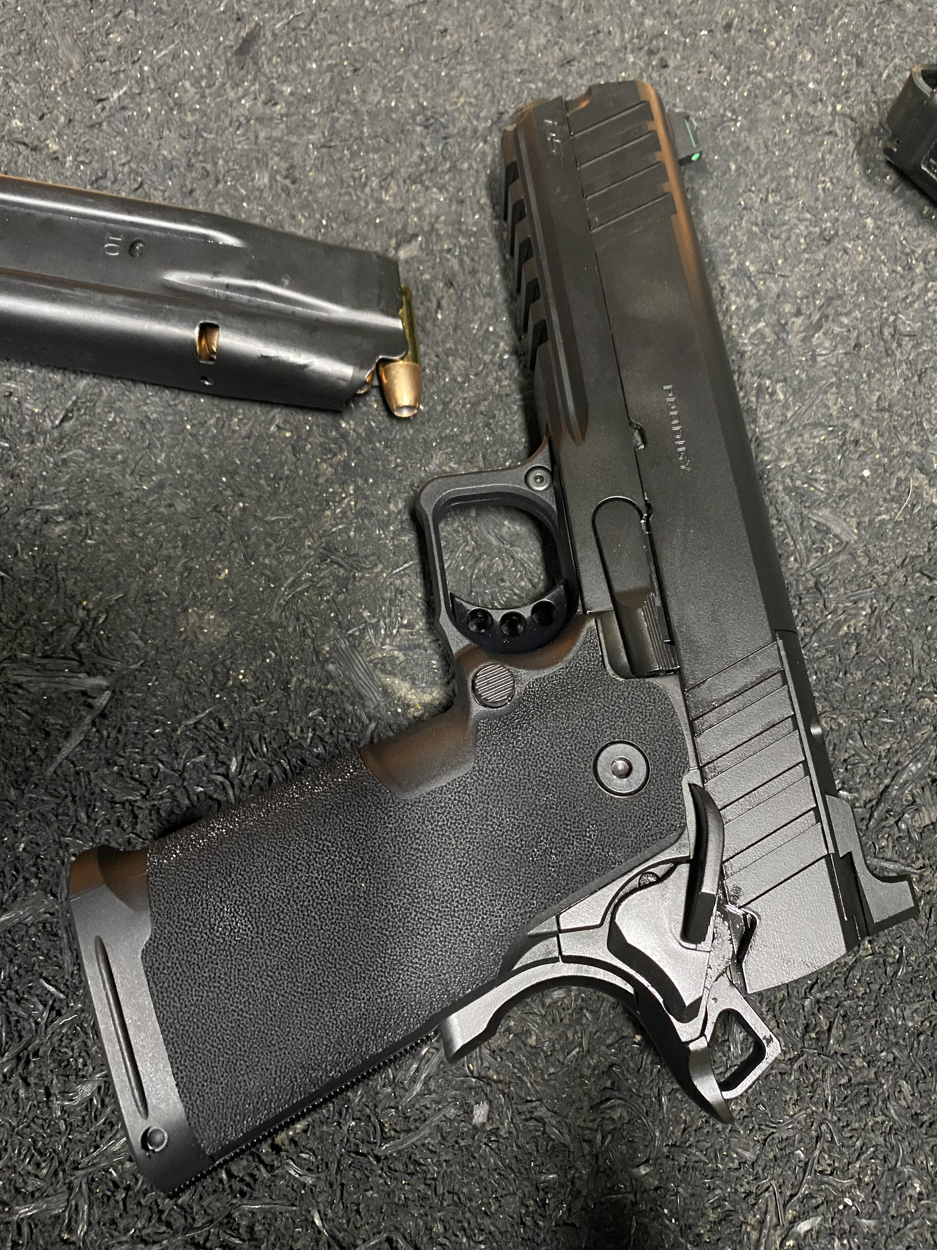

Here is one of the jams. Look familiar? You’ll notice that my slide was a couple of millimeters out of battery like yours

I’ll give that a try- thank you. But mine jammed each of my two range days and yours jammed twice in one range day. Is this typical with 1911? It cost 3x as much as my Hellcat and I haven’t had a single issue with it.
