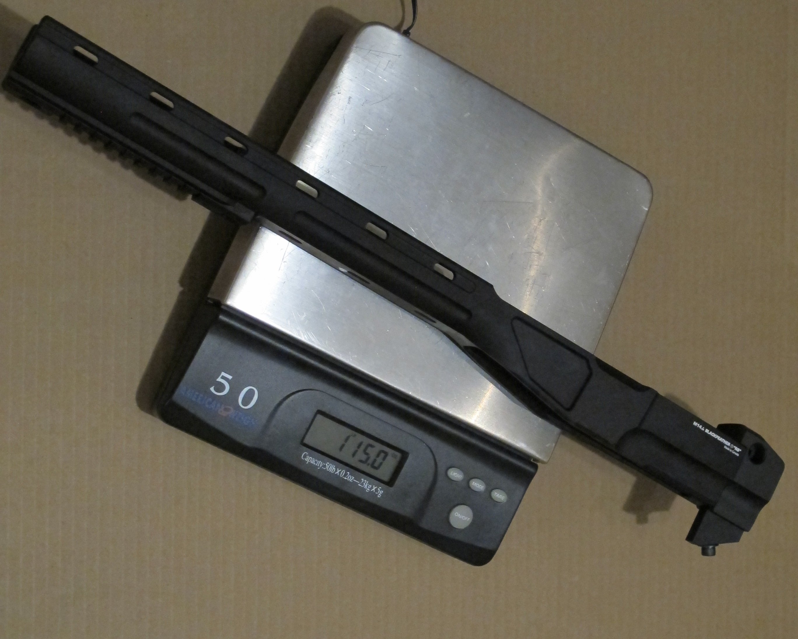

Exciting news for M14/M1A the enthusiast!, production of the much anticipated new & improved Gen II Blackfeather RS chassis stock commenced on Monday October 13th, 2025. The Gen II chassis is 6.0 ounces lighter than the Gen I chassis pictured with a butt stock adapter attached. Importation from Canada is expected to resume before Christmas of '25.
The 1st generation RS chassis was incredibly light, and the 2nd generation RS will be noticeably lighter. This weight reduction requires precise intricate machining to trim the fat without reducing strength and performance.

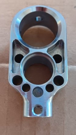

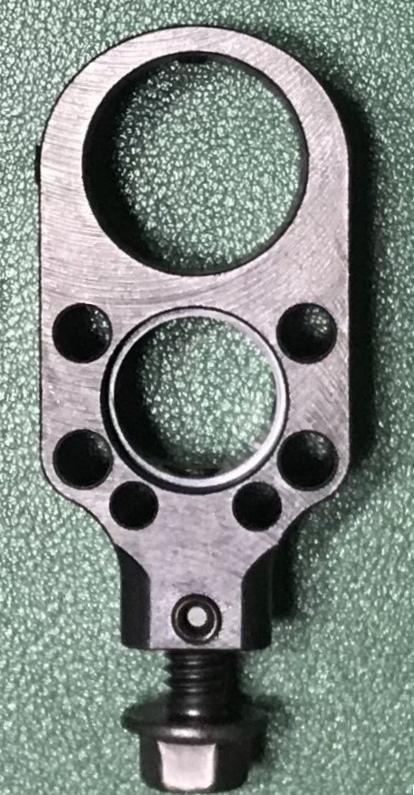

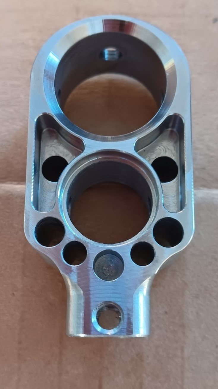

Proprietary Op Rod Guide (ORG):
1st Gen ORG vs. 2nd Gen ORG, just one example of what you can expect with the new Blackfeather RS Gen II

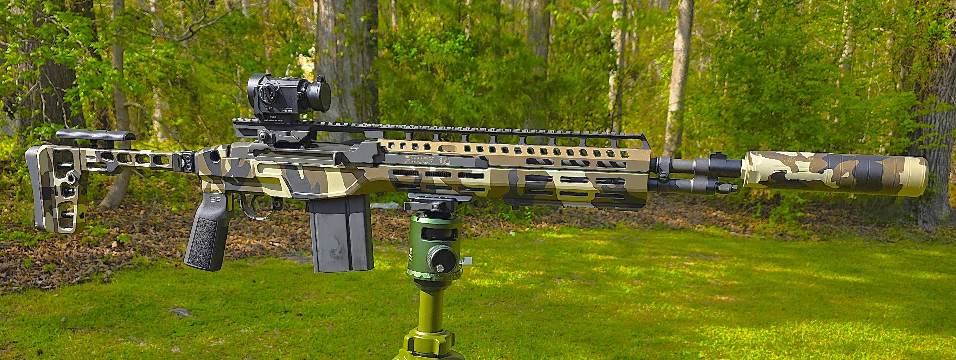

This is probably the finest general purpose (GP) configuration one could come up with for the MOD II BF-RS, a standard weight suppressor ready 18" barrel with an old Aimpoint mounted low on a MOD I scout hand guard (SHG). The MOD II chassis has the Mossberg butt stock adapter to which the Magpul SGA butt stock is attached to. It's light, balanced, compact quick and easily pointed at targets. The barrel is made more compact by replacing the standard muzzle device and castle nut with a DC Vortex flash eliminator and an HK style gas lock front sight, both are made by Smith Enterprise (SEI). The USGI M14EBR trigger shoe is for enhanced comfort and accuracy.

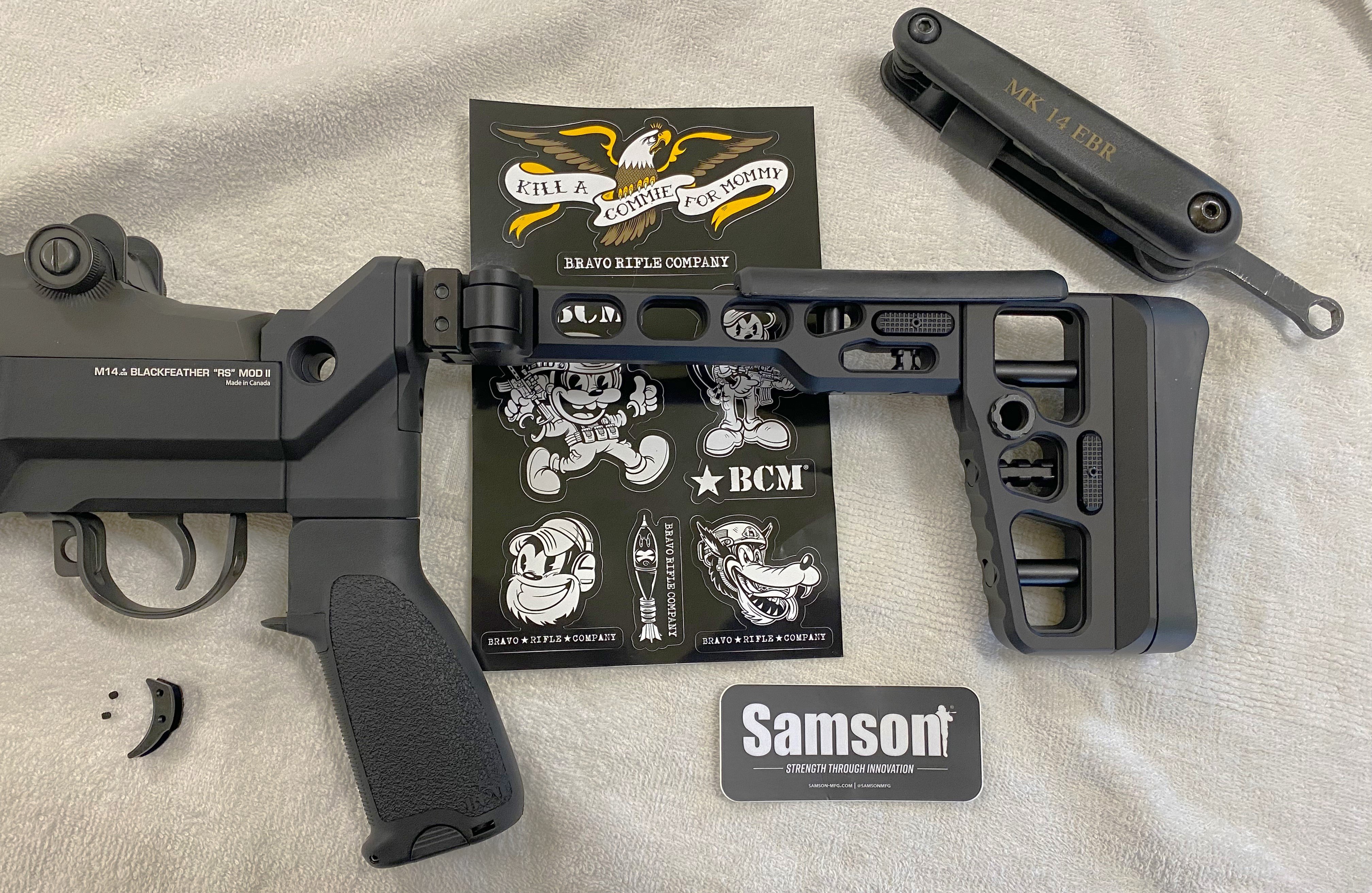

Finalizing my RS MOD II chassis stock configuration.
Optional High Butt Stock adapter with BCM Mod 0 pistol grip and SAMSON S.A.S. side folding butt stock with adjustable cheek riser and length of pull. With the exception of back-up iron sights on one of two barreled actions (16.25" & 22") this will be an optics only chassis stock.
