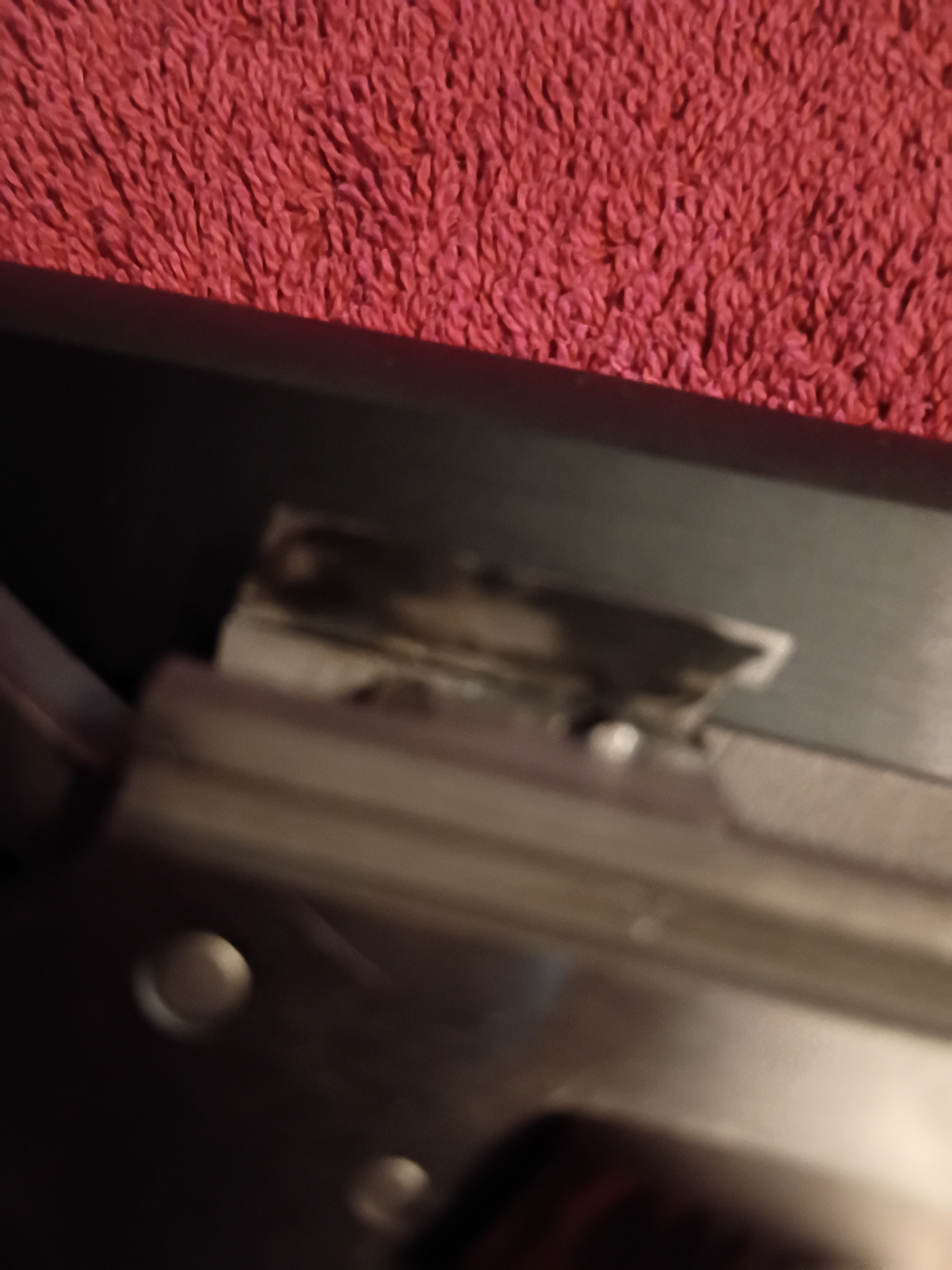

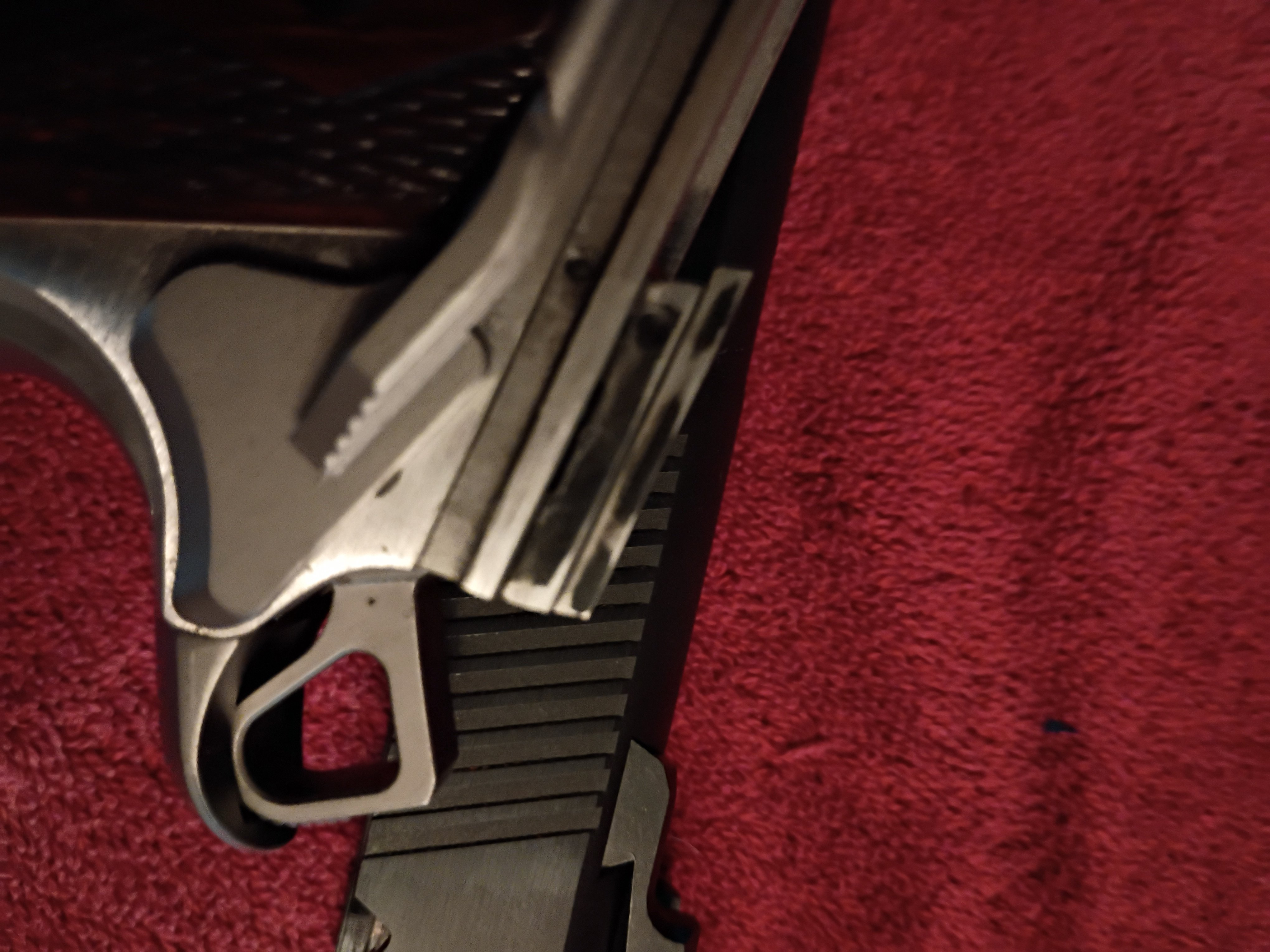

Most likely the issue is going to be the ejector. It's MIM and was probably not trued before installation. It is an easy fix. An India stone and about 10 minutes of your time.
Attached are 2 photos. The shiny spots are the areas on this one showing the high spots that were binding against the slide, retarding slide movement.

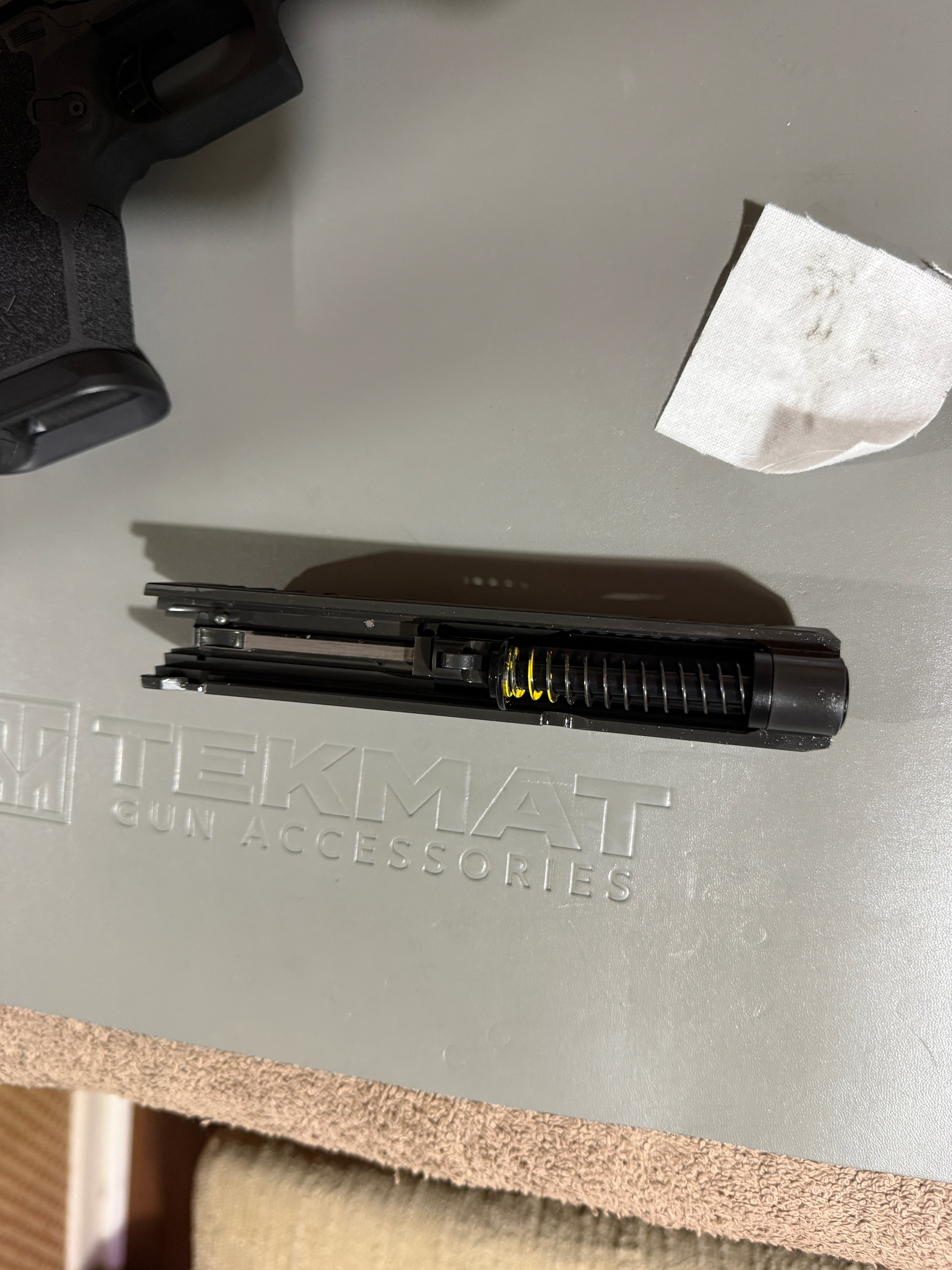

Here is a picture of what the recoil spring assembly of my HD 3.6 looked like upon receipt from my LGS after being ordered, built, and delivered by Staccato directly. It seemed to be dried up storage protectant, like maybe cosmoline. Must have been a RSA that spent a long time on the shelf! It took me 20-30 minutes to chip it all off. I am certainly glad I didn’t run gun out of the box as it’s likely that crap would have chipped out and potentially gotten into all the functioning parts of the gun. Funny thing is, if you read around, Staccatos that come from the factory to the consumer are supposed to arrive range ready - obviously this one did not!
