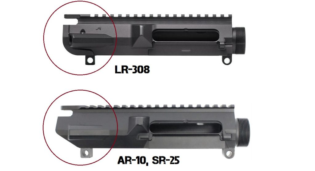

G2 is “its own animal” and is not “High” or “Low”
The LR-308 receiver sports a rounded rear facing, whereas AR-10 and SR-25 upper receivers are slant-cut. This prohibits using an AR-10 upper on a DPMS lower, and vice versa. Barrel nuts (and thus handguards/rails) are also incompatible: DPMS uppers use a 1-7/16" x 16 thread pitch for the barrel nut, but AR-10 uppers use a 1-7/16"-18 thread pitch.
NOTE: DPMS introduced two versions of their .308 platform's upper receiver, sporting "high" and "low" profiles. This only affects the height of the top rail by 1/16" and does not inhibit parts compatibility between the two generations.
There are some companies that use Armalite/SR25 cut receivers that are dpms compatible (excluding the interchangeability with upper and lowers). Barrel nut threads (I've found out by receiving the wrong barrel nuts) are different for sure. I have 2 Armalite cut receivers that (MEGA Arms) are dpms usable. There are a few others that like them also (can't remember which companies tho). Gen2 use a different bcg than dpms/armalitte/sr25's (not sure about receivers). Gen2 is similar to sfar, but not compatible.
