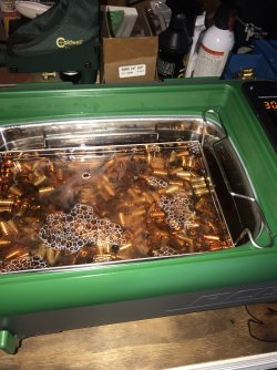

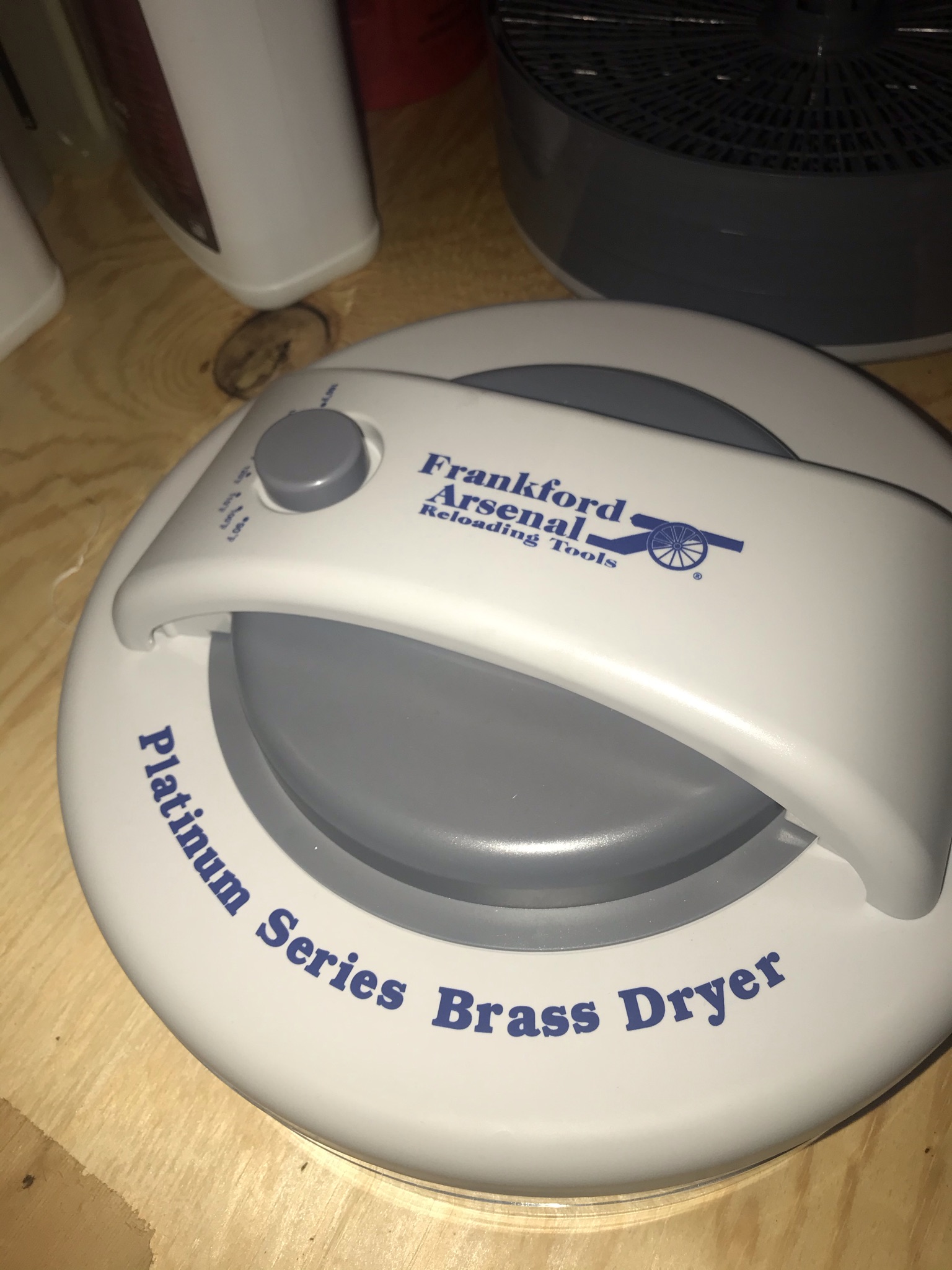

I have a Frankford dehydrator I've only used twice, but the brass wasn't the least bit shinny before going into the dehydrator. I used a Lyman wet heated machine that doesn't use any pins or even tumbles. Machine is vibratory and heated only. Most brass is clean in 5 minutes or less. I also didn't use any Lyman cleaning solution, only RCBS (green colored) that does fairly well. After the timer goes off and then the brass is removed and rinsed/washed with warm water (no soap), but usually rinse with room temp 1st and then final rinse with almost hot ( just more than warm without being too hot for hands) water. None have tarnished so far. Still doing some testing.

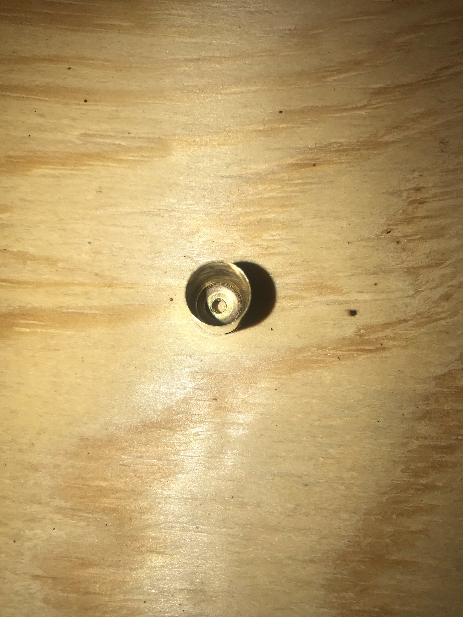

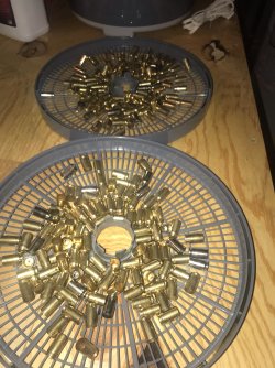

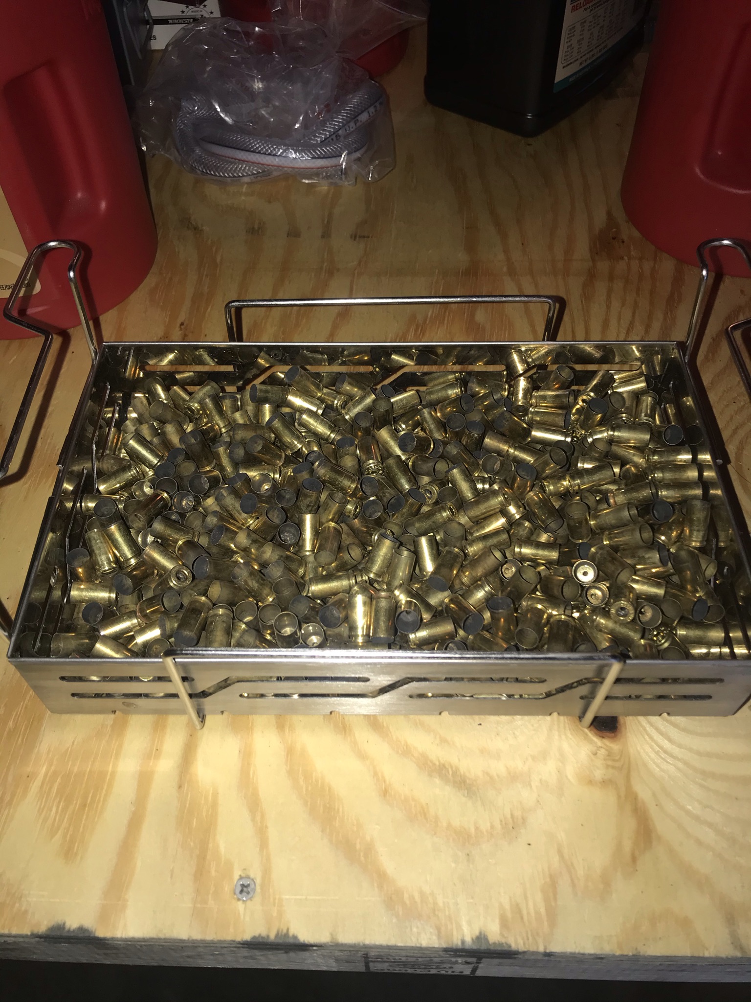

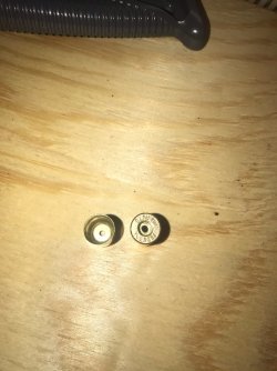

This definitely takes up more time. The inside of the brass gets cleaned out better. I remove the old primer before I put it into the solvent. The dryer does a excellent job.

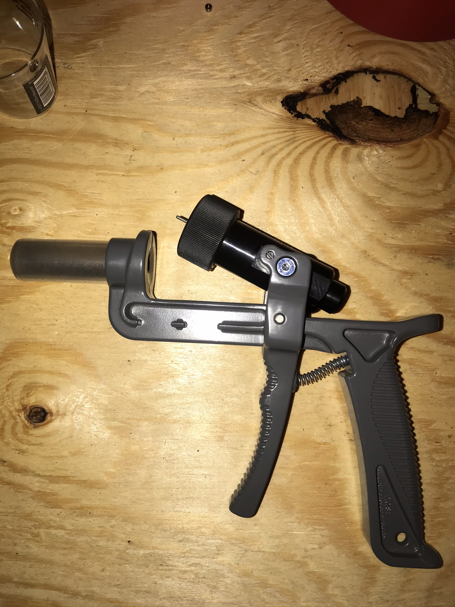

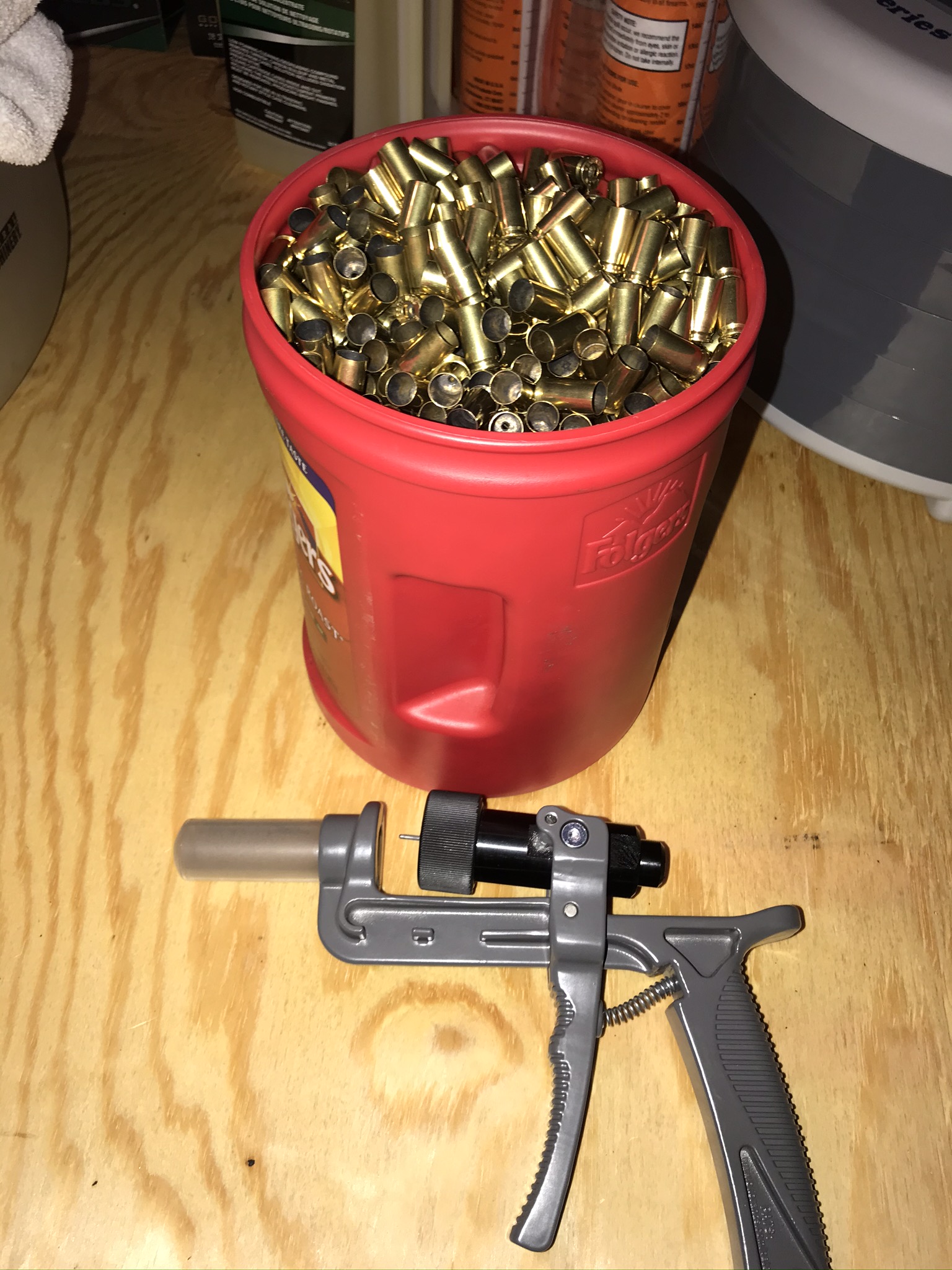

I use this little gadget to deprime cases. I usually do it while watching Television. I had more time when we was stuck in the house
When I shot benchrest competition many moons ago, I had a similar tool to deprime like the one you got.
yeah, Frankford Arsenal, i got one too, i think one of my first in a collection of reloading tools i bought, to start reloading.
