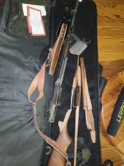

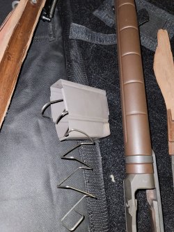

Anyone have a failure like this in an M1A1 308/7.62 , had it three months

This is what I would do.
Collect case fragments.
Check to see if there are any barrel obstructions.
***Take pictures of everything, this includes the ammo box including lot numbers, and record of purchase credit-card log or recipt ***
Call ammo manufacturer and SA customer service.
I had an issue with an ammo manufacturer and I had to send the remaining ammo and box and received reimbursement.
I want to say it looks like detonation, but there should be more here that have a better idea.

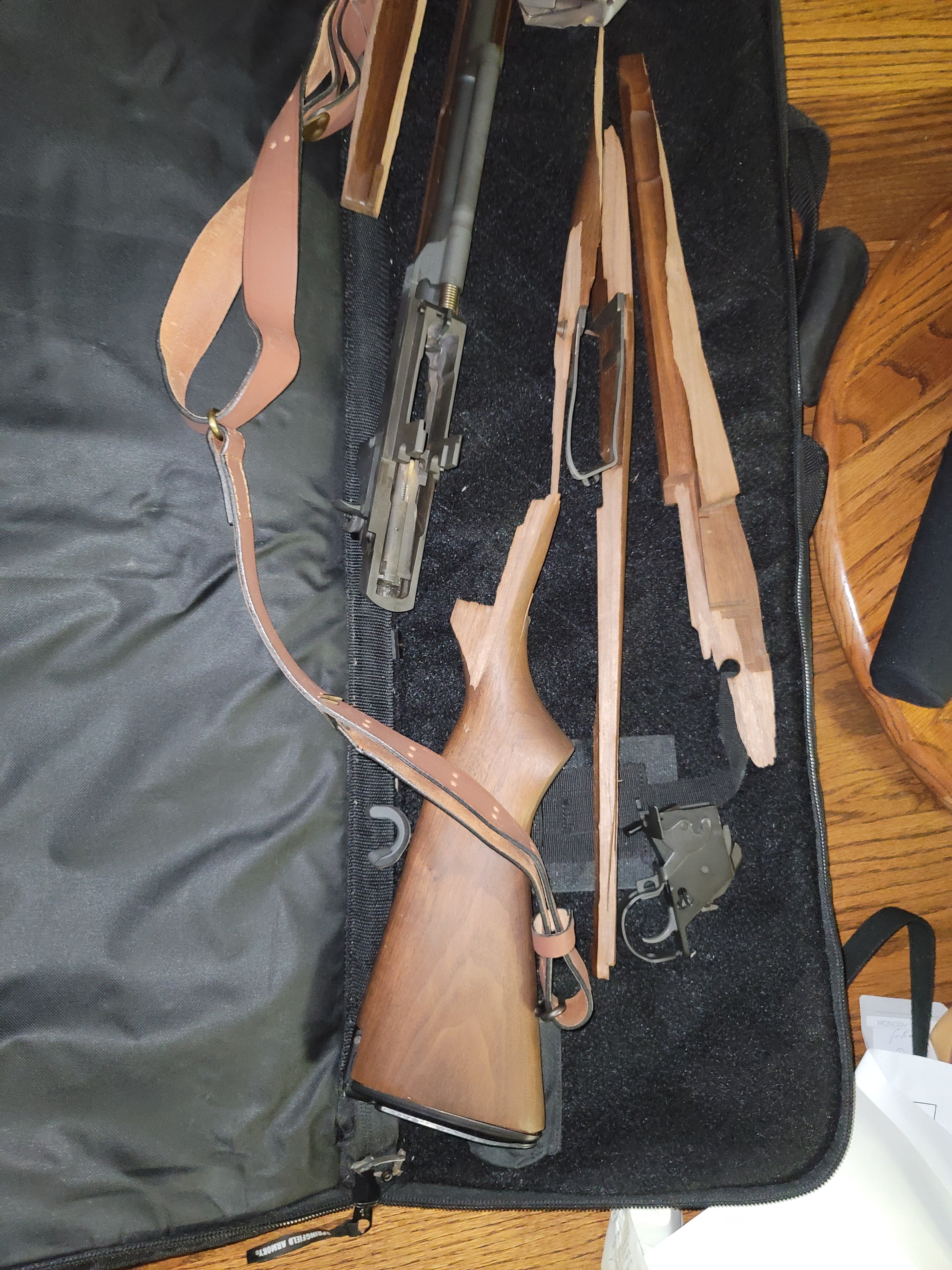

Wow. As mentioned by @Classified take a ton of pictures and document everything, contact Springfield Armory and talk to them, obviously they will want everything back to investigate the cause.
There could have been a barrel obstruction but you should see some barrel expansion, I’m thinking a very hot load or detonation combined with the bolt not being closed in full battery.

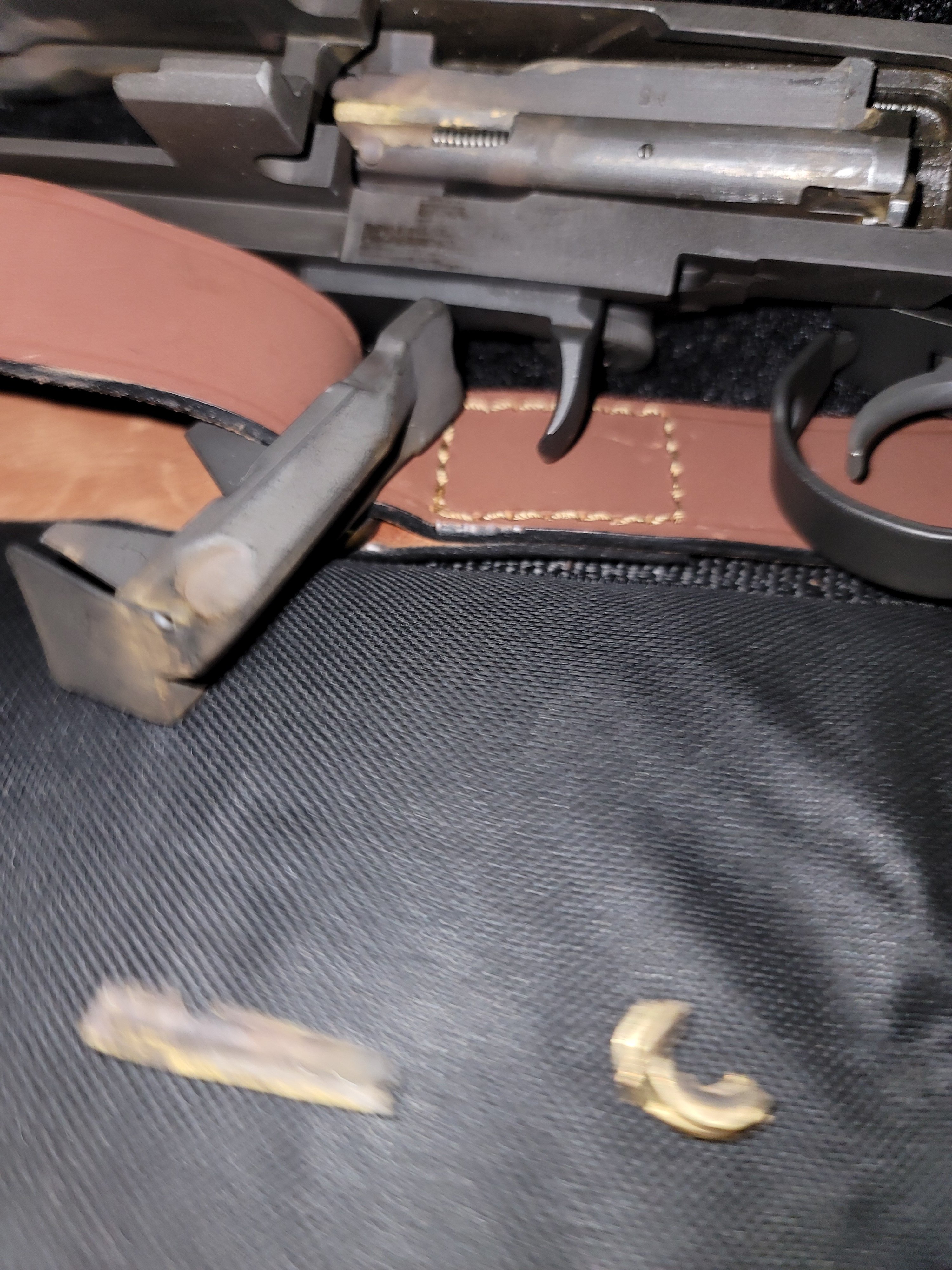

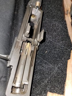

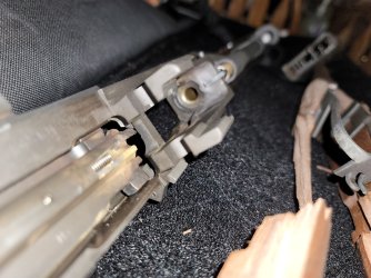

last three rounds out of box. discarded the box after loading the last three in my five round clip. it exploded down thru the mag well . Blew the bottom portion of the bolt thru the magazine. Store bought ammo. I had fired about 20 rounds thru Remington and the last was Winchester. All i found was the head of the cartridge stuck to the bolt and nothing left of the case.
I wonder if it was a case head separation issue?
Based on the design features that both the M1 Garand and M14/M1A share they are made to operate safely within a narrow & specific cartridge pressure. Because these designs are labeled as 30/06 or .308/7.62x51 doesn't mean one can shoot any loading in both cartridges.
