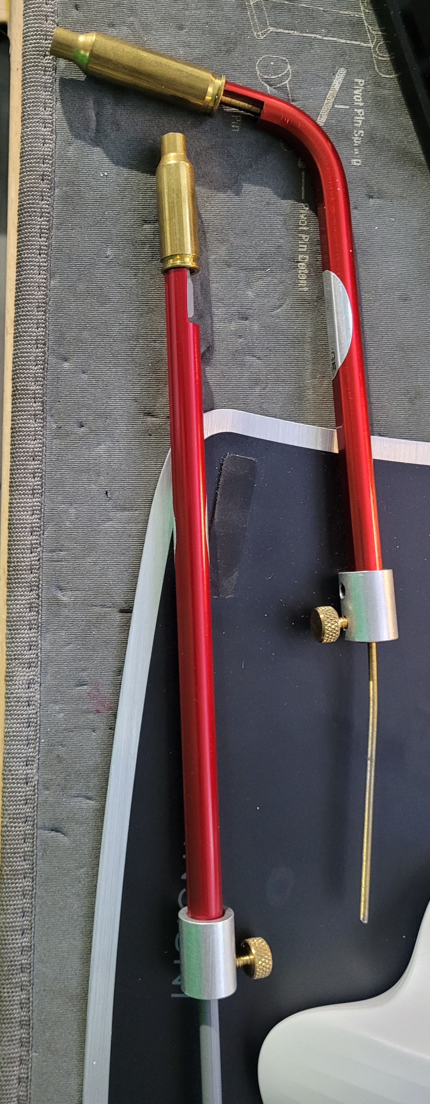

It was all factory ammo that I shot. I have a Hornady OAL setup gauge, and when I used it on this rifle, with the loads that I did, I found that when I inserted the modified case w/bullet into the chamber and then slowly pushed it until it met resistance, the OAL was right in accordance with what Hornady's load data specified. I went back and seated the rounds that I had previously loaded to the length that the manual and the Hornady gauge said they ought to be, and still get the round very tight when the spring closes and loads the round off the mag. It takes two hands on the charge lever to get the round out of the chamber (they are FL sized, but not with a small base die).

I have the one on the left, the straight one. I have already done the check with the gauge. What I measured was within .002 of the value for the OAL that was shown for that 87g Vmax bullet, 2.140. The factory loads are 2.260 +/- a couple of thou.
