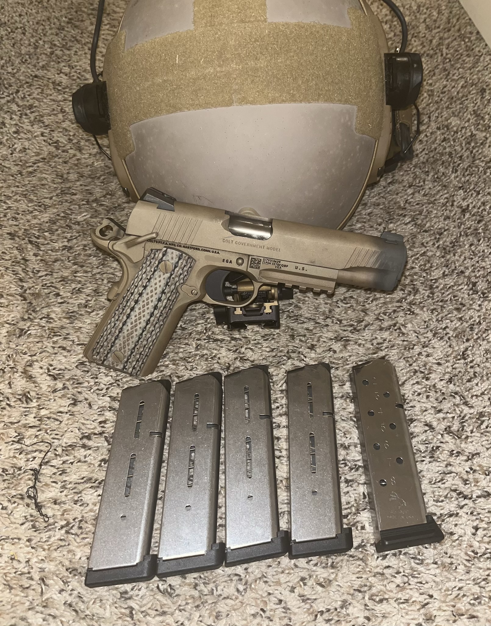

Picked up my brand new Colt M45A1 today from my local FFL and took it straight to the range. I brought 400 rounds of Winchester White Box 230gr FMJ and grabbed four Wilson Combat 47D 8-round mags while I was there.
On the third mag fired through the gun, I experienced five consecutive failures to fire.
  • On failures #1–2:
    • Performed immediate action
    • Confirmed a round was ejected each time
  • On failures #3–5:
    • Carefully ejected each round
    • Inspected primers and found no indentation at all
During those latter 3 attempts:
  • Slide appeared fully in battery
  • I palm-struck the rear of the slide anyway to rule out out-of-battery
  • Re-engaged/disengaged safety and attempted to fire again
Still no ignition and no primer contact.
After that string, the gun ran the remaining ~350 rounds without any additional stoppages.

Also worth noting: I did not clean or lubricate the pistol prior to shooting, so it was running straight from factory condition.
Magazine Fitment (Wilson 47D)
The Wilson 47D mags were very tight on insertion.
  • Would not seat easily under a closed slide
  • Required aggressively slapping the baseplate
  • Or depressing the mag release to insert
I’m leaning toward:
  • New mag catch + new mags needing break-in
  • Possibly slightly tight tolerances on the frame
Aside from the early failure-to-fire string and the Novak rear sight set screw backing out at the range, the gun ran the remaining rounds without issue.
Great shooter overall and a very cool piece of recent USMC history.
Appreciate any input—especially from those with more time on Series 80 Colts.

Their lies your problem. Probably bone dry from the factory. the CZ's i bought didn't have a drop of oil anywhere. Also why is the front of the gun so dirty?
This-some companies really use a lot of preservative. My CZ 75, Shadow 2 and Rami were nasty with lube when new. Never even considered firing before cleaning. I’m betting a good cleaning up front and she’d have ran out the gate.
The business end of the slide is blacked out because that's the leftovers of ALL that Winchester White Box...........
