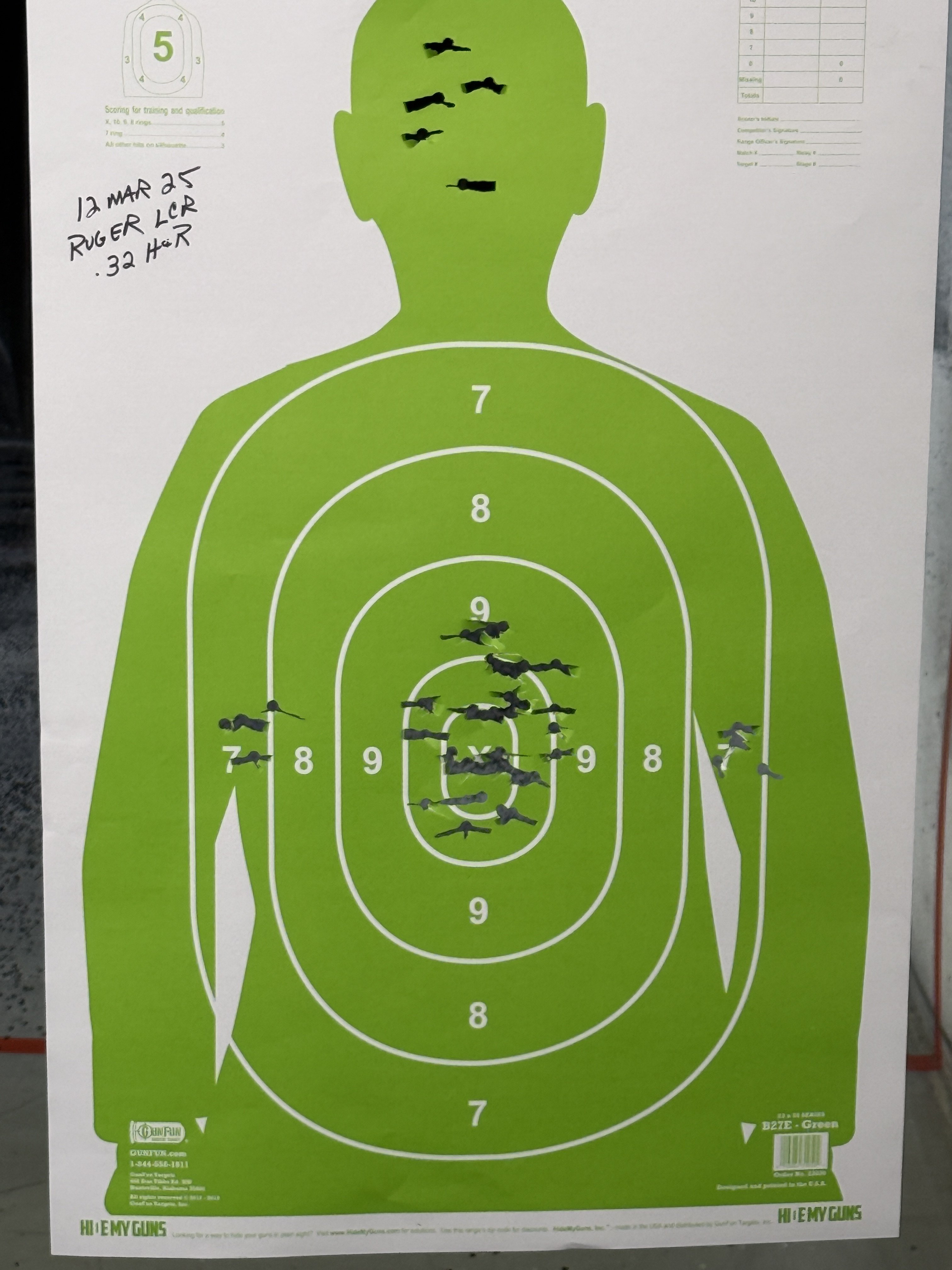

Why am I not getting clean, precise holes in my paper target? I’m happy with the hits, especially with 1.78” barrel, but I don’t understand the rips in the paper.

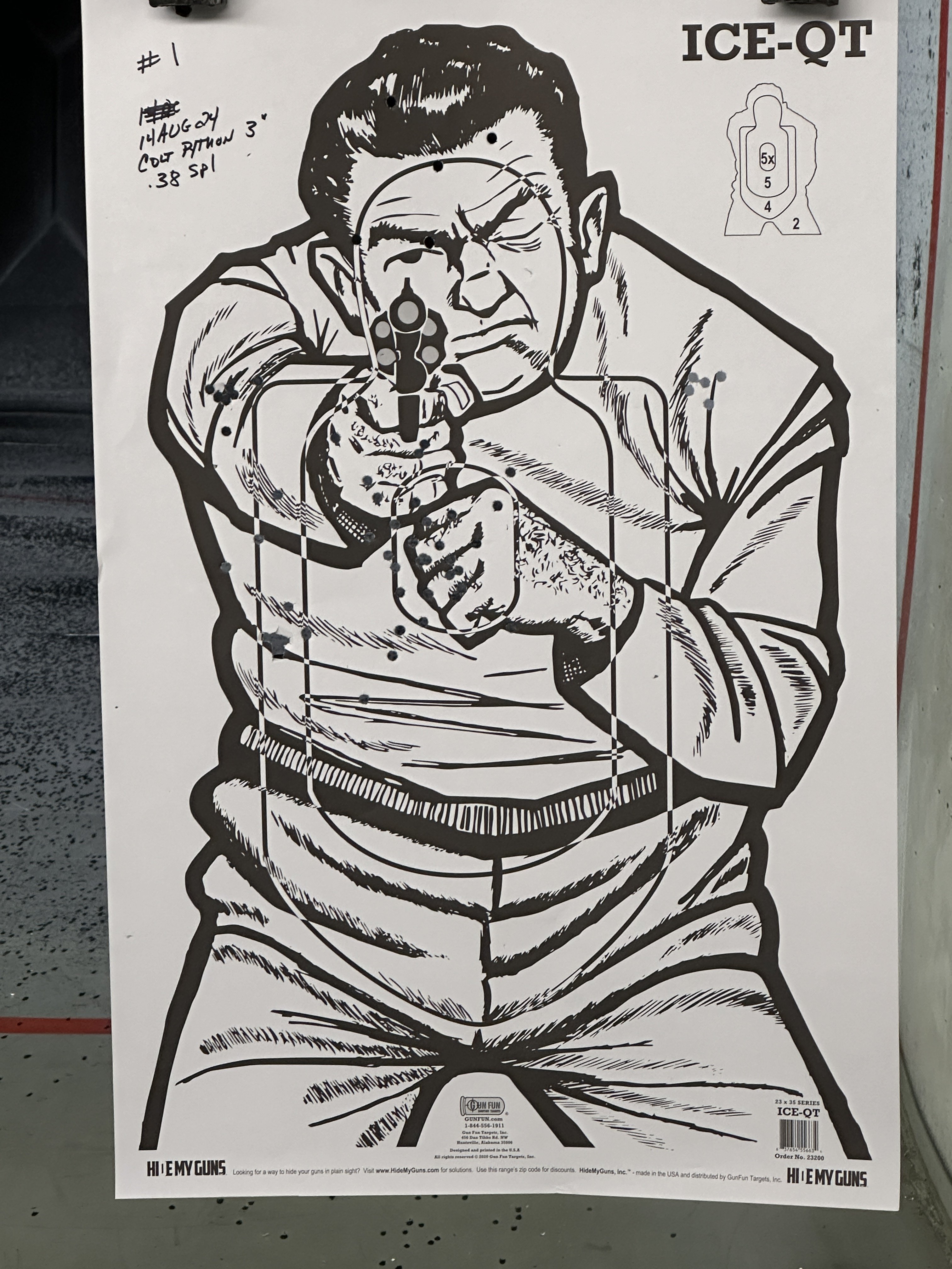

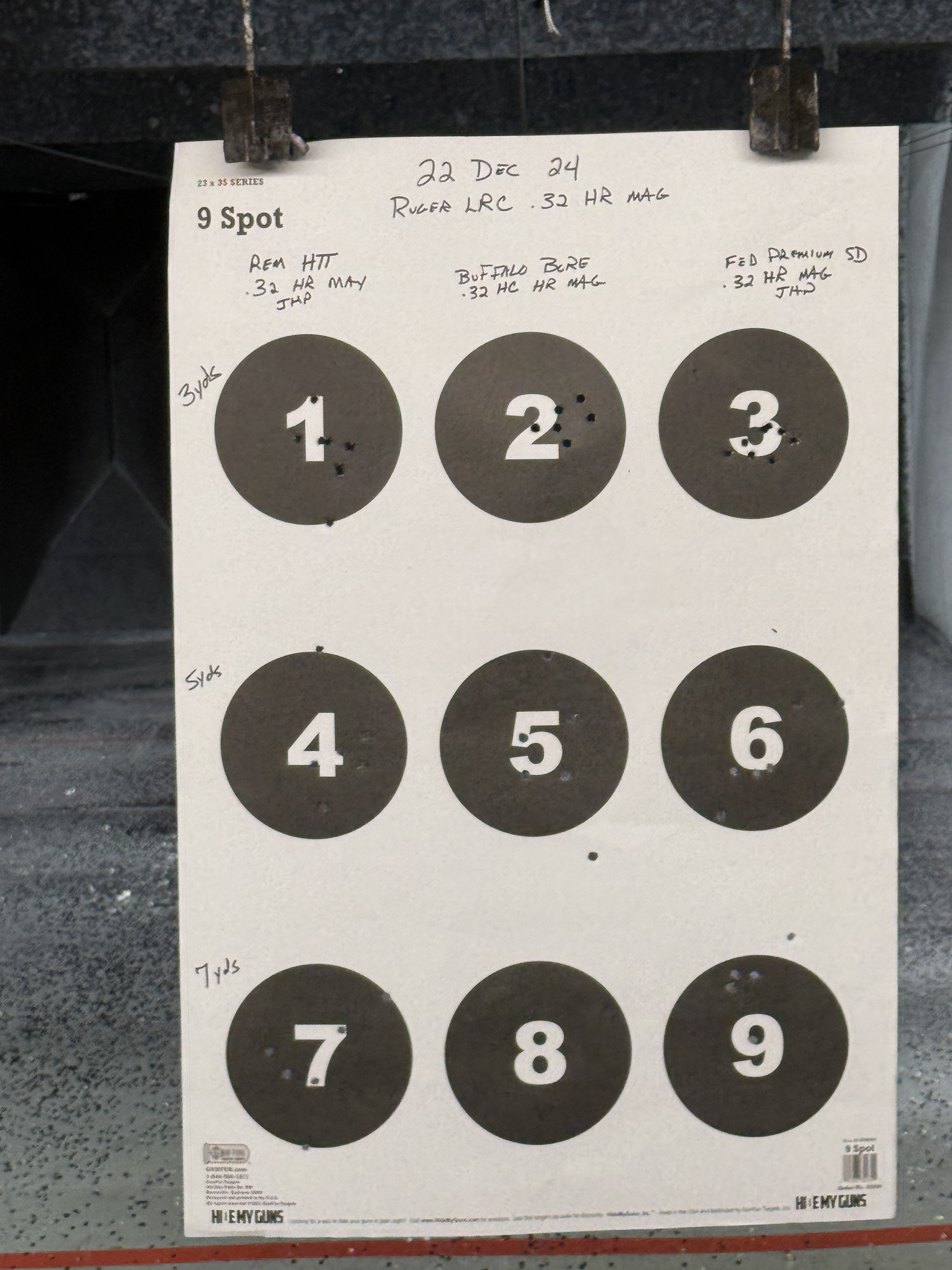

Is that unique to wadcutters, the 1.5-2” tears if there’s no backing? Here is a free hanging paper target, no backing, .38 sp rounds out of 3” Colt Python.
Second target below is same gun as original post in this thread with H&R Magnum rounds, same distances mostly. Free hanging paper target, just as above.

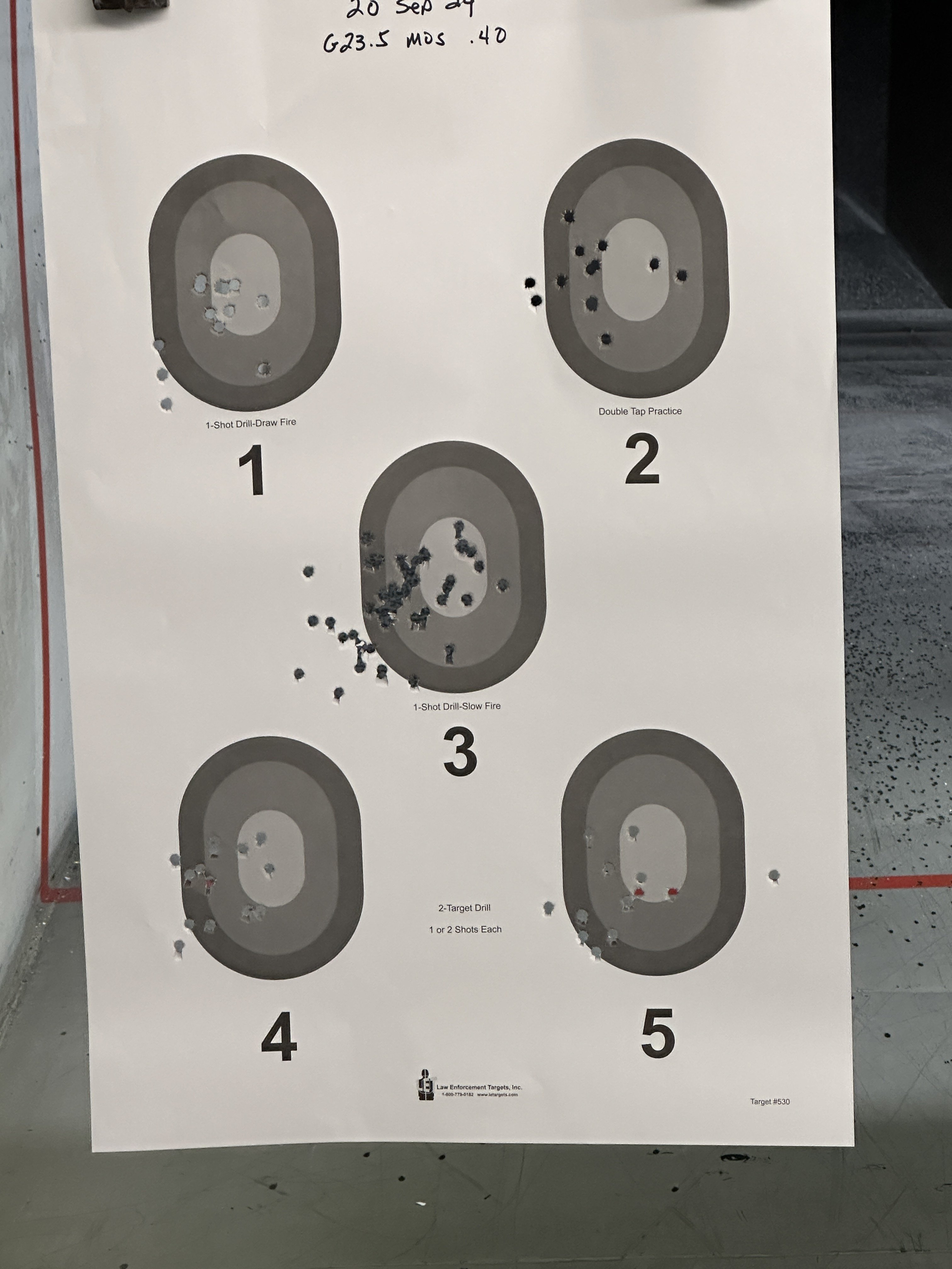

I’ve also had very minimal tearing with other calibers (less than 1/4”, not even tearing really, just expanded holes). Last target is .40 out of a Glock G23. Again, free hanging target.
As mentioned above, I’m going to try to figure out a way to rig a backing for the wadcutters and try it that way. But I’m thinking clips aren’t going to hold the added weight.

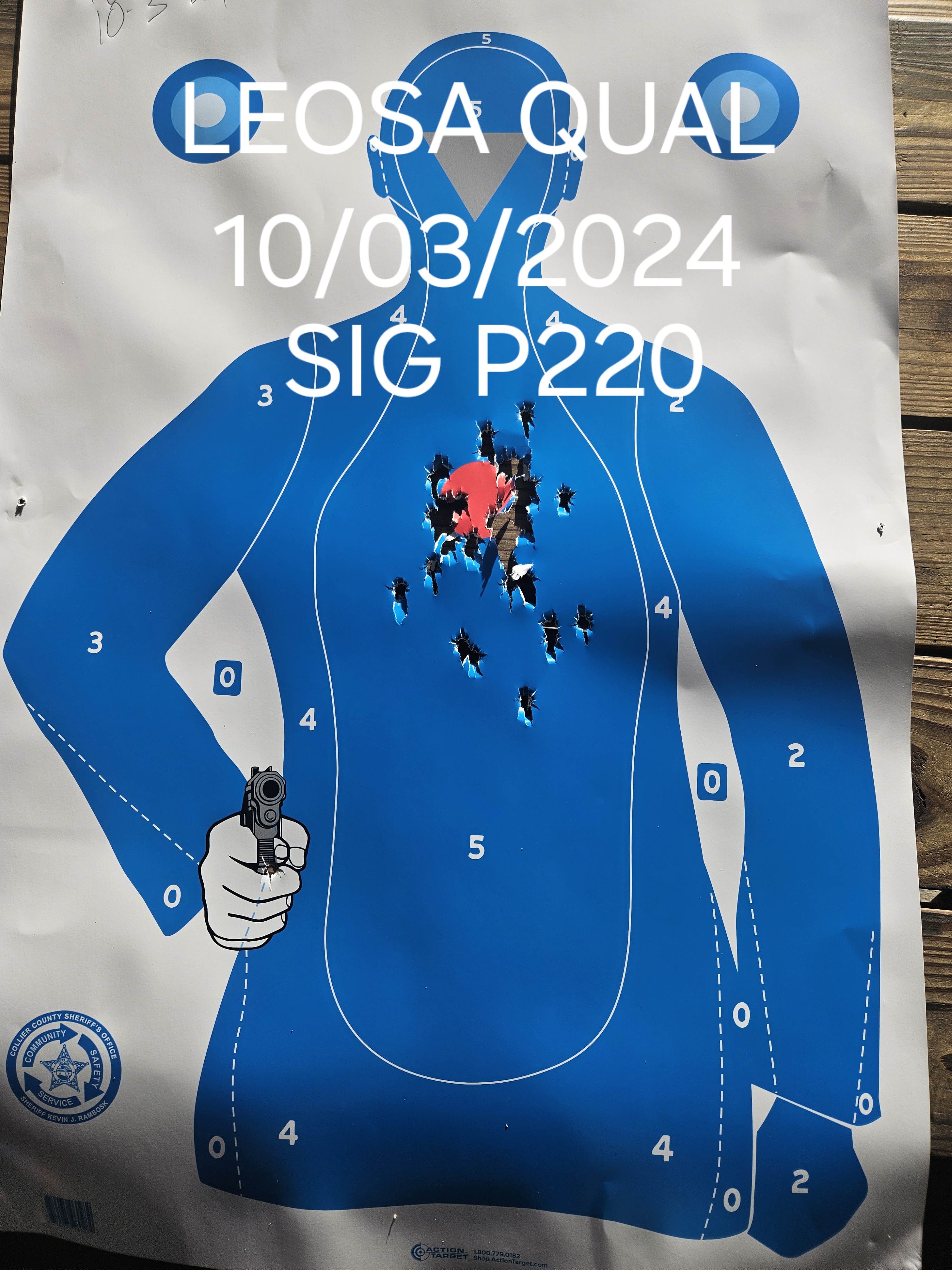

Back in my days shooting wadcutters in revolvers for PPC matches, the targets were printed on cardboard to minimize tearing. Sometimes the scores were so close the distance from the X were measured in tiny fractions so you needed good clean holes in the target. That is after all the purpose of wadcutters. Nowadays I use mostly cardstock targets from Targetsonline. Here is a target using standard paper targets without a backer, shot with .45ACP, note the tearing.
Yep, I understand that completely, the rounds tearing a bit around the edges were bullet hit. I was just curious (so started the thread) why the wadcutters tears look like they’re 2” in length and they are all, without exception, fully horizontal. Much different type of hits on the target it appears to me.
