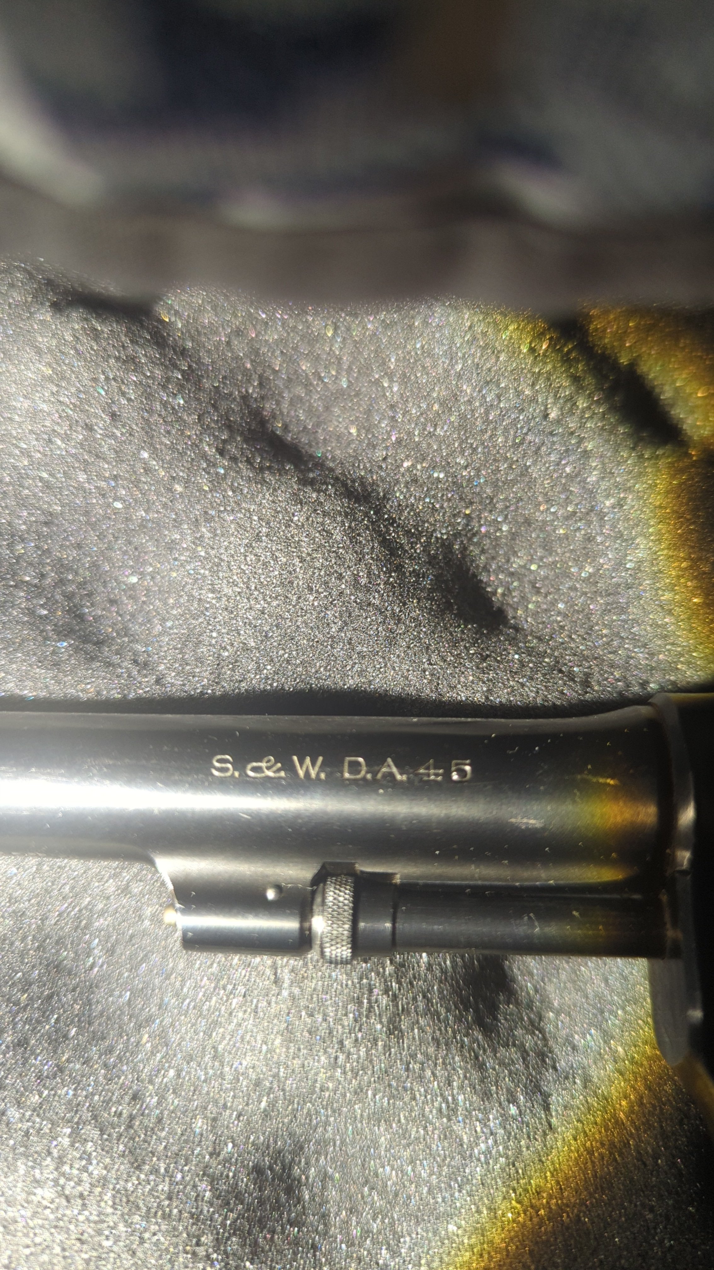

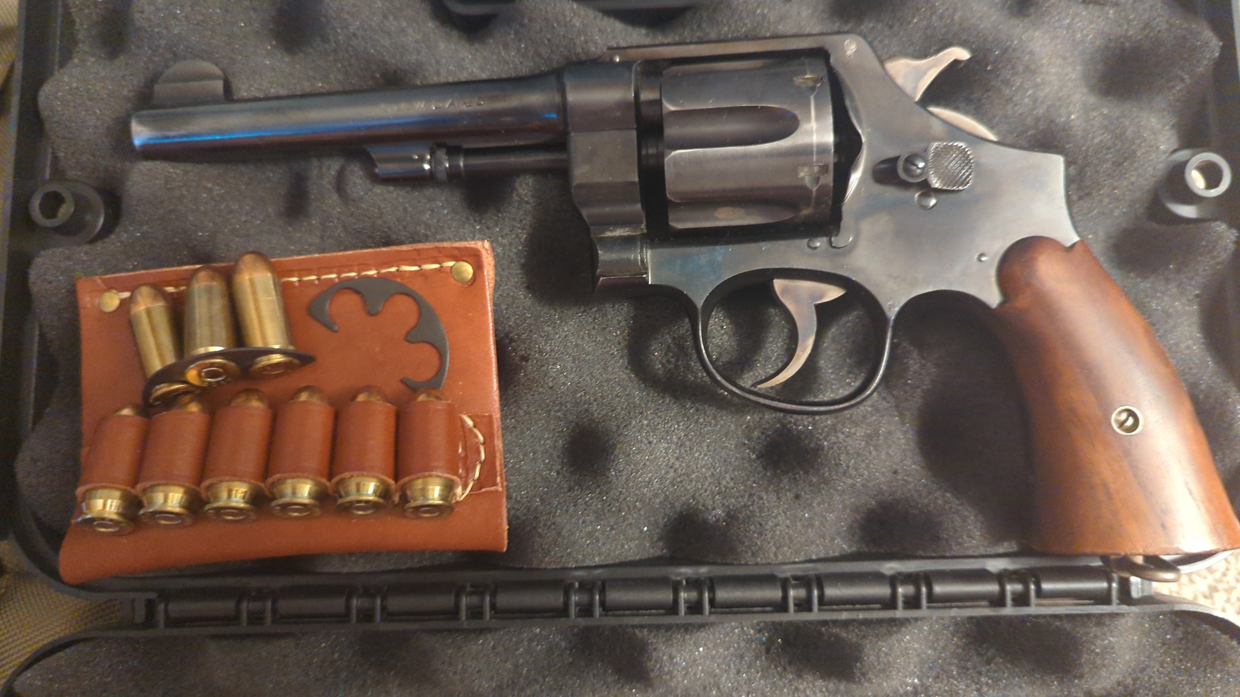

I'll try this again, I have a 1917 Smith & Wesson .45 caliber that was down necked .455 during WW1. It uses half moon clips to fire the semi-auto .45 bullets. It has never been fired as far as I can tell still has the original US Marshals leather holster and after an inquiry Smith & Wesson, there is no history after arrival in 1918 at the Illinois State armory. I got it in 2000 helping clean up a bank that was closing and it was in a cardboard box wrapped up in paper.

Where are you getting this "down necked" thing from? What does that even mean? The .455 bullet is only .002" bigger than the .45acp. Both work fine in the same barrels.
S&W made guns for the U.S. chambered in .45acp. The guns made for the British were chambered in .455.
After WW I, many .455s had their chambers reamed to fit and headspace the .45acp cartridge and were sold in the U.S. Some were even reamed out to .45 Colt.

So, I don’t think this was a .455; if it was, it would say .455 on the barrel.
Someone may have cut down some .455 brass so they didn’t have to use clips; this is not uncommon., as .45 Auto Rim brass was not easy to find, and moon clips would get lost or damaged.
Are there any symbols, etc stamped on it, particularly on the barrel?
There also might be some stamps that are under the sticks (grips).
