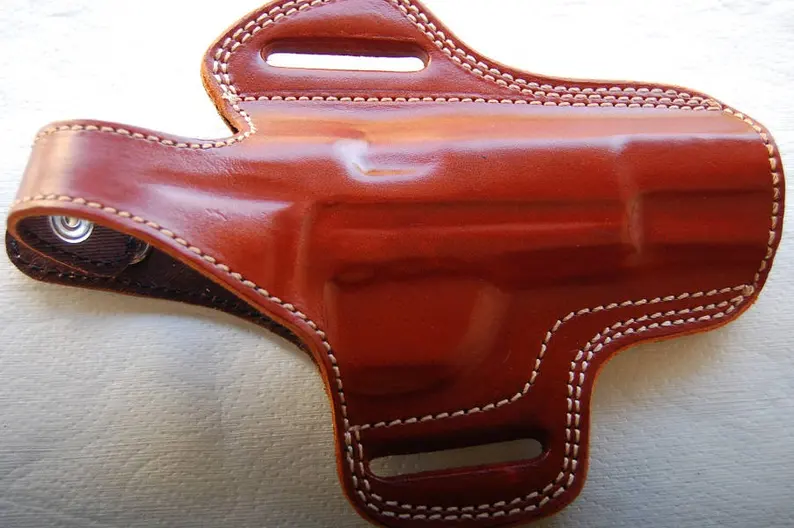

I really like mine. I am looking for a good, OWB, leather thumb break holster for it. Old School Cool, not a flap though, like this:

I looked all over to, but I ended up buying the Bianchi 7001 nylon form fitting holster. Very tight initially, but after a couple of weeks, it's moulded itself to the gun. The draw is very smooth, very secure when worn.

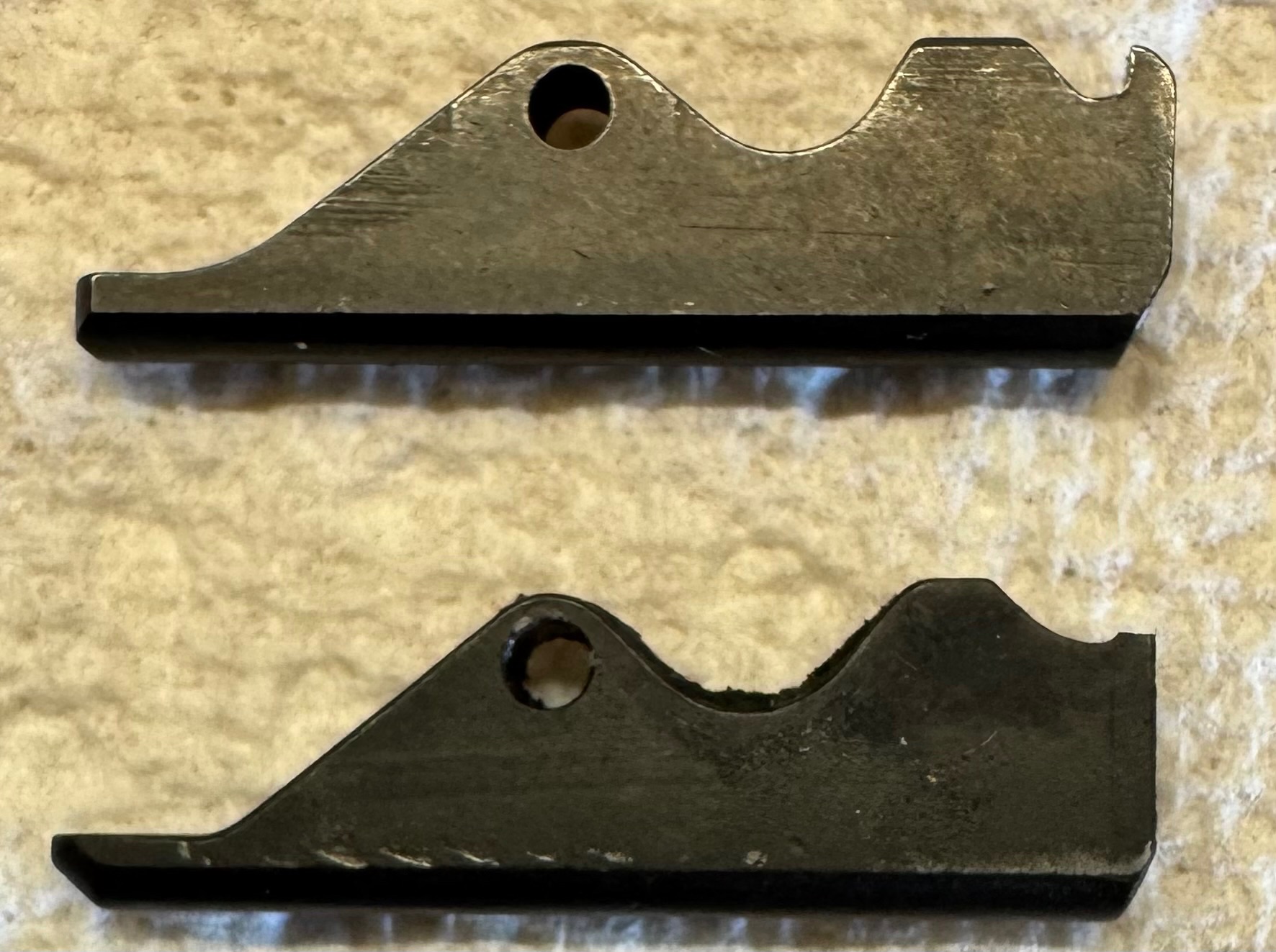

I purchased my SA-35 back and love the gun dearly, it fits great in my hands and shoots well.
But I recently hit approximately 500 rounds and experienced FTE issue which was due to the claw on the OEM extractor having sheered off.
Thought about sending back in to SA for warranty claim, but after doing some research, I learned this is a weak part even when replaced by SA. So I ordered an FN made part along with a new spring & pin.
Quick and easy install, the gun now operates flawlessly.

Luckily Nelson Ford is nearby, plan to have him do a trigger job, fit a BHSpringSolutions match grade barrel and replace any other SA OEM parts that are known problems like the extractor.
