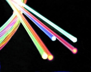

0.060 sized, i had replaced one from red to green, for me, the green is way better. (i have the same gun)
how about Yellow..??? close to white......for you... maybe..????
in this kit, they also have orange....
check on line on how to replace, very easy, i used a pencil type soldering iron, safer than a cigarette lighter...
You shouldn't need to tap out the oem fiber optic rod. Carefully cut or break the rod in the middle and push out both ends. I believe the rod size is .060/1.5mm, at least that's what mine was on my 4.25" Ronin.
If you do an internet search using "replacement fiber optic rod for gun sights" you should find multiple sources, including Amazon and Ebay. Vendors offer many different sizes and colors of fiber optic rod. Most come in inch length rods, some come with multiple colors included in a package. Red and green are most common but I've seen some vendors offer blue, yellow, orange and amber. I don't think white will be easy to find from firearms sources like Midway, Brownell's, etc
When you install the rod, use a butane lighter held adjacent to the rod end, to gently melt one end of the rod into a clear and rounded bulb. Don't get the flame to close to the rod or it will blacken. Don't use a match which can leave soot on the bulb. Cut the rod about 1/8" longer than the overall length when in the sight channel. Slide the rod into the sight from the back of the sight which will make heating the other end of the rod easier. Trim the rod down to about 1/16" protruding and repeat the heating process to the front of the sight. Novak's site has similar instructions. They carry common red or green replacement rod.

Thanks, man. I appreciate it very much. Bright yellow might work. As you know the rear sight has white dots on it. Seemed like white was appropriate, but bright yellow is worth a try!
Follow up. Received the new fiber optic, installed it and I like it! Very visible (for me).
