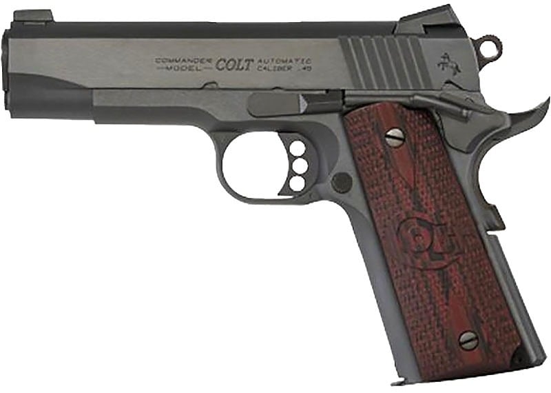

I like the. 38 Super and wish it was more popular.
I wish SA would do their Garrison 4 1/4 in it like Colt does.
