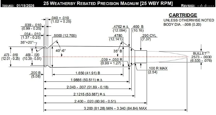

All Weatherby RPM cartridges have a rebated rim of .473" diameter with a .500” case body. These are basically the .284 Winchester case head and base dimensions. This case design allows using standard 30-06 Springfield/308 Winchester bolts but have a larger case capacity at a given case length.
With an overall length of 3.34", the 25 Weatherby RPM is a standard/long action length cartridge that, according to Weatherby, provides magnum performance. The new 25 Weatherby RPM is designed with a focus on shooting heavier, high-BC bullets: the recommended twist rate is 1:7.5" and the case length of 2.4” results in ample room over the case (.94”) for those long ogive bullets.

SAAMI Specs Of The New 25 Weatherby RPM Cartridge
