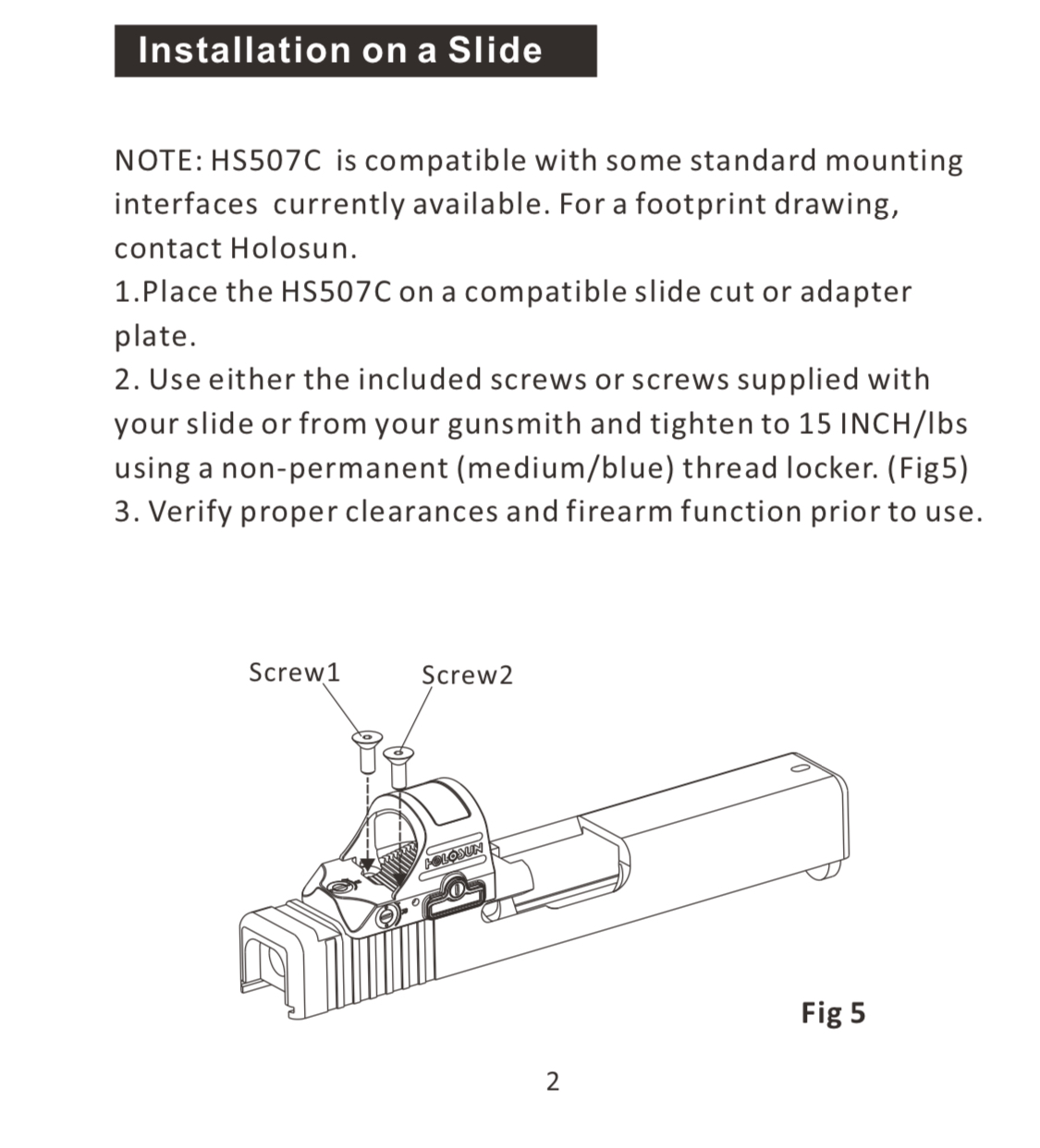

Straight from the Holosun 507C X2 manual.
I always use a torque wrench, but that’s not been my experience with pistol red dots. and I run a lot of them. Just sayin’. Clearly your mileage varies.
Well, we can go over it again, but almost all manufacturers recommend blue Loctite or the equivalent. Probably because they want a little extra insurance and they probably don't expect most people to actually install them correctly using a torque wrench.
