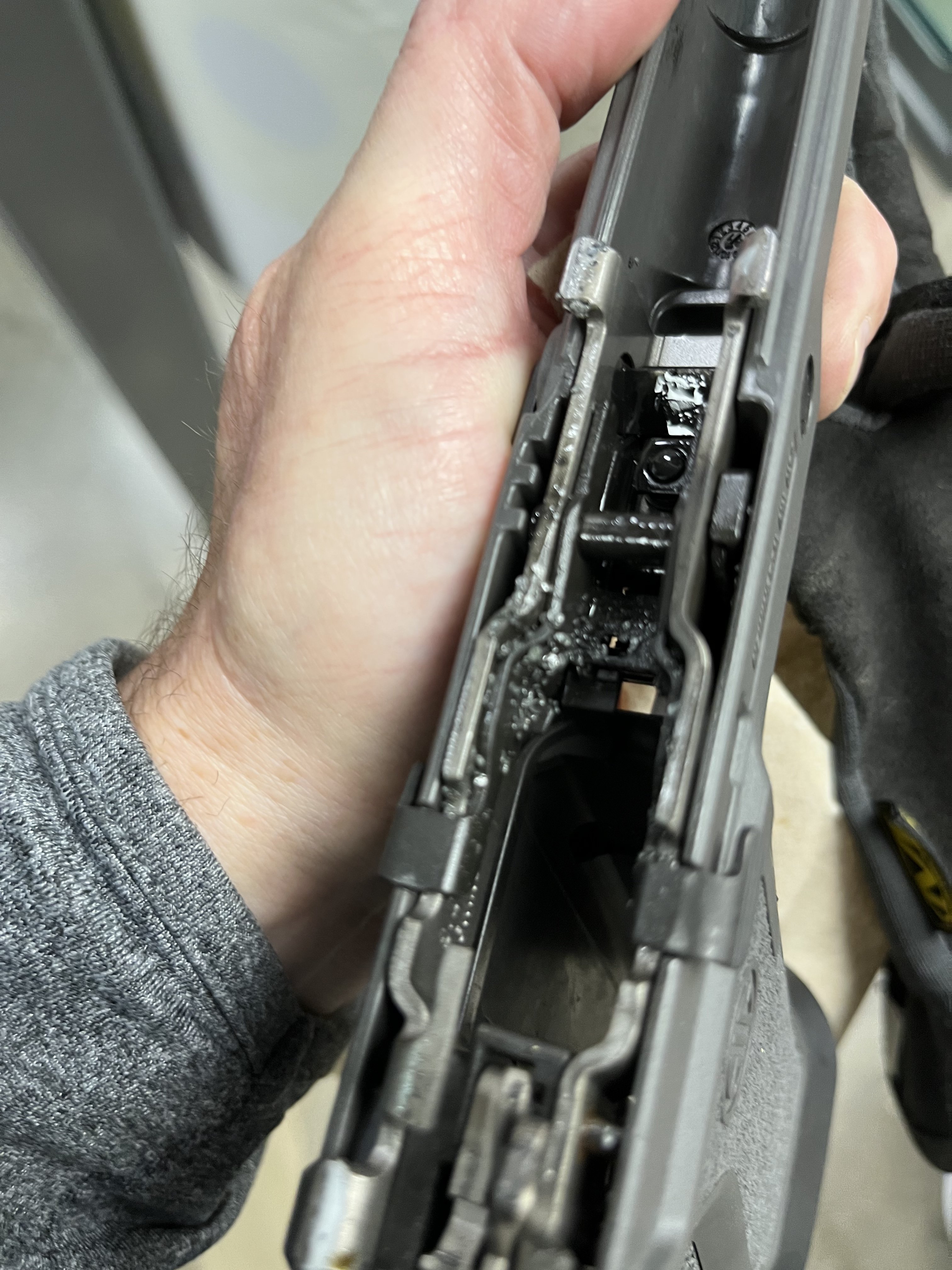

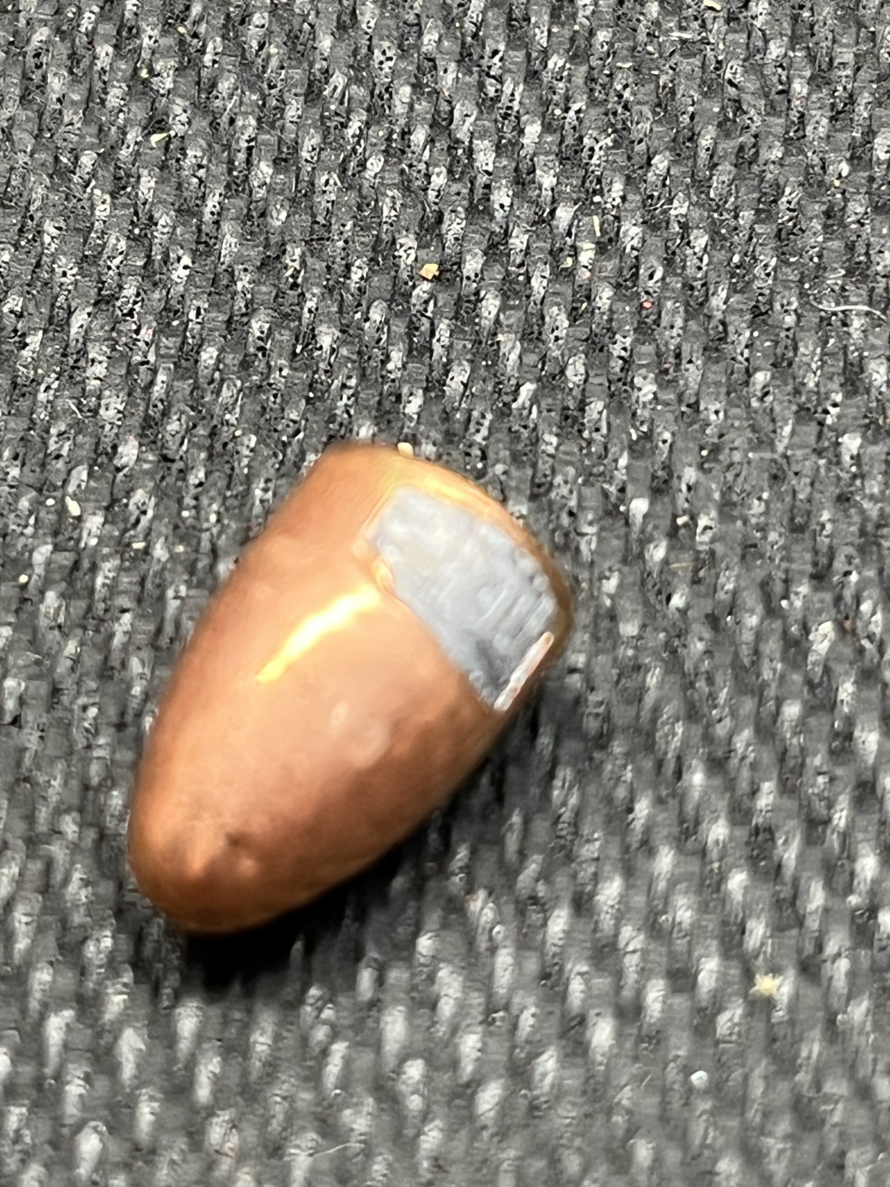

I was at the famous range competition with @SimonRL last go around and had some issues.
New gun, the Sig 320 Max Michel
Had about 100 rounds thru it for the day.
Fired a round and it jammed.
Dropped mag
Cleared an empty shell that was stuck in chamber.
Insert new mag and drop the slide
Wont go into battery. Slide half open on chamber.
Repeat the mag, slide, clear chamber..
still no battery.
I then disassemble & Take slide off.
Trigger housing full of debris … hmmm.. what the heck.
Clean it, re-lube the gun, and reassemble

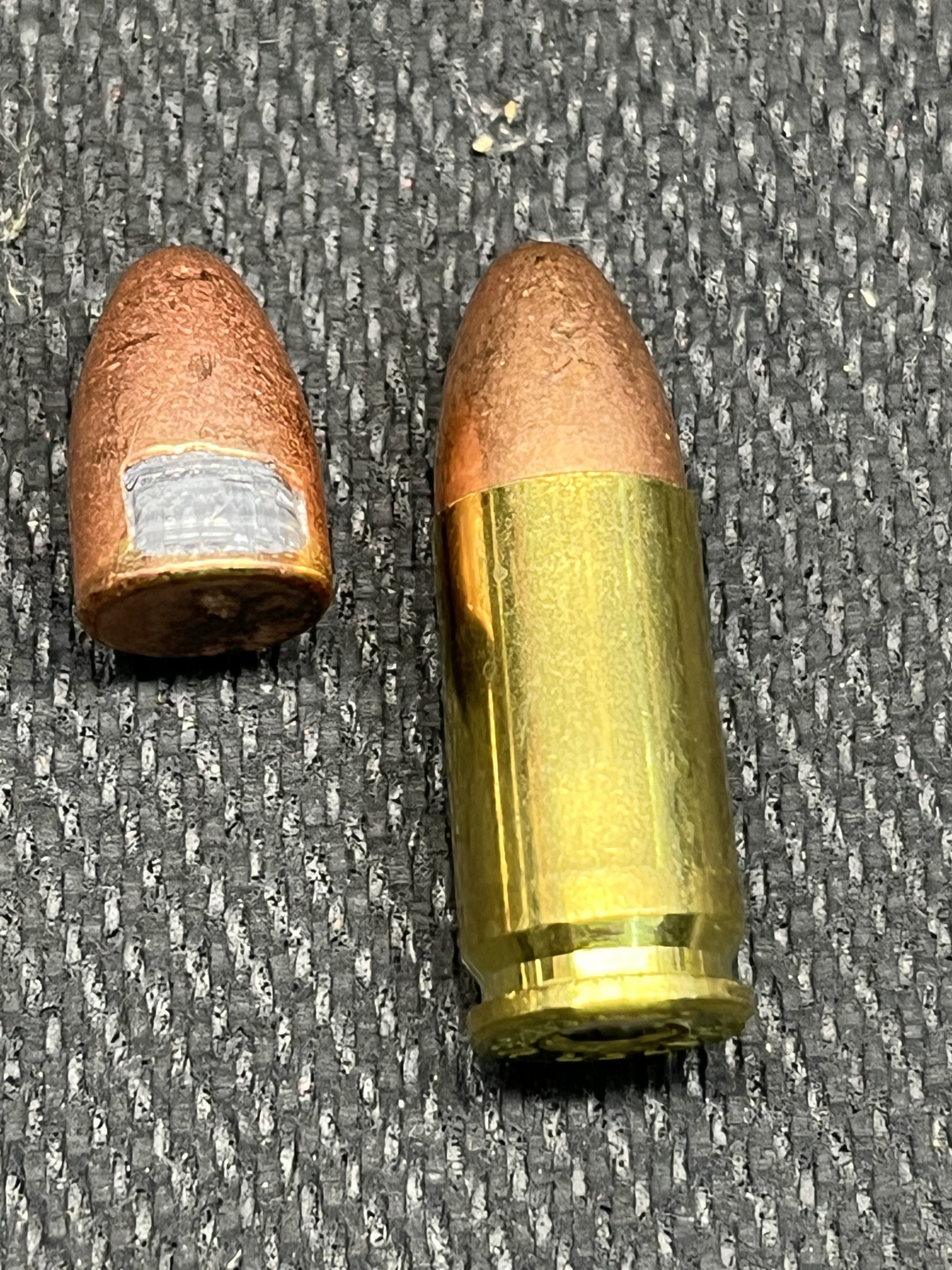

Insert mag, drop slide and wont go into battery. Pull slide back and a squib drops out of the barrel. 😳
The bullet was jammed in the barrel after where the round normally sits 😬😬😬
Guess all the gunk in the lower was the powder and primer
First squib ever in tens of thousands of rounds, prob more like almost 100k rounds over 30 yrs.
Real eye open.
Thank god the pistol didnt go back into battery. End result would be no bueno.
Never too old to learn a life lesson.
Edit: blazer brass 115gr in 1000 round bulk case

Yikes! I'm glad you avoided disaster. Was there a chunk out of that bullet that caused it not to seal properly in the case? Did you notice anything odd about the recoil on that shot? Once you cleared the malfunction, was the case cracked or anything?

I’ve used Blazer 115hr 9mm for years.
I bought 10,000 rounds bulk way before Covid. 10x1000rd boxes. $149 box
I was shooting 1500-2000 rounds a month pre covid.
This was my 7th box in.. about 3/4 thru the box.
Prob went thru 20 boxes in the yrs prior.
This was my first issue in 7 pistols

*ANY* range-fodder grade ammo has the chances of offering up an occasional squib/under-load.
115 gr. WWB and brass-cased 115 gr. Blazer without a doubt make up the bulk of my 9x19 rounds sent through both of my training/range XDms (a 4.5-inch at over 55,000 rounds fired and a 3.8 Compact at 25,000 rounds fired) and my EDC 3.8 Compact (~13,000 rounds fired). Add-in a couple of my other 9mm pistols, and I wouldn't be surprised if the sum total of these surpassed the 100,000 mark (which, while seemingly high, actually rounds out to a very reasonable 10K rounds per year, spread over the last 10 years that I've been in this sport/hobby).
I've seen plenty of issues with the bullets, case, and primer, but I've actually been tremendously lucky and have yet to suffer a squib.
Each of the issues I've seen corresponded directly with increased rates-of-production due to a period of national shortage. Actually, in the winter of 2012, a group of very well-known and very highly-regarded local instructors -also nationally competitive shooters who were at the time sponsored by CCI/Blazer- told us students to either avoid buying 115 gr. Blazer brass altogether for the time being, or, if that's the only thing that we could get, to be sure to visually inspect each individual round before inserting into our magazines (i.e. avoid speed-loaders), ostensibly due to a spike in quality-control issues that caused misshapen bullets and improperly charged cartridges, as seen in their own use.
I still shoot plenty of Blazer Brass. I've got about 2K of the 115 gr. (my current favorite are Magtech, in this length) and maybe 500 rounds of the 124 gr. variety left (I have come to prefer CCI's "Lawman," in this length). And really, I'd have no hesitation to buy more if the price is right.
Range-fodder really is just range fodder. It's all about the same, and I don't lose any sleep over it. :) I'll shoot the cheapest thing that functions my guns and gets reasonable POA/POI with my zero.
