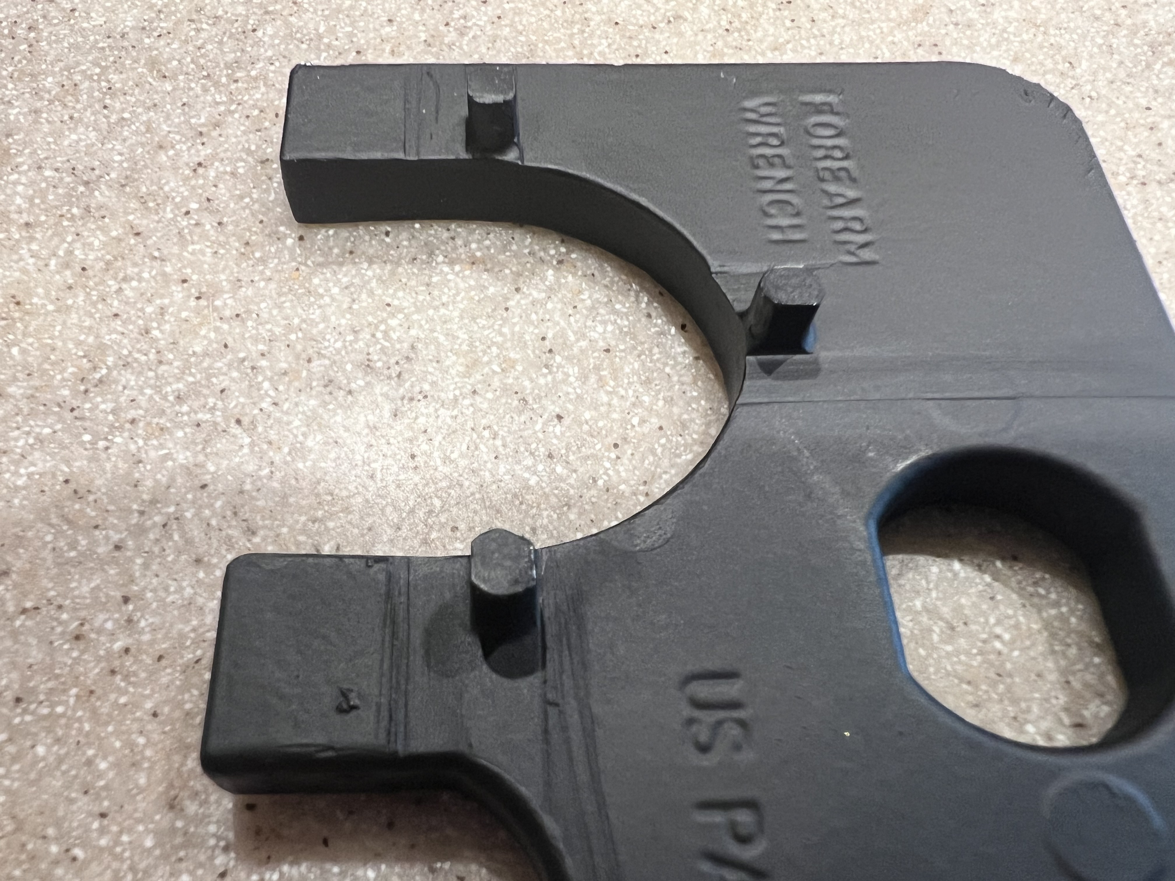

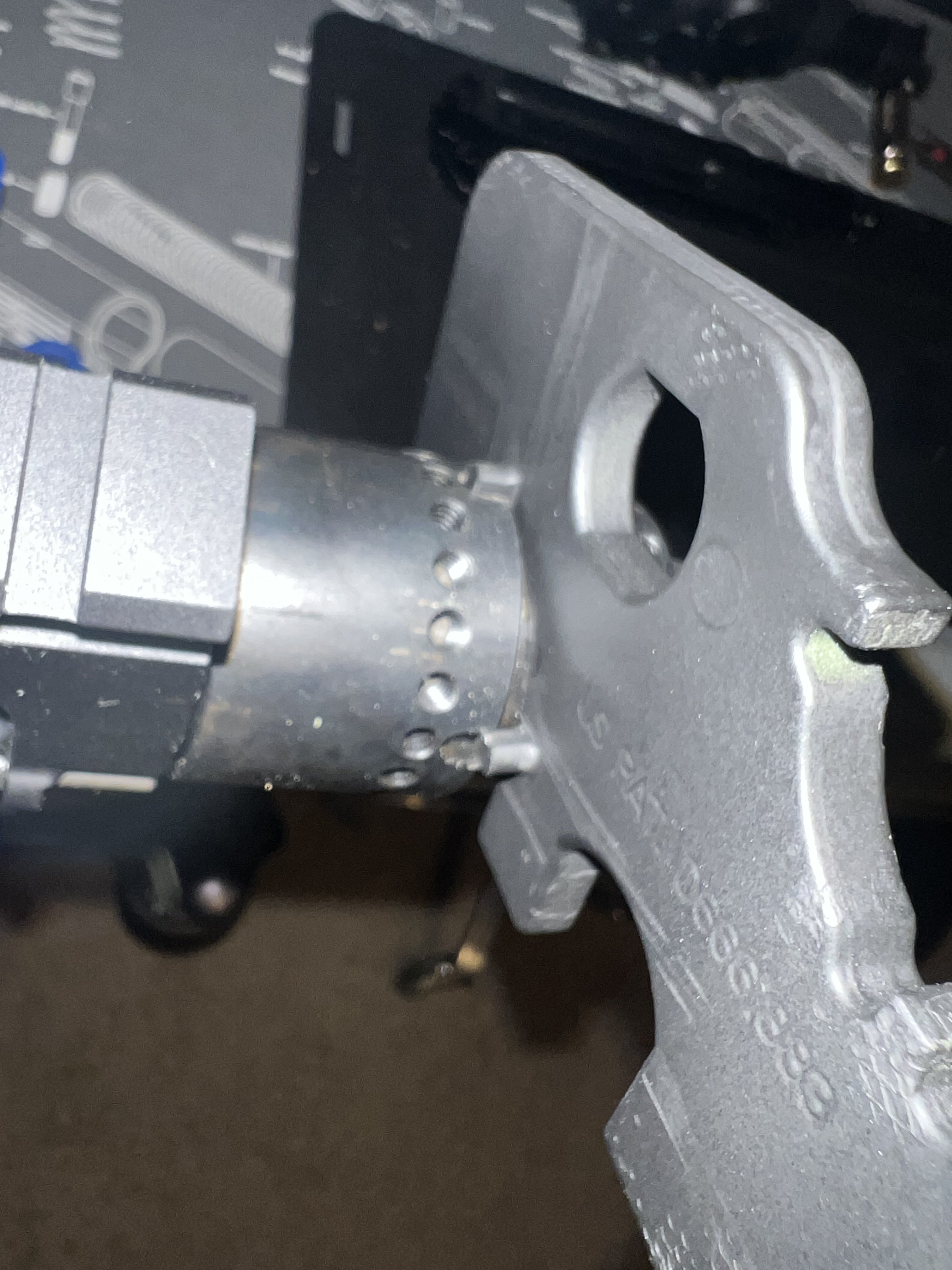

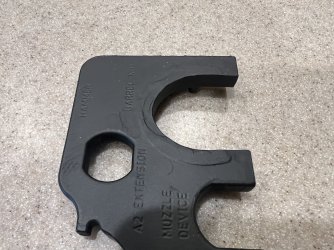

Sadly, I contacted Springfield about what wrench is needed for the Victor 308 barrel nut three weeks ago but got no response. I ended up filing and dremeling my Tapco wrench to make it fit.
