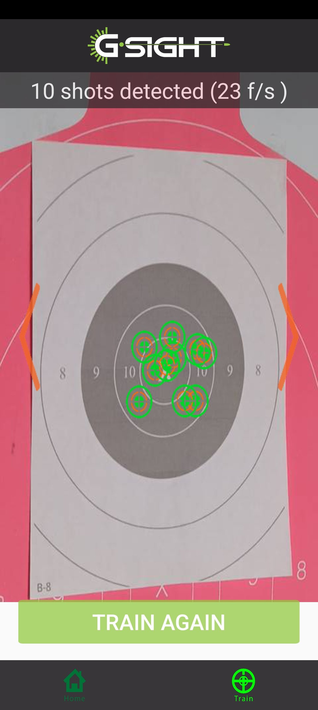

Hi,
I have been looking at the G-site ELMS, for when the firing ping bumper wears out in my cartridge, good to know it is more accurate than the Strikeman.
The ELMS comes with extras, o-rings, batteries, and back pads. Ordering replacements make the units last forever.
