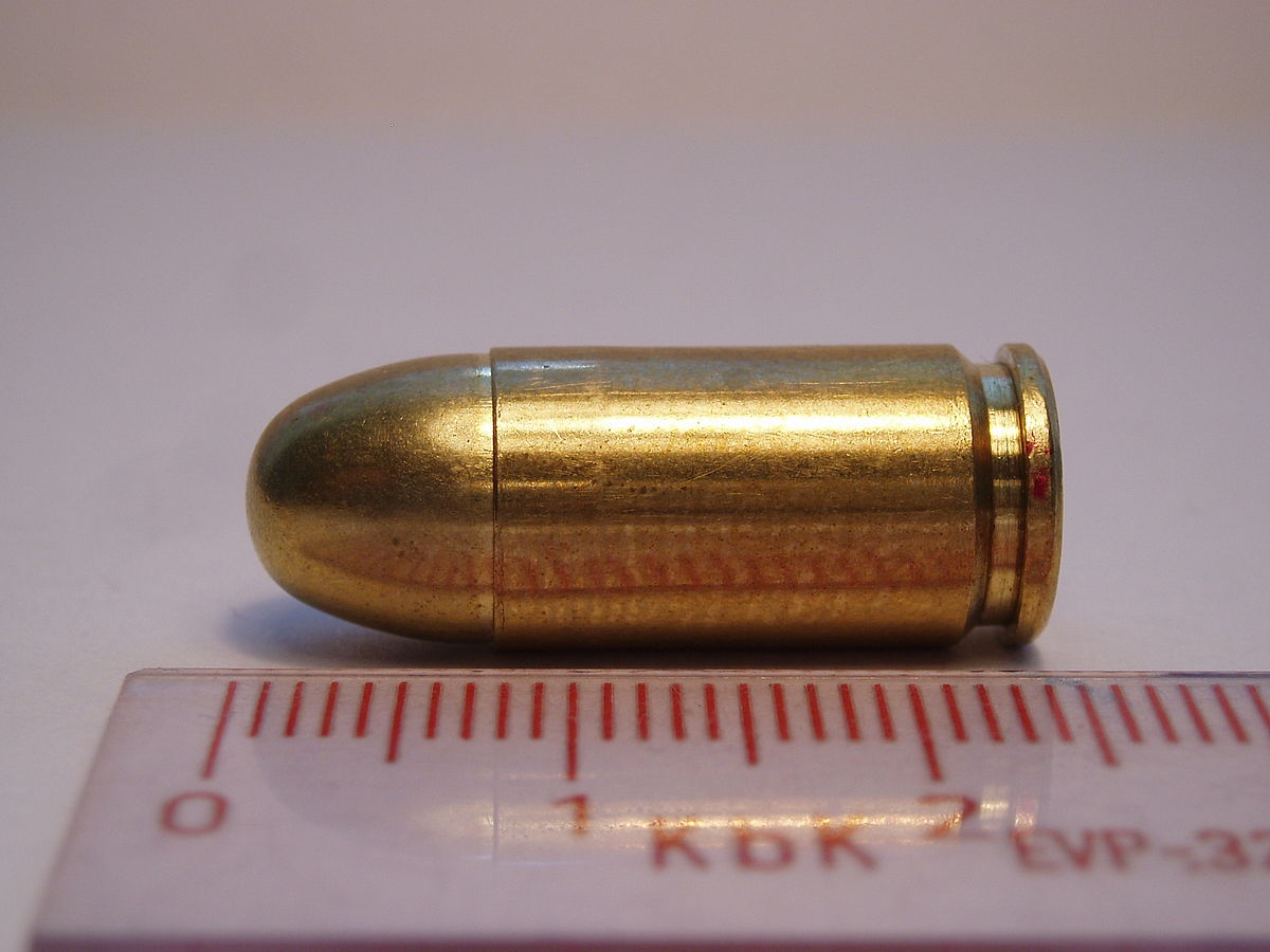

I didn't see anything about how they solved the tubular magazine of round nose bullets (possible) dramatic situation.
Maybe there isn't enough recoil for it to be a problem???
We're told to use RNFP bullets with the flat point being larger than the primer to prevent inadvertent ignition in the magazine tube.

Lever actions in .44 Mag, .357 Mag, etc are more or less idiot-proof because most of that ammo is loaded with flat point bullets. Flexible tip bullets also protect the ignorant (and the rest of us bystanders).
But a 9mm lever action (or any other 9mm) is a different story. I would guess 95% or more of the 9mm ammo made is round nose FMJ. And that's what the people we see at gun shows and public ranges who leave us shaking our heads are going to have...and it's likely what they will use in one of these rifles.

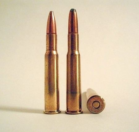

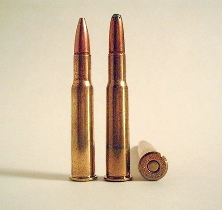

IMHO the fear of exploding tubular magazines is way over blown, much like rimfire unreliability but that's another story. A few years ago (20+?) Shooters Bible, Guns Digest or some such did a story of trying to get a tubular mag, to explode. I won't try to share any info from it as I don't have it available and due to age and faulty memory. As I recall very informative and worth the effort of finding if you love lever actions. Much of caution of expolding mag tubes come from the days of people loading 30-40 Kreg bullets into 30-30 cases. Defiantly more recoil from a 30-30 than 9X19. 1716123993065.png VS 1716124041950.png
In today's "let's sue em till the cow come home" world, especially in the firearms industry, if Tayor's not worried about it then I'm not. I would still pay attention to what bullets I used for reloads, but then what to hell do I know.

First off, that heavy, lever action rifle isn’t going to have enough recoil to get the inertia high enough to set off a primer…additionally, that round profile 9mm bullet isn’t pointy enough to concentrate what little force there is.
The whole tube thing, with this rifle, is a massive nothingburger.

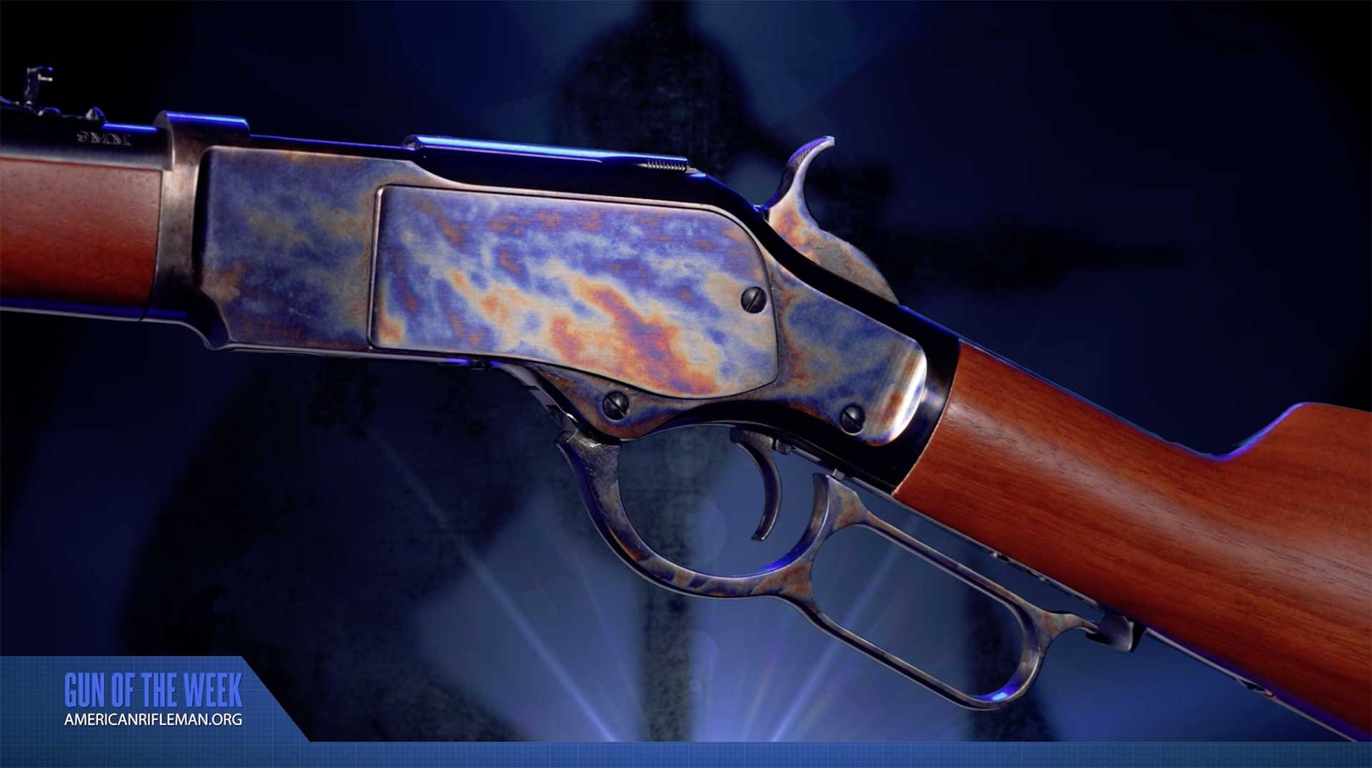

The TC73 is equipped with an 18-inch carbon-steel barrel and has an under-barrel tubular magazine that holds 10 rounds of 9 mm Luger. Like the original Winchester 1873, the TC73 is loaded through a gate on the right side of the receiver.
The Taylor's & Co. TC73 is made entirely in the USA, and the suggested retail price is $1,799.
