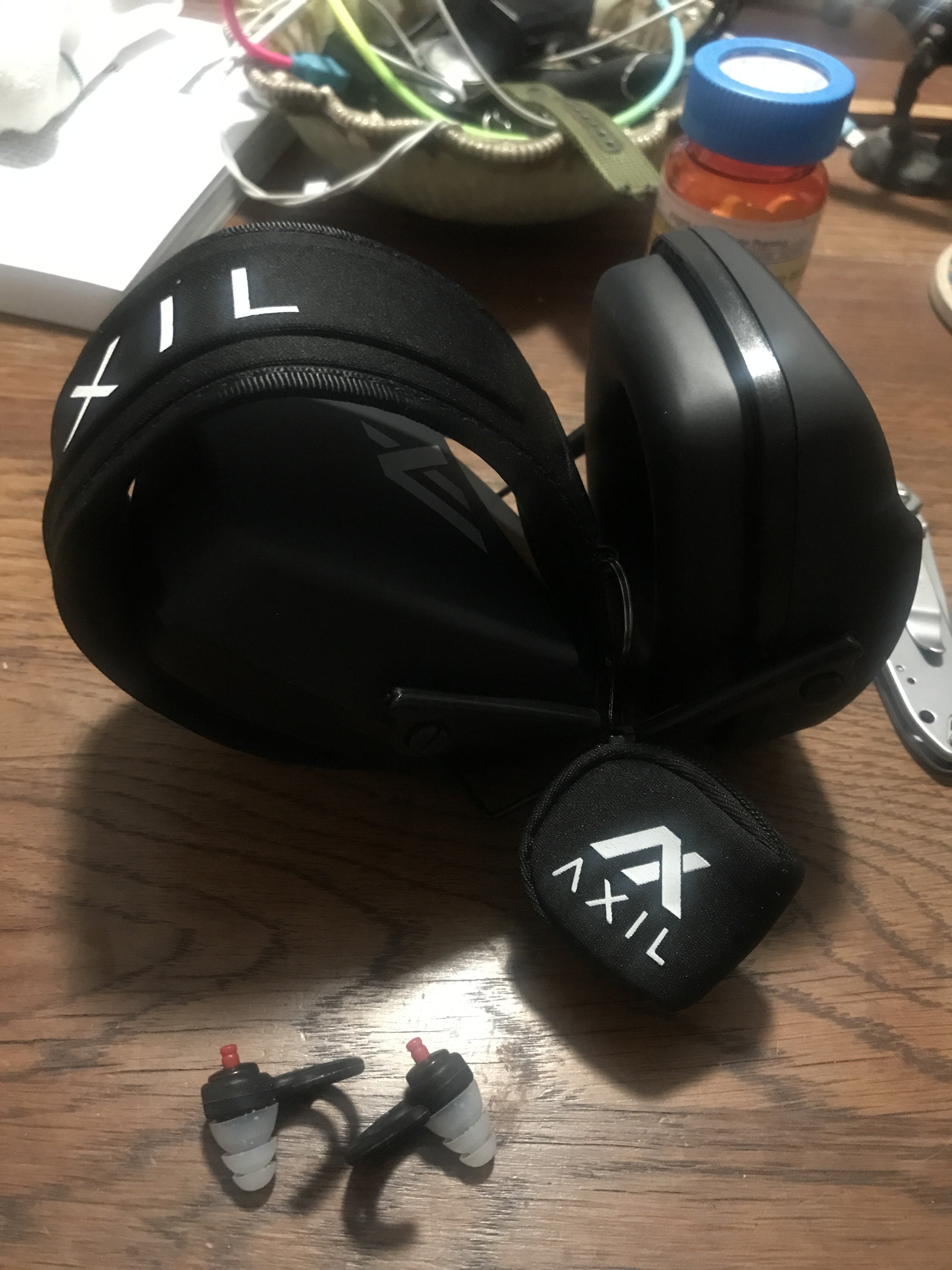

I have several pairs of hearing muffs. Bpuhjt a couple pairs of Caldwell electronic muffs but they did not seem to hold up well. The last two I purchased were Walker Game Ear and Walker Razor
Replaced batteries with Eveready Lithium batteries which are 100% guaranteed not to leak. They seem to do a decent job for mowing or at the range.
