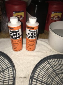

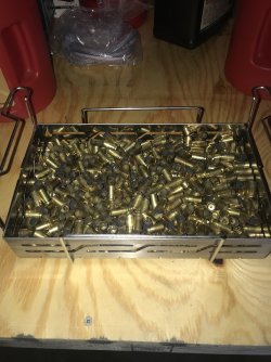

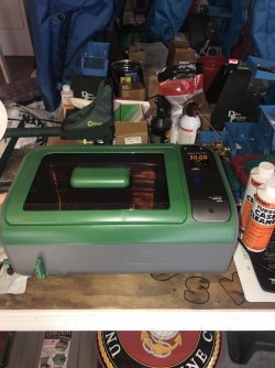

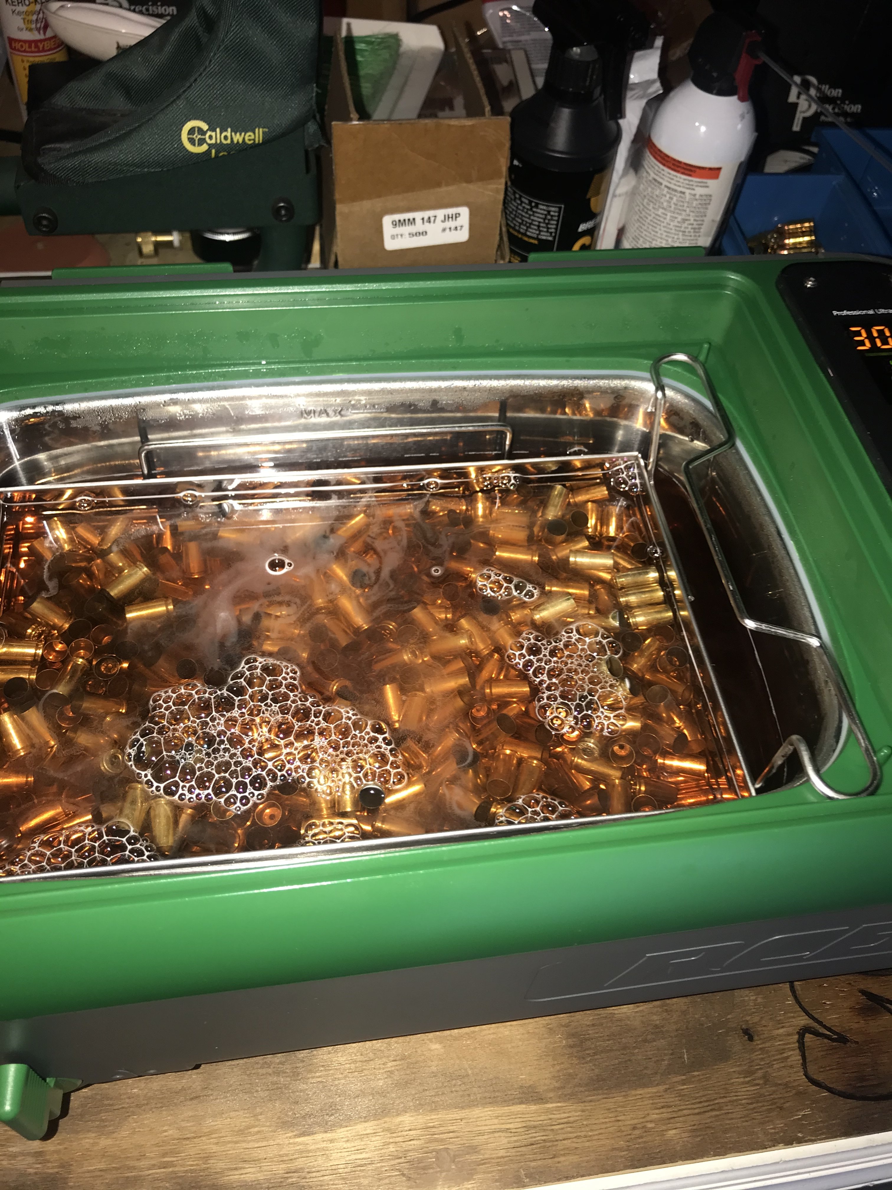

I use this ultrasonic cleaner for my Brass. I would imagine I could use it for firearm parts also. It works great on brass. I just find the solvent very expensive
