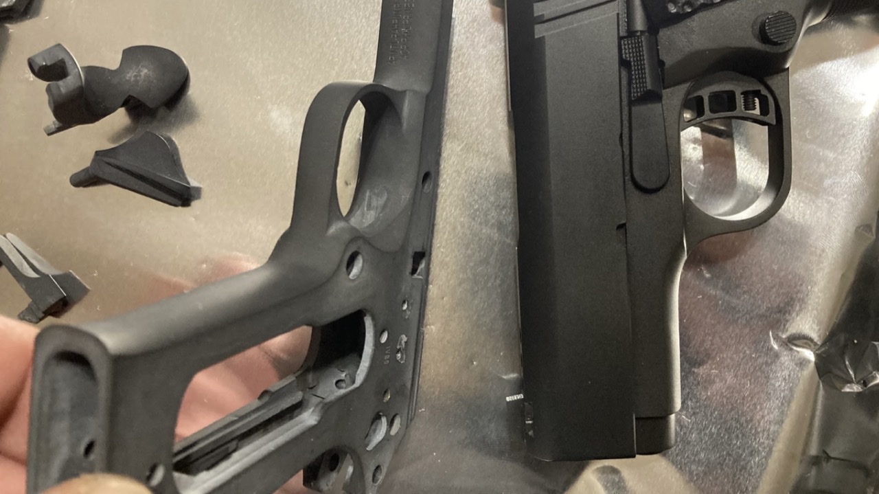

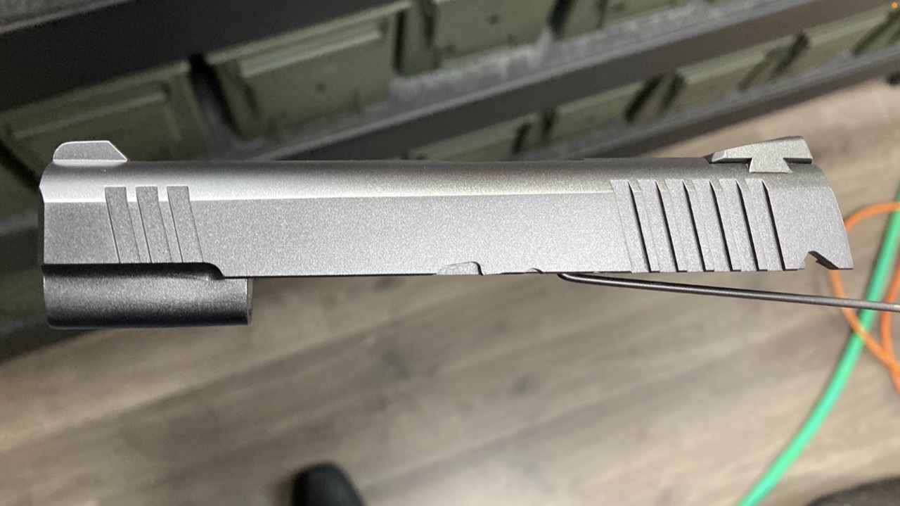

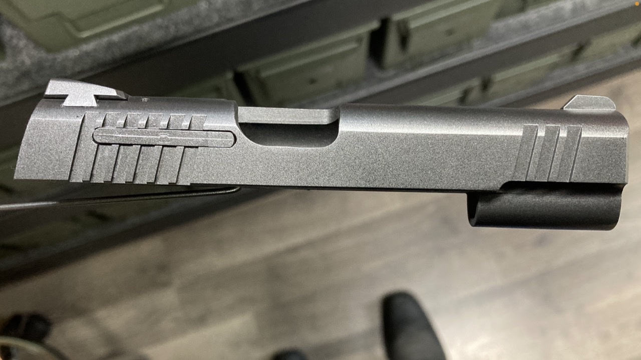

Aluminum oxide blast with an air eraser just to remove the loose and rough the surface. I wash the parts in acetone, hit it with the eraser and acetone wash again. The eraser is like $30 at harbor freight. It’s a tiny blaster like an air brush. No cabinet needed. Little jar of aluminum oxide came with mine.

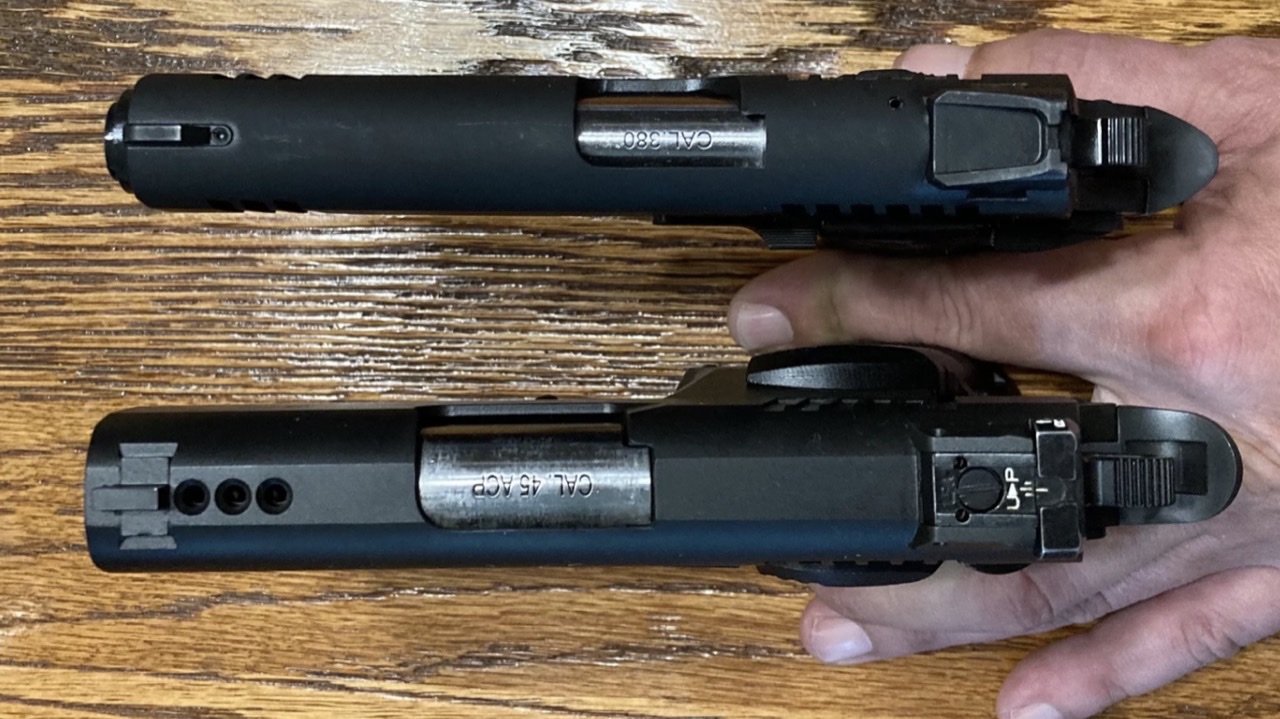

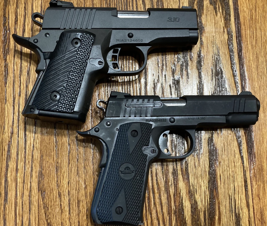

This was a baby rock 380 I did. Parkerized finish was crap out of the box. Before pics next to the RiIA BBR.
After the acetone wash

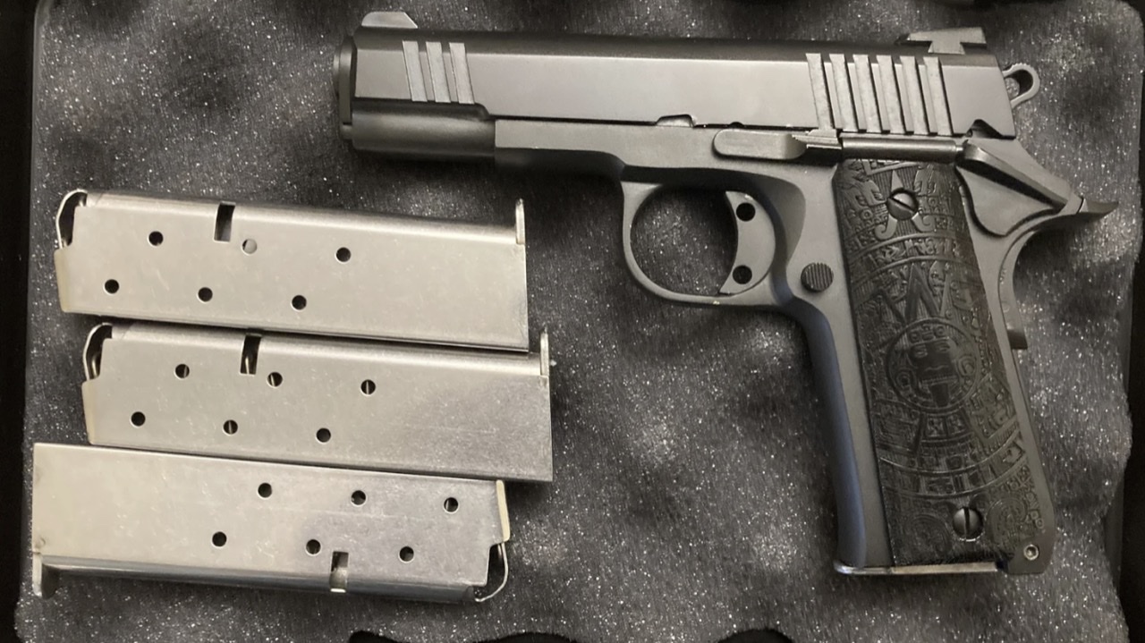

Finished product when I sold it, after several hundred rounds were put through it.
The only place it ever wore was where the slide and the frame touch. Friction wear.
