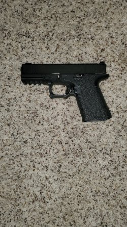

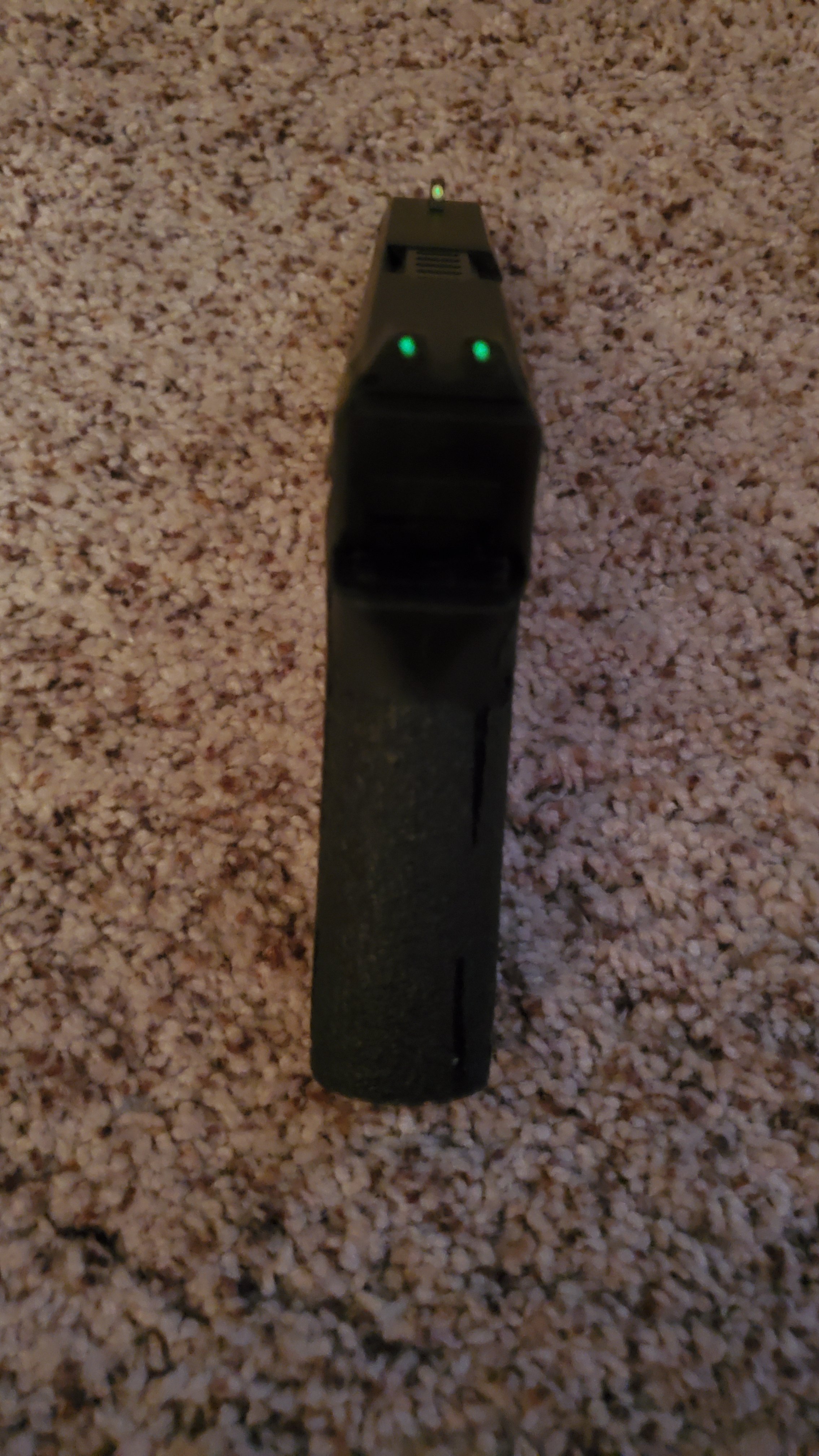

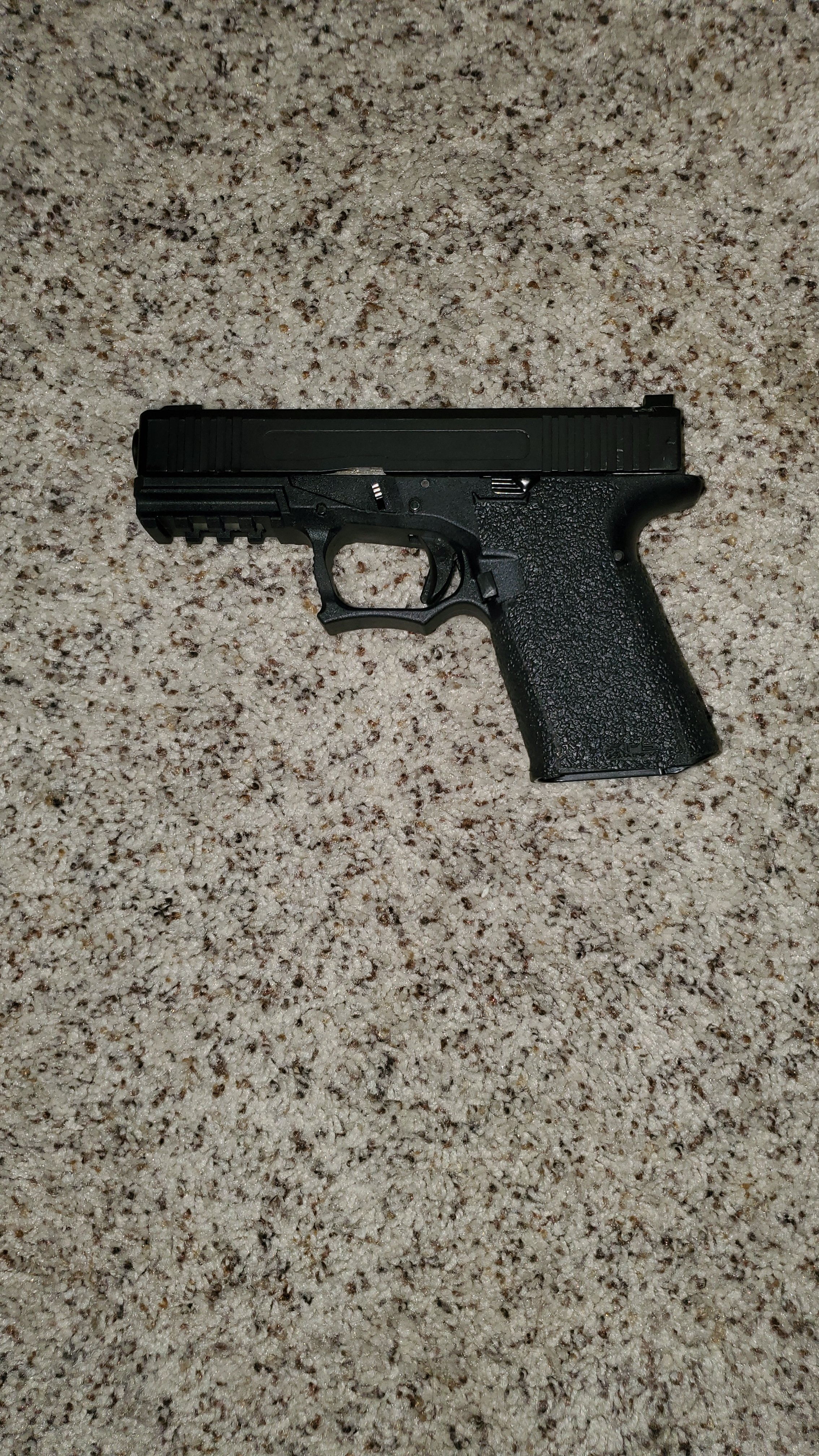

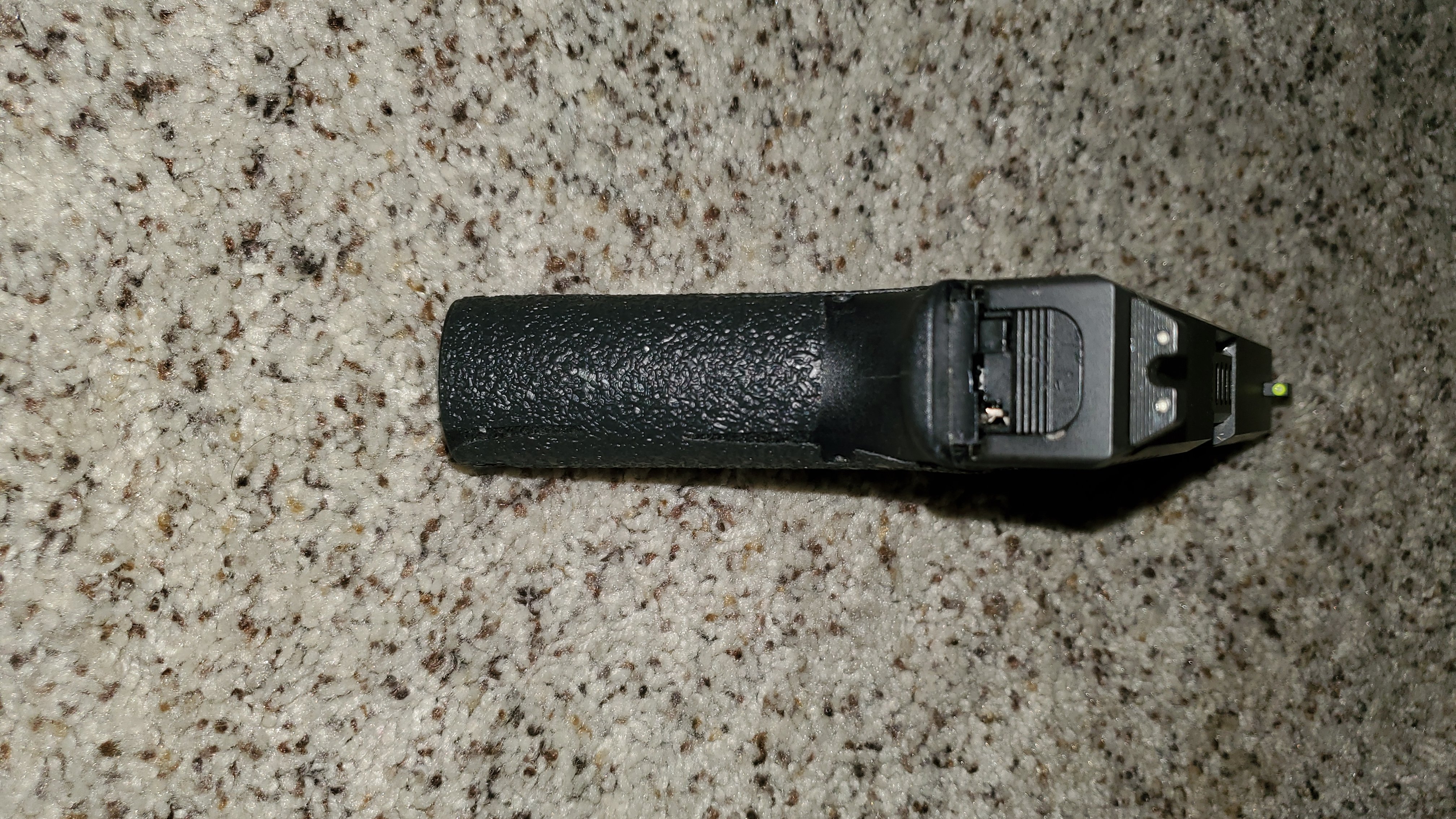

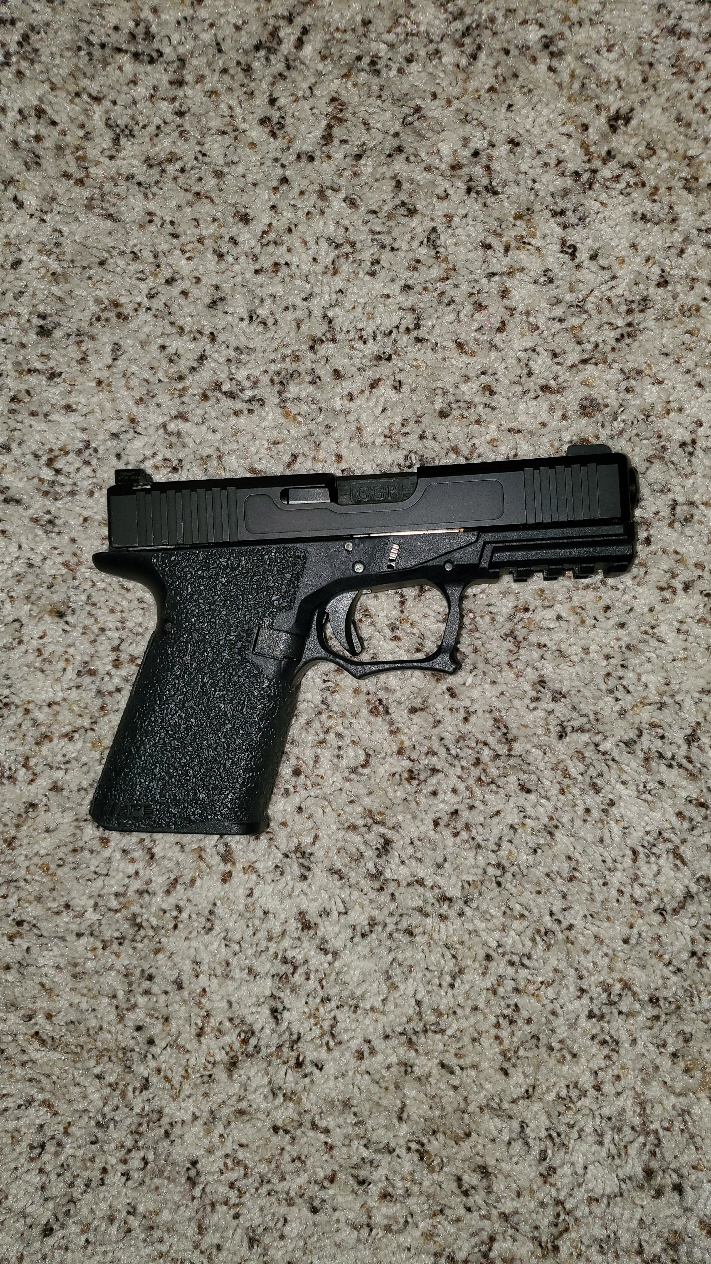

Talon grips, US Patriot Armory slide, Grey Ghost barrel, Apex failsafe extractor, Glock trigger system, Trijicon night sights. Still needs some tweaking to be more reliable. G19 Gen 3. This build just didn't like any aftermarket trigger system. So far have about 300 rounds through it.

Nice, how's it shoot?
Thank you. It shoots pretty smooth. Had a lot of FTF and stovepipes before I changed the extractor. It is accurate, at least as accurate as I can be. It is satisfying to be able to build something like this and have it actually work. Being that it is based on the Glock and is real simple, it gives you a basic understanding in how a handgun works, and you learn how to troubleshoot along the way.
…an Apex trigger sys wouldn’t work??
Nope. I tried it. Tried just the trigger, then just the connector. No go. Would only work with the stock trigger. Maybe I will give it another try at some other time. It was a hot mess with the Patmos slide and barrel that came with the kit. I finally got everything sorted out, after more money of course. My main thing is just getting this shooting and shooting consistently and reliably. Hell, who am I fooling? I WILL be trying the Apex or Pyramid. Once I get it settled in.
